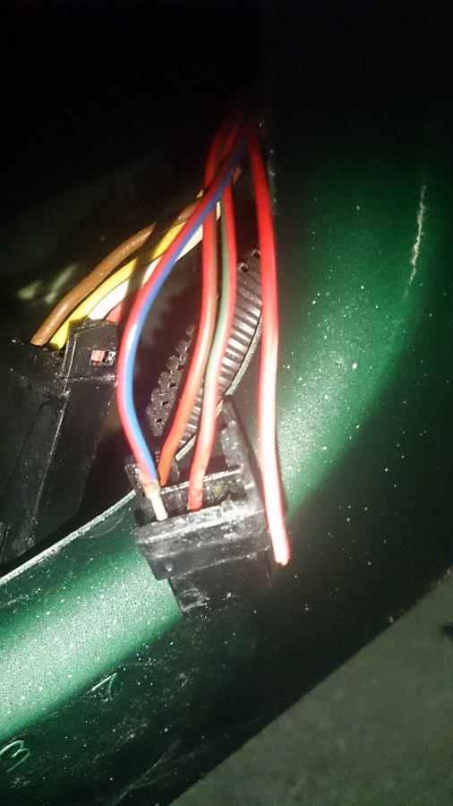

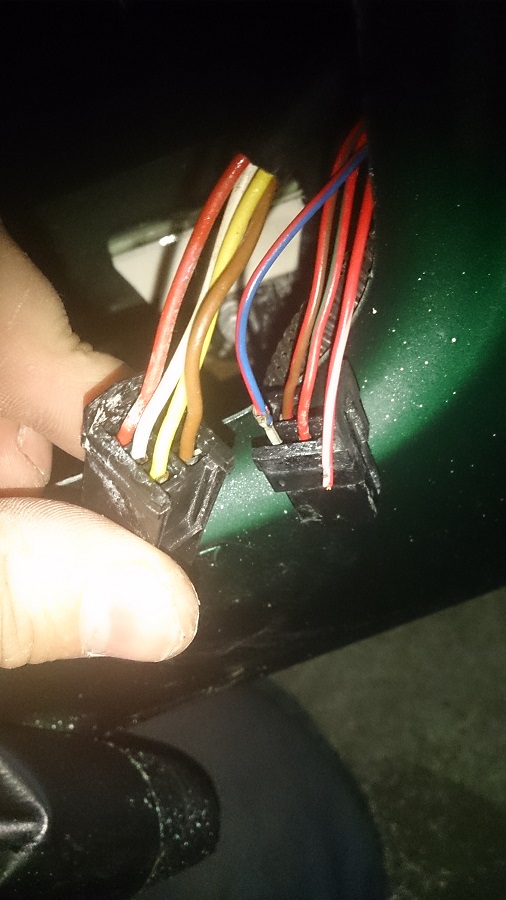

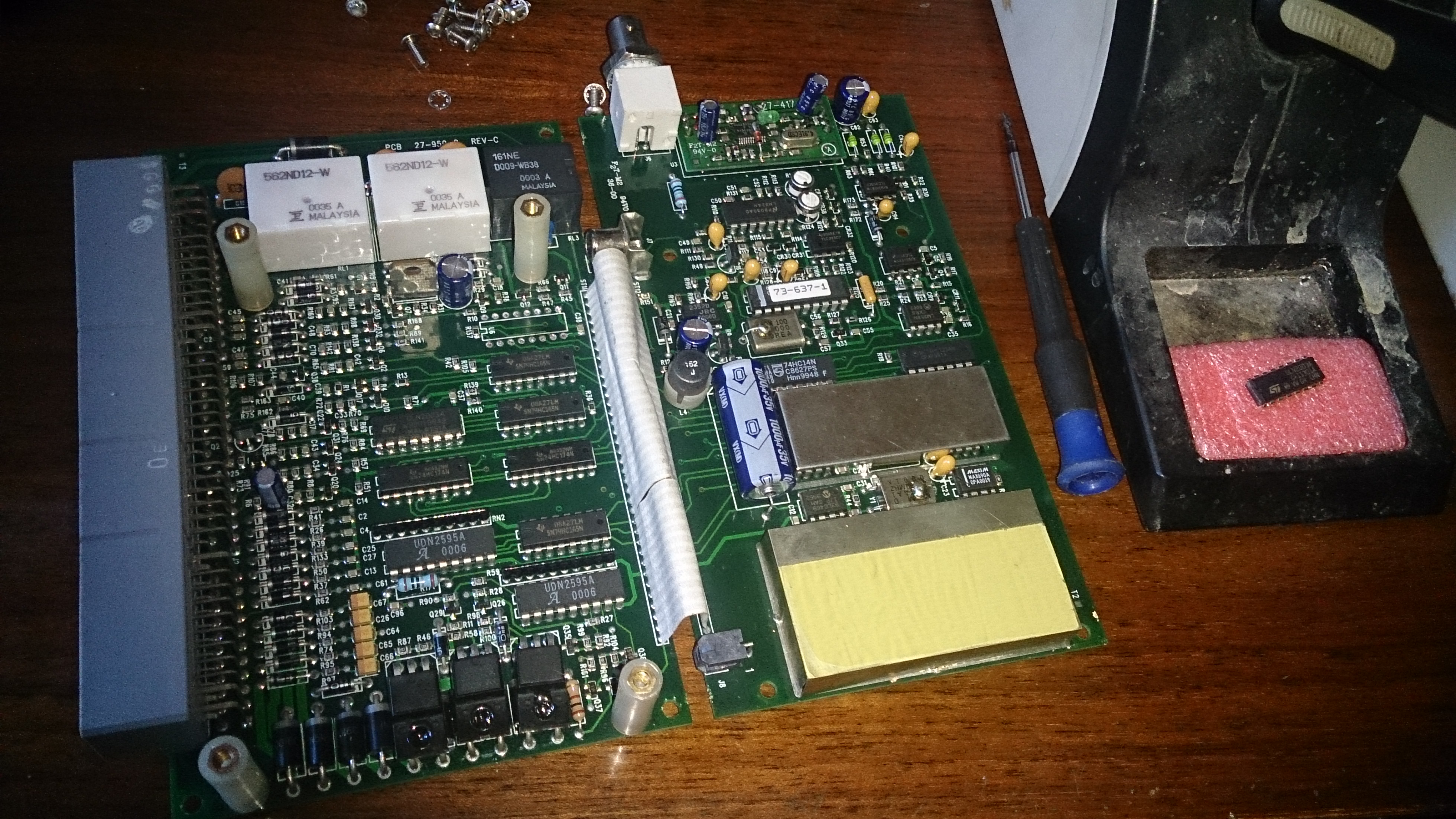

well, as always figure out by myself
first of all 4 beeps is not closed door/lid. this is common for most alarm systems.
about LED - when I take out circuit board with it - I saw soldering poing that cracked and was simply no connection - resolder it back and all good
when I disassemble passenger door, I saw oxidated closing motor plug, and door harness plug for it too. result was in non working motor and lights not turned on. decay of contacts was real hard, one wire just falls off in my hand. problem made by one who decided to use there notwatertight plug (all other plugs near are watertight). so I cut this off and use instead Tyco Superseal plugs with pins and rubber grommets.
drivers door has same problem and solution.
next thing was door locks. car have low miles but grease in locks was dry. whis caused follows: drivers door not fully unlocks by locking motor, so door button was hard to push, and door didnt open until 3-5 of pushing a button. passenger door lock opens well enough, but didnt switch lamps on. solution is to take off both locks, degrease and clean dirt from inside with brake cleaner spray, then after cleaner is dry - grease locks with universal synthetic grease spray. clik-clak lock back and forth to wash out any dirt, and then grease well. and door switch seems like will be forewer young ))) result - locks work good, lights go on and off immediately. book say that to take off lock need to take off door glass and frame - thats a lie.
and then I hear new sound. it was tic-tac from clock region but not clock itself. and inside lights blinks together with clacking sound. sound came from alarm control module. it is very hard to take off, needs to disassemble dashboard all from top, and slacken and move back center console. after this you can reach and unscrew two bolts. taken in hands - clack is from inside, disassembling is easy - found clacking relay marked D009-WB38. thought that it bad, tested, but it is good... when came to IC that clacks it - ULN2003A - Darlington transistor pairs, but is was looking good until I another time plug unit in... it smokes...
next - tomorrow, new IC is on the table, I will resolder it, and will look did it take anything else with, or all ended up easy... and will be some photos...

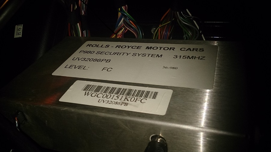

hello! can you show where is this battery? didnt find...
found in internet http://robisonservice.blogspot.ru/20...-in-1990s.html - seems like mine is new version without battery
and another one - close but also earlier http://www.rollsroyceforums.com/foru...pic.php?t=1357
______________________________________________
worse of this - dealers wont do anything says "we cant check/program alarm unit in american cars, doesnt have access". If I buy this http://www.flyingspares.com/shop/rol...z-uv32085.html do I need to code it after installation or it just plug-n-play?

Hey- great finds. Think the battery must then be in the actual (clifford?) siren unit then. They are generally in the right side (american passenger side) upper wheel well area. Very easy to do. Sorry, don't have the service manual with me so can't double check. If you replace it, car should be put on a charger and key turned to start (not running needed though) and allowed to sit for some ridiculous amount of time... 6 hours I think so the battery can charge up. Alternatively, go for a long drive!
Regarding reprogramming, if it's a dealer, they have the scan tool and should be able to check the unit etc. It's the same scan tool world wide. Not sure what their deal is, but I don't know 100% what is required when replacing the ECU. I think it's just plug and play (ie no programming is REQUIRED-- that's why it comes with a key fob), but without a scan tool you won't be able to customize any settings and there are some that really should be changed if you're going to use the car!
Also, flyingspares is great, so asking them may be very helpful.

first - resoldering uln2003a gives nothing. all become as earlier but now no interior light, and instead of it blinkers lit up constantly and dim once a second, relay still clicks, and plus rear lock always do work. so - something burn out together with this IC. I will continue to repair...

There are two components- remote access/alarm (ie the box from flying spares) and the immobilizer. The immobilizer is linked to a chip in the key and ecu and that must be programmed using a j2534 pass-through tool with a connection to Bentley's website to get the programming. The immobilizer needs to be factory coded for the vehicle. This does not sound like your problem given the car starts. See this for the tool: http://www.flyingspares.com/shop/rol...l-wt10240.html
The alarm/remote access component is what you posted a link to previously. These commonly go bad as evidenced by the fact that refurbished replacements are readily available. The service manual describes them as plug and play. It is important however to use the omitec scan tool to properly set up the customer options as there are some seriously annoying ones set as the default generally (maybe the refurbished ones are more helpfully set by default!). These come in two frequencies: 315 mhz (US) 433 mhz (row).

repair goes slow way... found some diodes are dead, and one transistor...

I repaired this unit but still need to reprogram it... will go to dealer.
