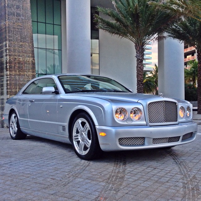

Hey guys,
Just took delivery of my 2009 Brooklands this past weekend.
I noticed the rotors and pads need to be changed within the next few months.
Dealer trying to charge almost 4k.
I know I can find the parts maybe a little cheaper.
Does anyone recommend an online store to purchase Bentley brake parts?
I went on FlyingSpare already.
Thank you for your time and help, Alex
