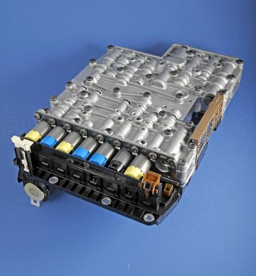

My GT is in with the Indie at present for a couple of jobs.
One of the faults is that the paddle shift became intermittent.
My Indie has checked everything, including running jump wires from the paddle shift to the gearbox to eliminate a broken wire being the cause.
It turns out that the Mechatronic unit within the gearbox had failed. They look like this;
The rub is that they are £1,800 from Bentley, plus £1,800 refundable deposit on return of the old unit.
There is a company in Sussex that supply recon' units for £925 with a £250 deposit, but they can't guarantee to have one before I go over to France in a week or so. Can't delay the visit either or I would wait.
Catch 22 then. I am once again a victim of Bentley prices.
They are easy to replace and I was having a trans' fluid change anyway, but to fail at around 60K miles is a bit of a joke.
Being optimistic, I have to think that there can't be much else to go wrong!

Well, all done and running as it should now. That and a couple of driveshaft gaiters set me back £3,405. Ouch!
I should have kept the Jag XJR, maybe.
I did ask my Indie if he had changed the Mechatronic units before and he stated that he had done a few. Maybe not so bullet proof Ulstrup.
Still, I'm happy that it works now so no worries.
Les.

As for the gearbox. The fault with the Mechatronic unit displayed no symptoms apart from an intermittent paddle shift failure.
My Indie did say that a few cars had the same fault but the owners simply didn't bother getting it fixed and just accepted not having paddle shift as the gearbox worked fine otherwise.

The Mechatronic unit goes back as an exchange unit, so you would never find out what was wrong with it. It's full of solenoids and electrics and is a fairly common problem on BMW's too as I have found out via their forum.
