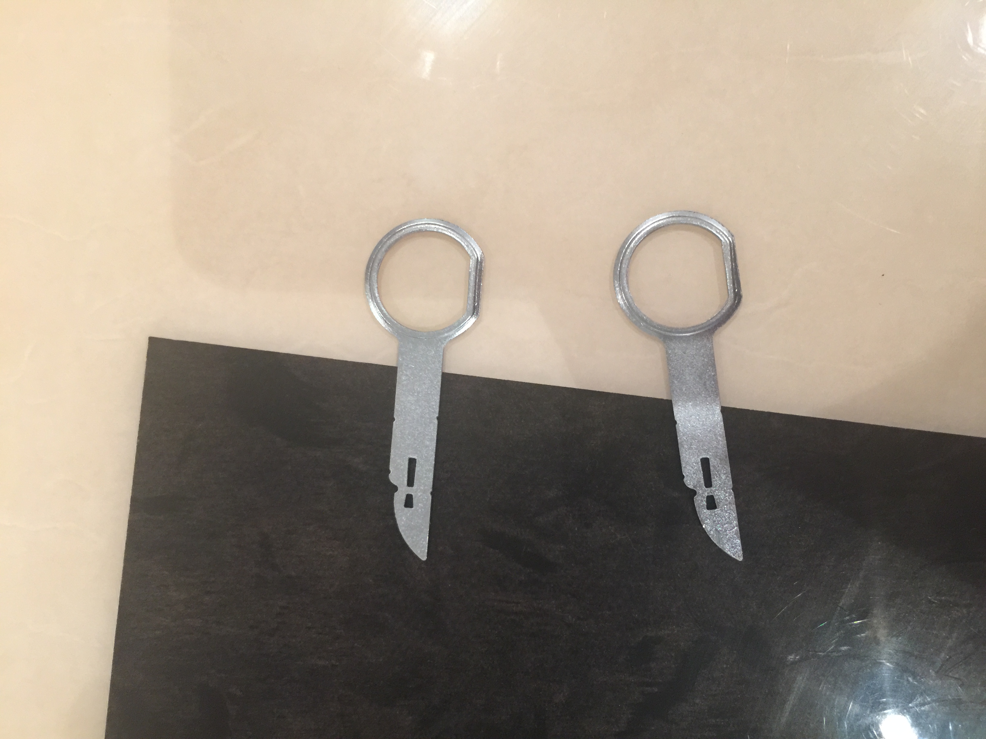

I had also ordered the radio removal keys from amazon which arrived today. I spent 10 minutes trying to remove the CD changer without any luck. Maybe I bought the wrong keys or just not sure how to use them?
The keys I bought are the VW/AUDI keys. I'v attached a photo of them and I will have another try once the DICE unit arrives.

regarding the keys they are the correct keys. i was expecting them to lock into place so you pull the cd changer out via the keys but that was not the case.
i just had to insert them and just push firmly into place, then get under the dash and put your fingers through the vent holes and give the back of the cd changer a shove from behind and it will pop free.

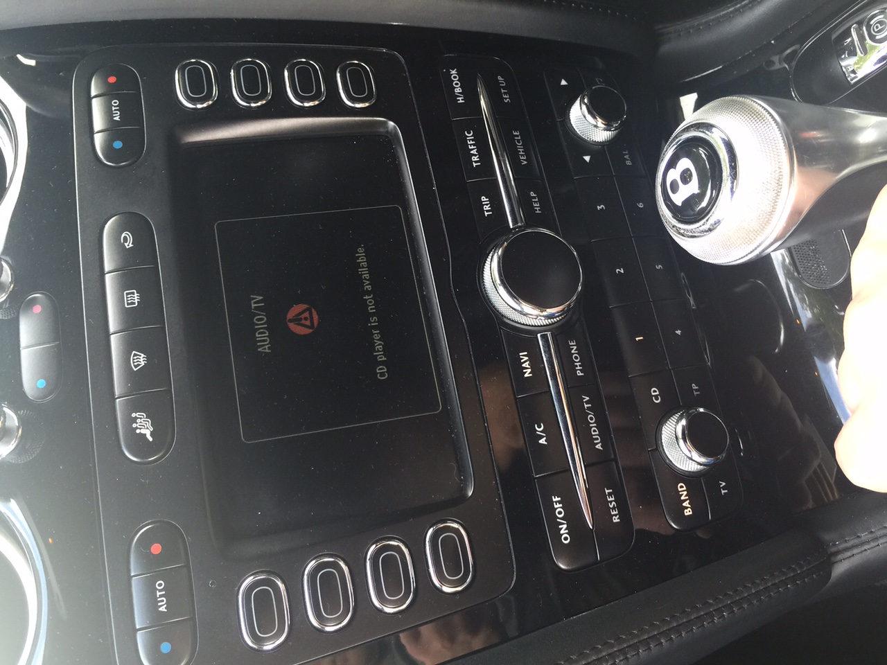

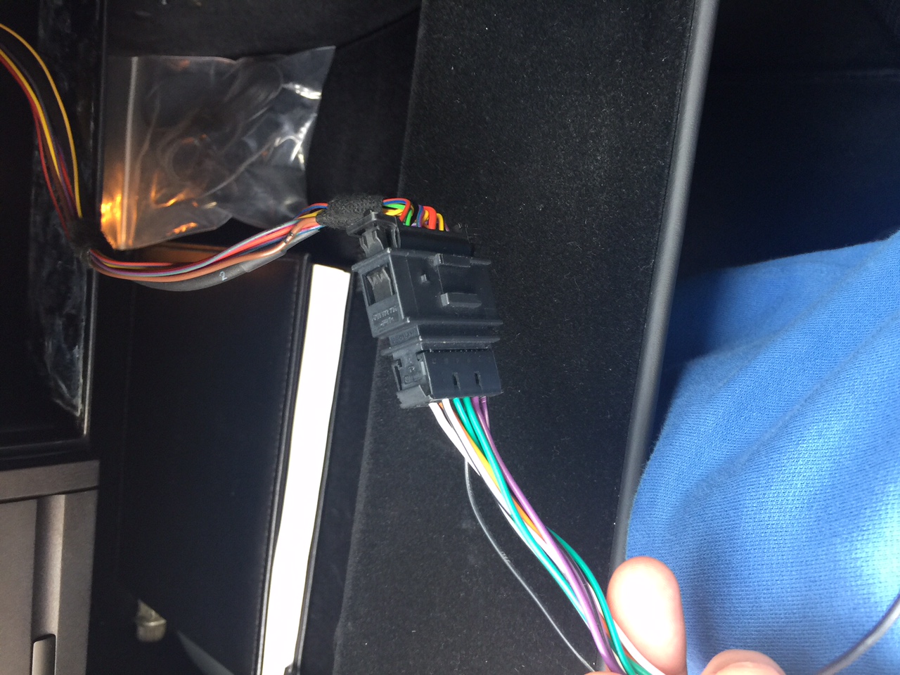

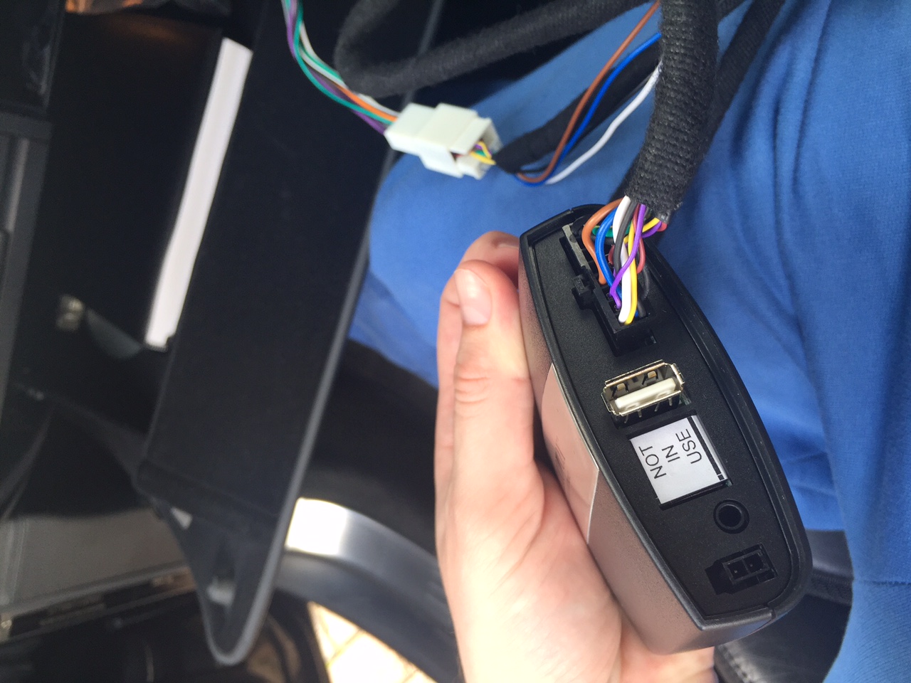

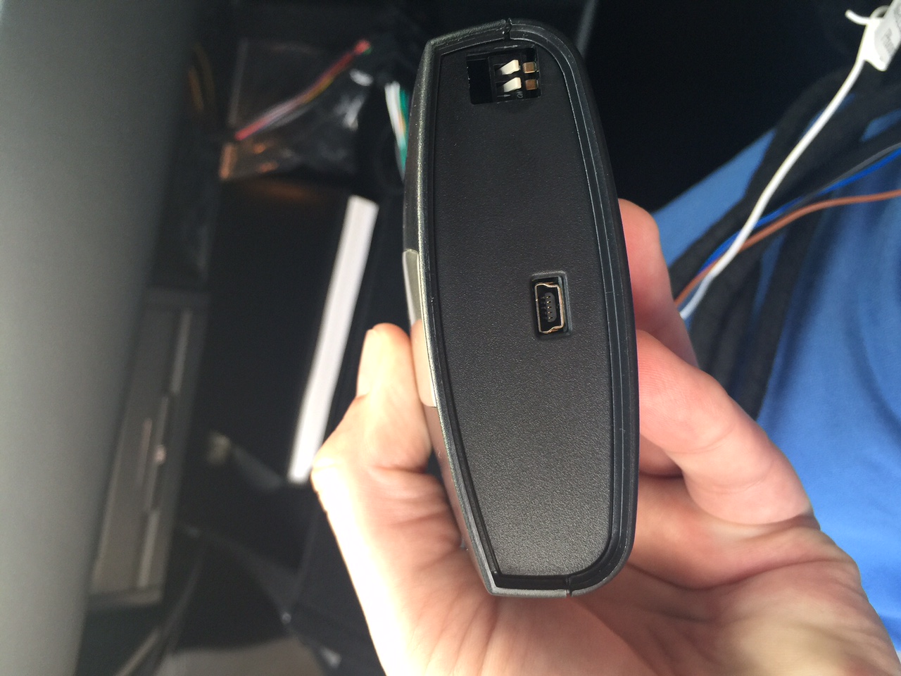

Hi Guys
Iv got around to installing my media bridge today, I have connected it up to the CDC cable in the glove box but when I press the CD button on the head unit it says CD is not available.
Does anyone know what DIP settings need to be set for the Bentley GT?
I have also tried searching for the media bridge over blue tooth but it doesn’t find anything?
am i missing something? does it require some separate power ?

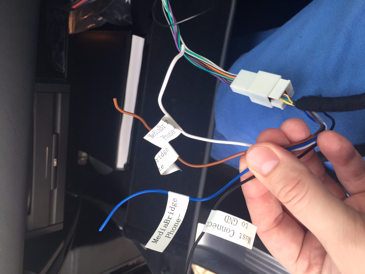

Hi guys
finally cracked it, on the CDC side there was 1 single loose black wire going no where, and on the media bridge side had a black wire saying "must connect to GND" seems autotoys had forgotton to wire them into the connector so i wired them in my self and powered the unit up again and now its detecting in the car.
Still couldnt get my phone to pick it up on bluetooth but later discovered you need to power on the mediabridge then press track right twice within 5 seconds to enable bluetooth discovery mode.
The unit now does the job I wanted it for, although the user interface of the media bridge has a lot to be desired.
Bluetooth streaming audio is bit crappy has a funny echo played around with the DSP for a couple of minutes to no avail, switched to ipod cable and its nice and clear. at least I have a new toy to play with over the weekend.
Steven Iv seen your thread regarding disabling MAT on here some where so will have a go at configuring the unit better at the weekend.
all's well that ends well.
PS: DIP switch (Off - Off) - default settings work fine, thanks steven
