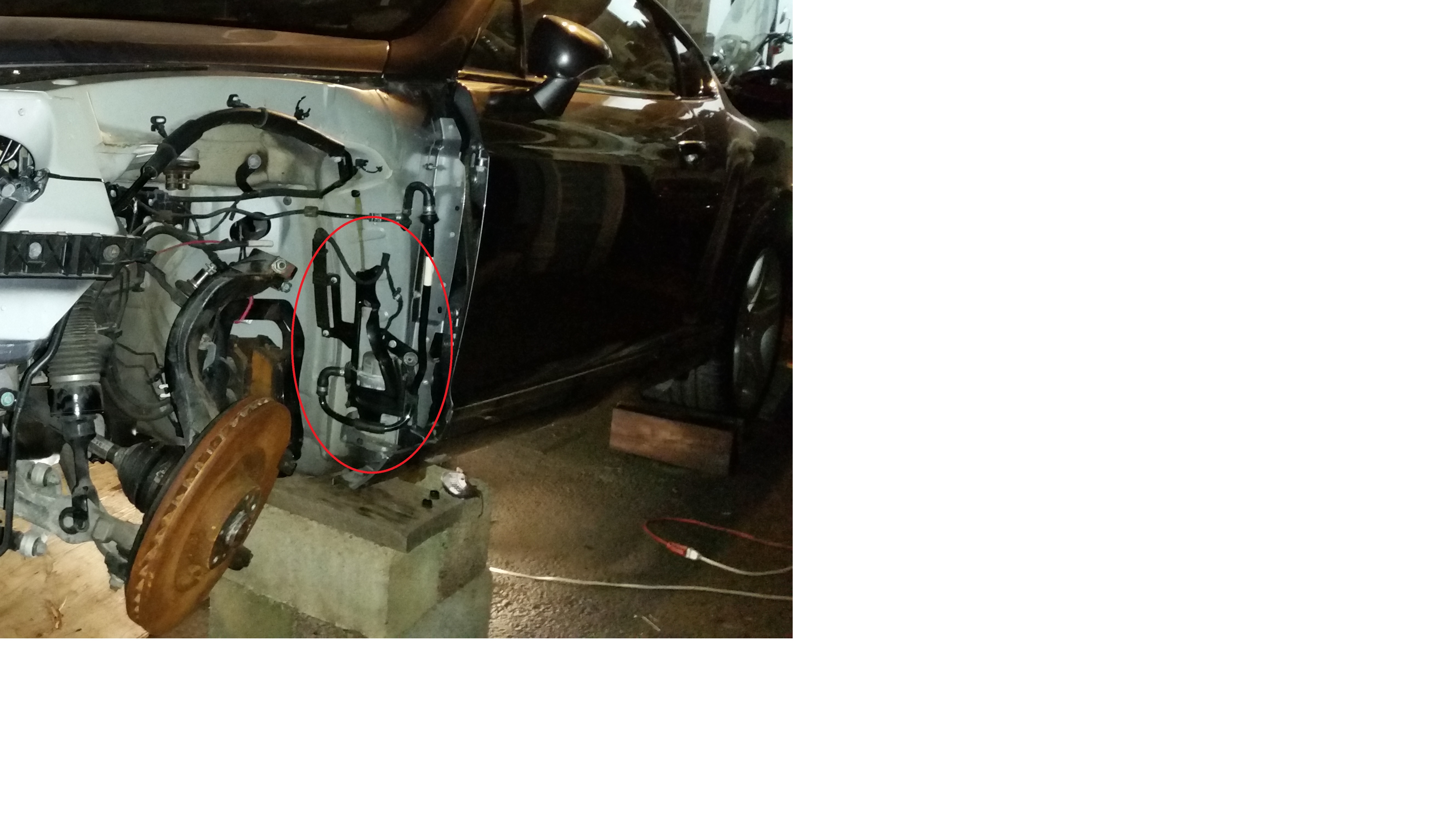

When i pressed on the brakes i didnt hear anything turn on. I checked the fuses inside the car under the steering wheel and the 15 amp vacuum pump fuse which is number 7 is blown. I replaced it and it keeps going out. What could be causing the fuse to go? And where exactly is that pump? Thanks for all your help by the way!
It's shown in the second video that I posted, below the blue 3 chamber vacuum reservoir in the drivers side wheel well.
Johnny J J
