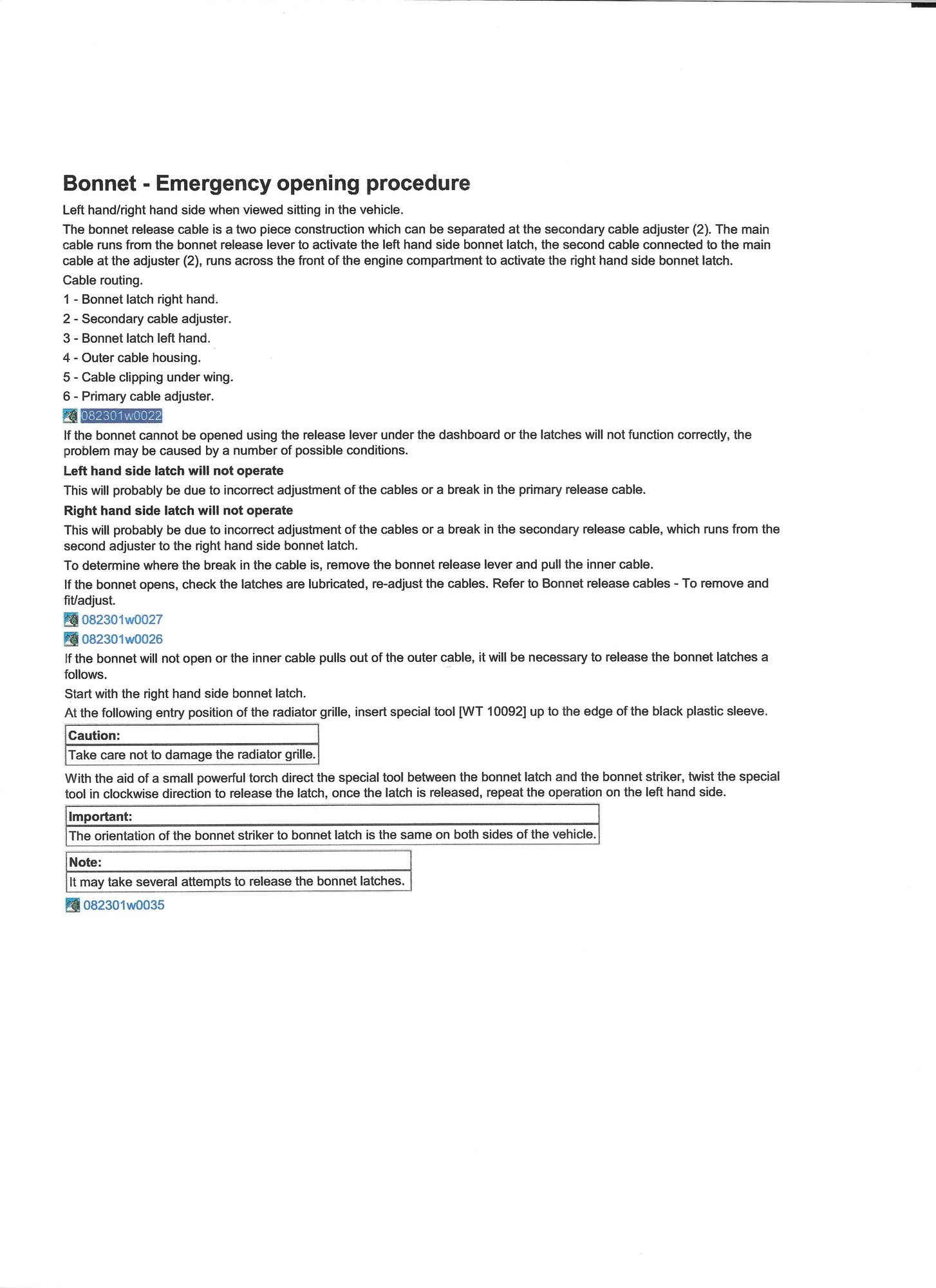

FOR NEXT TIME.
Old May 29, 2016 | 02:29 AM
ExSF's Avatar
Joined: Sep 2013
Posts: 649
From: Europe
Rep Power: 43
ExSF is a name known to allExSF is a name known to allExSF is a name known to allExSF is a name known to allExSF is a name known to allExSF is a name known to all
Special tool. A bent plainblade screwdriver then.
Thanks for the info' joc44.
