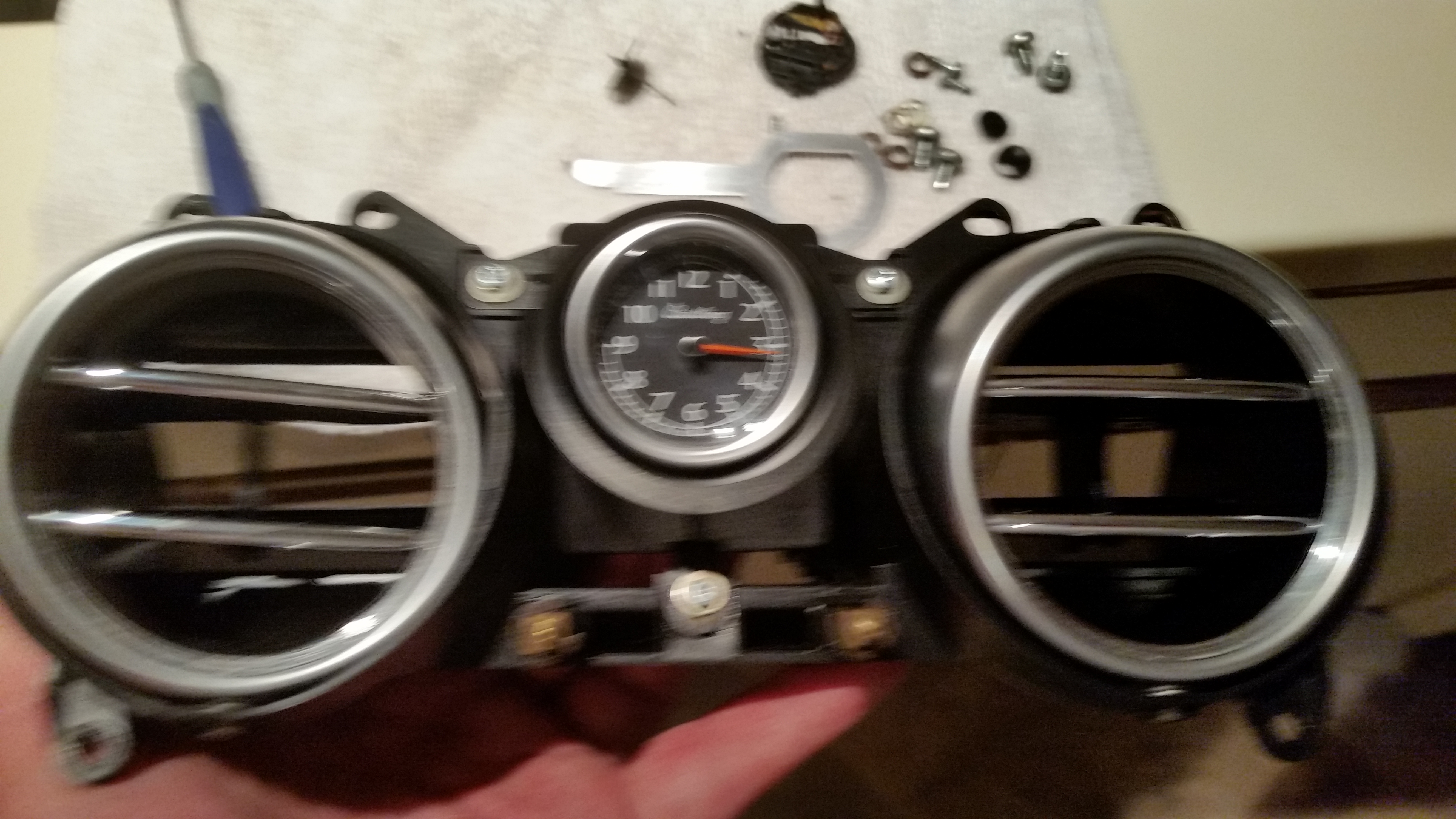

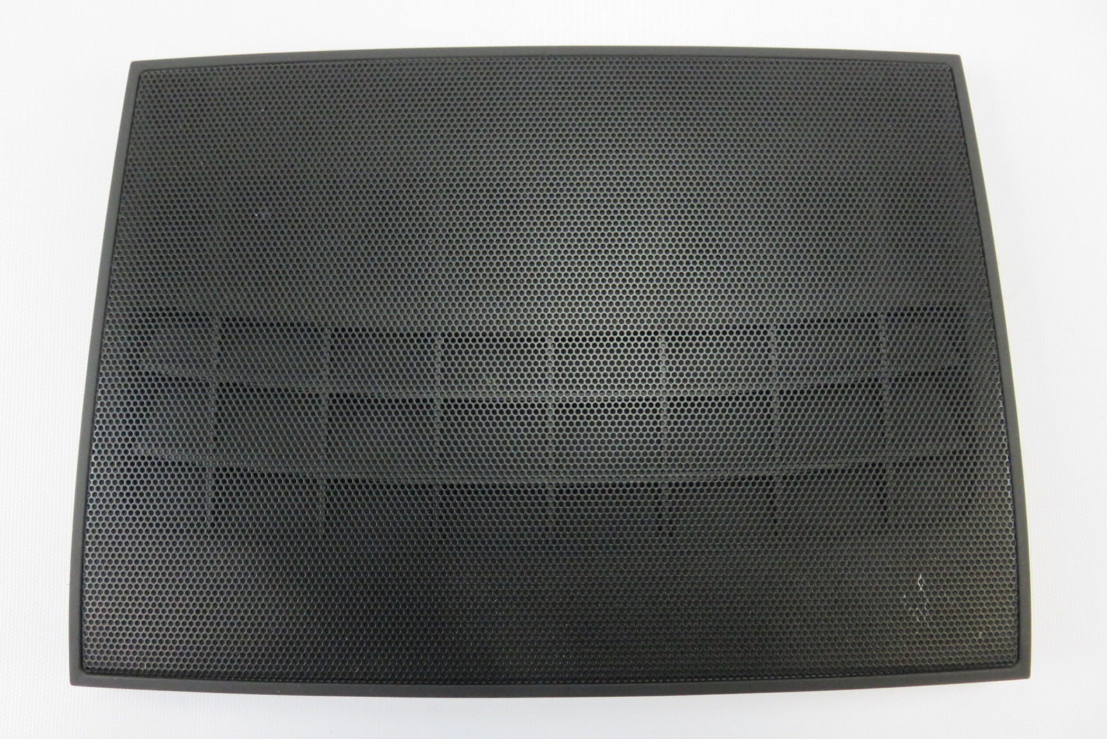

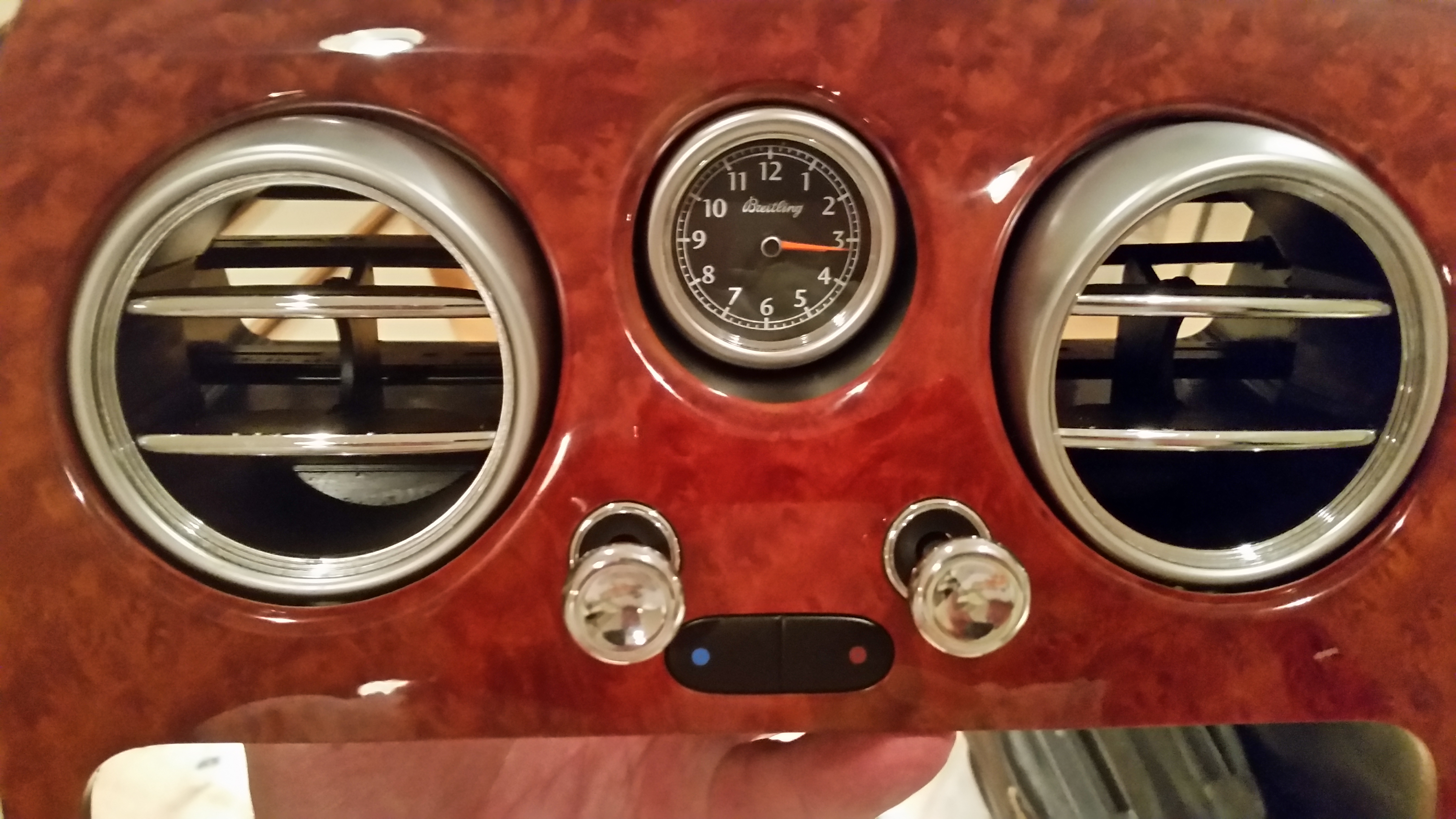

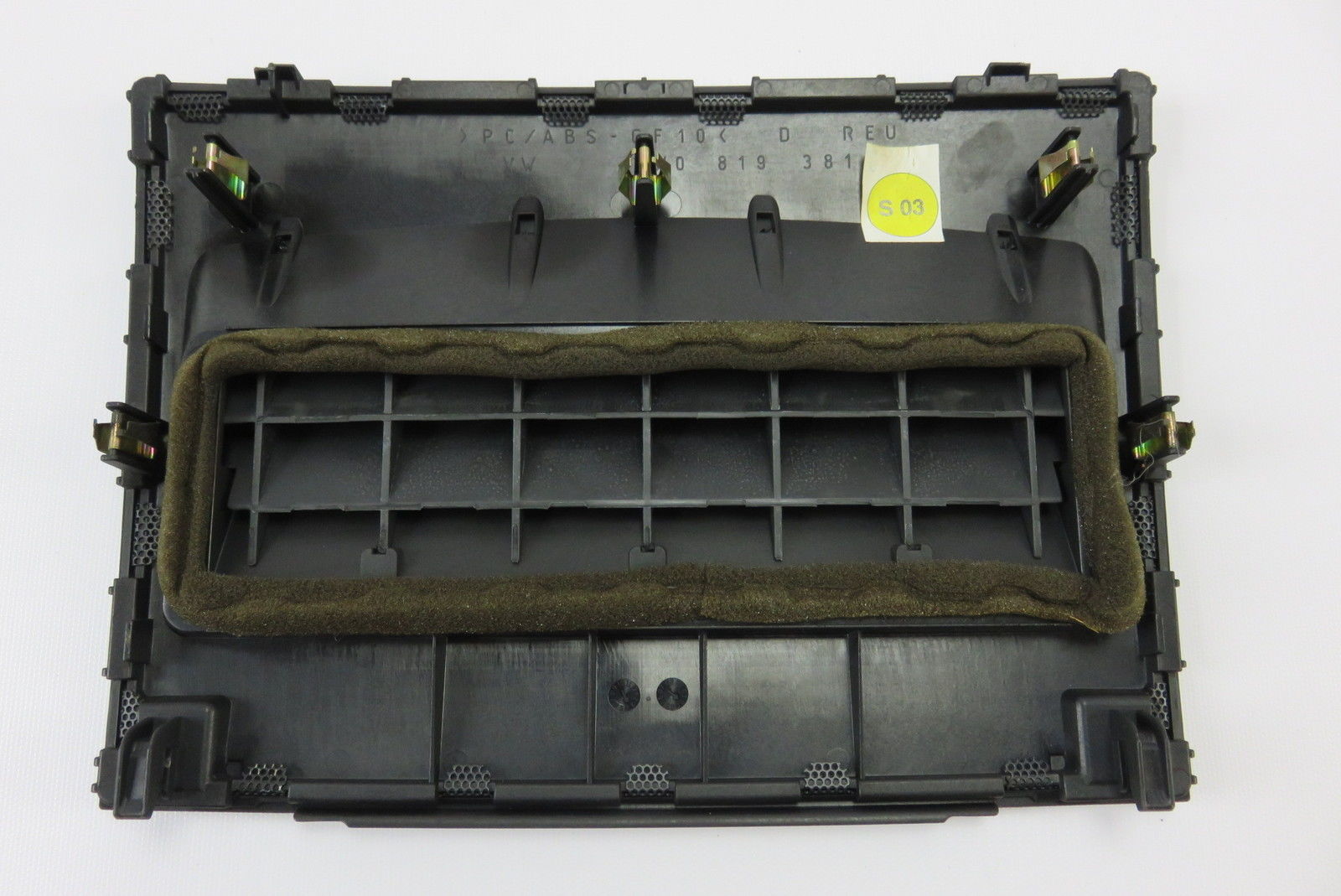

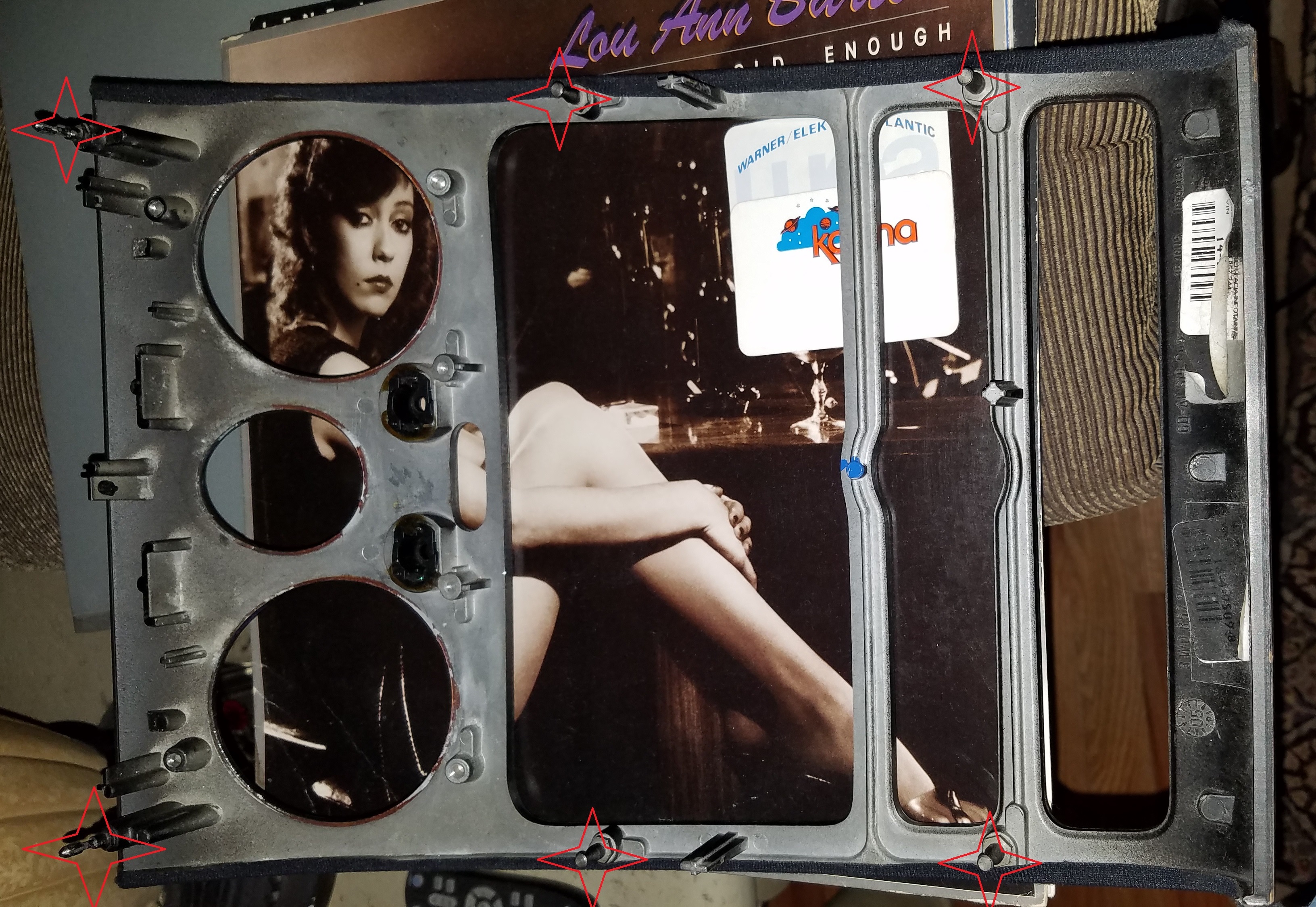

Anyhow, it just pops off, the vents and clock come off with it, it is anchored in six locations as shown in picture.
It may be easier to remove the black center vent on top of the dash first, then you have some thing to grab to remove the wood trim.

Use plastic tools to remove dash top vent and wood trim, if you do not have them use two credit cards and a very small flathead between the CC's, remove the top vent first, then very and I mean very gently pull the top of the wood trim just enough to feel loose, then work your way down, I use one hand to pull, and the other hand to stop my right hand from going to far......
