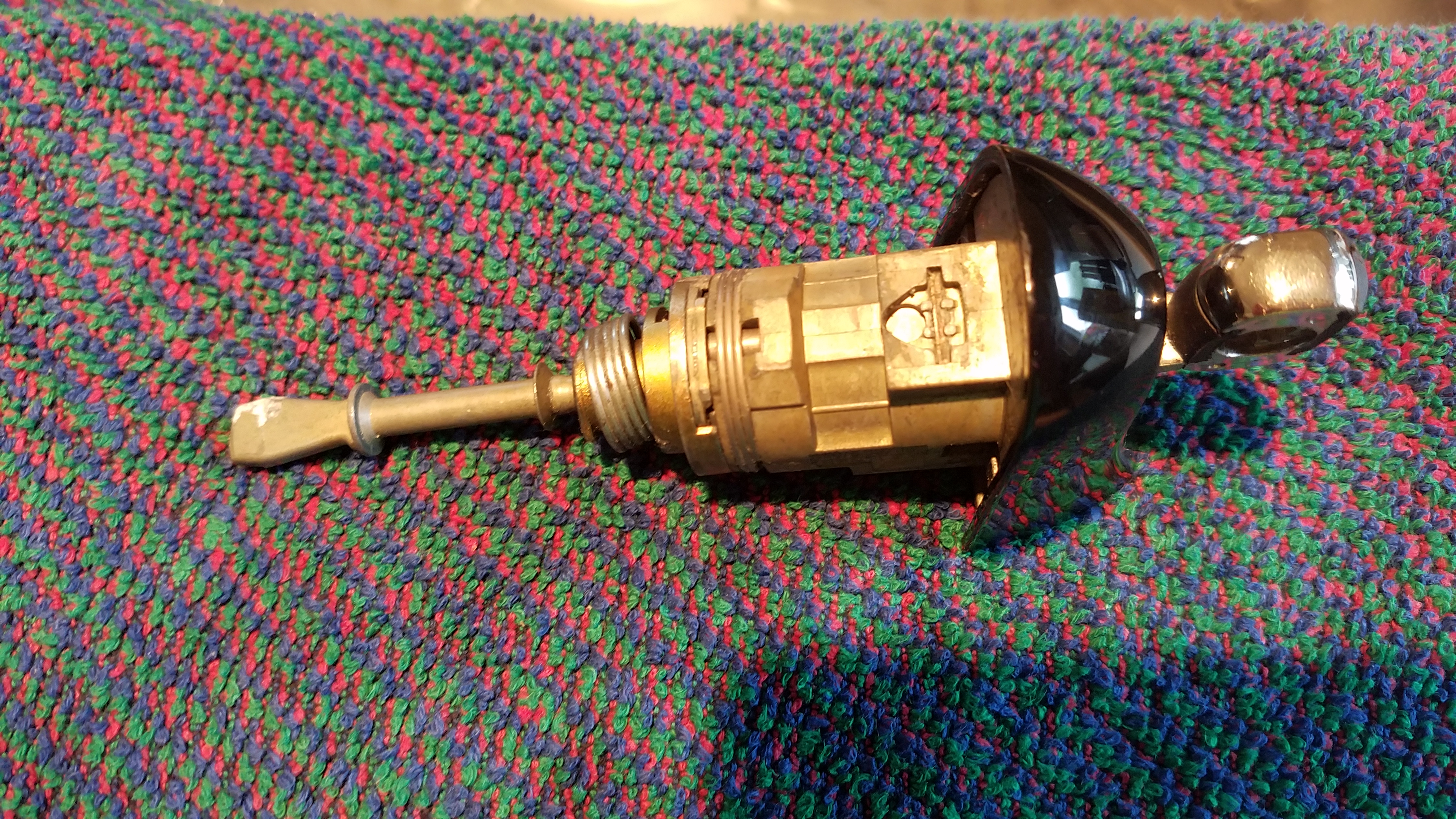

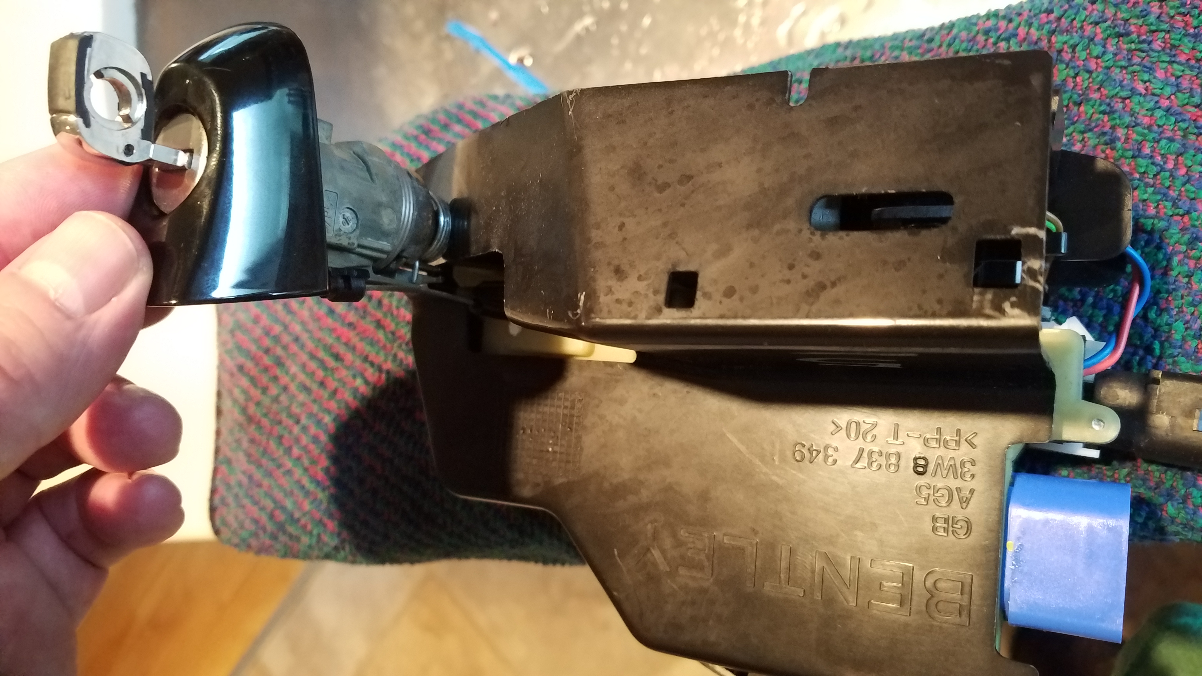

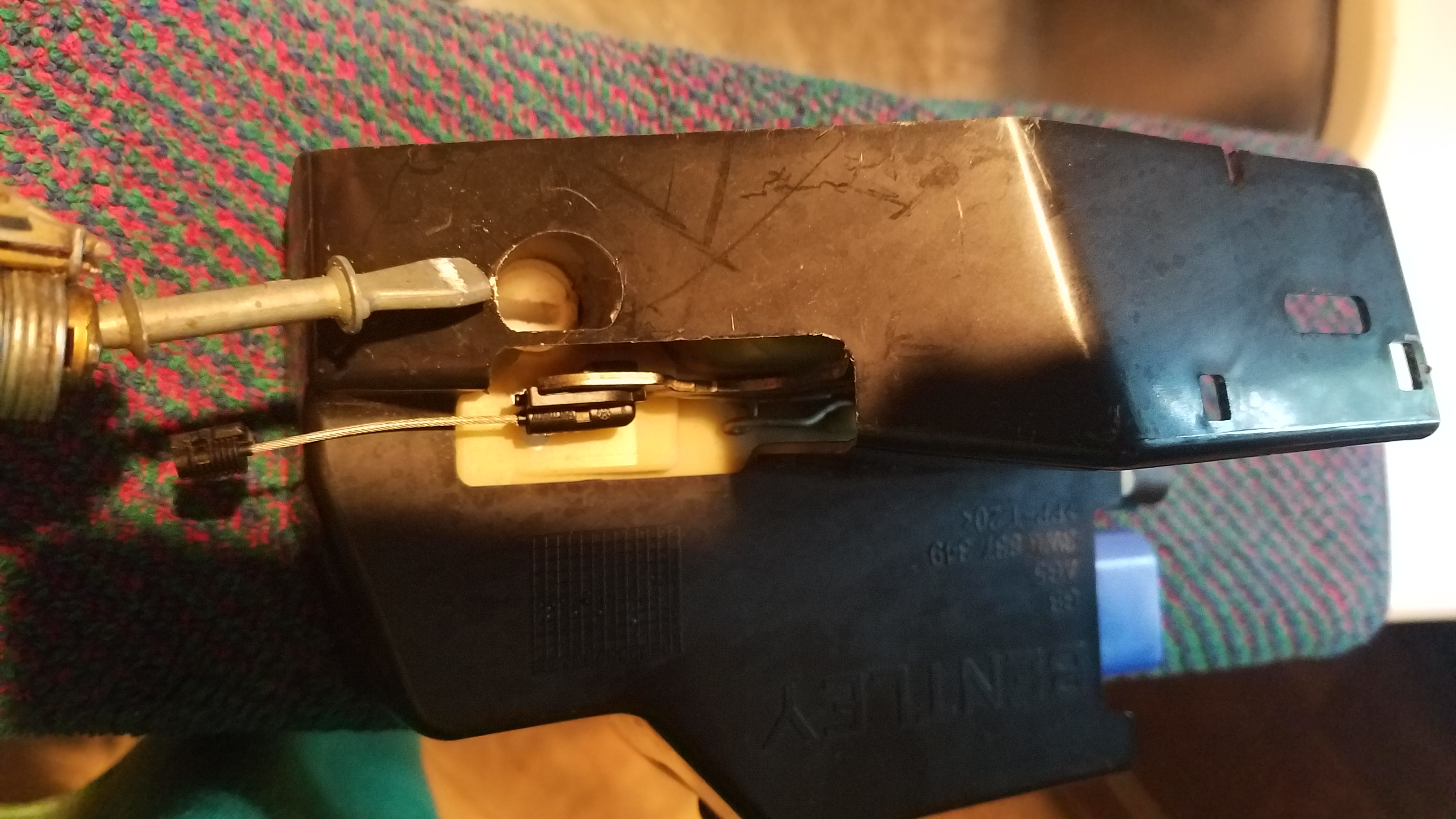

Hello Jim,
I am sorry to tell you this, but you are 100% wrong, and your dealer is correct, the key is 100% manual, you either have something wrong with your lock cylinder or broken door latch mechanism, or it could simply be that you did not turn the key far enough counter clockwise to the 9:00 position, not 10:00 or 9:30, but flat at 9:00, you should feel the resistance of the mechanism, 9:00 to unlock, 3:00 to lock, I have my GT with no batteries in it at all right now and the lock works perfect no electric needed as it is manual, this is the same setup I have worked on in 05,06 and 07 GT's, see my picture for the flat blade from lock cylinder that inserts into latch and lock mechanism.
ID:	454909   Click image for larger version
ID:	454910   Click image for larger version
