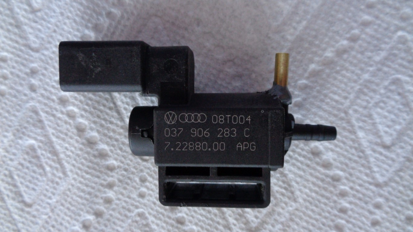

As previously mentioned I broke the small plastic tube off the sensor I was removing from the front of the engine in step #7. Attached photos show how I repaired the sensor with a piece of brass tubing JB Welded on to it. Works fine and is stronger than the original plastic tube. I had to cut the clamp off the tapered hose to get the small piece of plastic tube out that broke off. I used a spring clamp as a replacement. Its a very small hose and clamp.

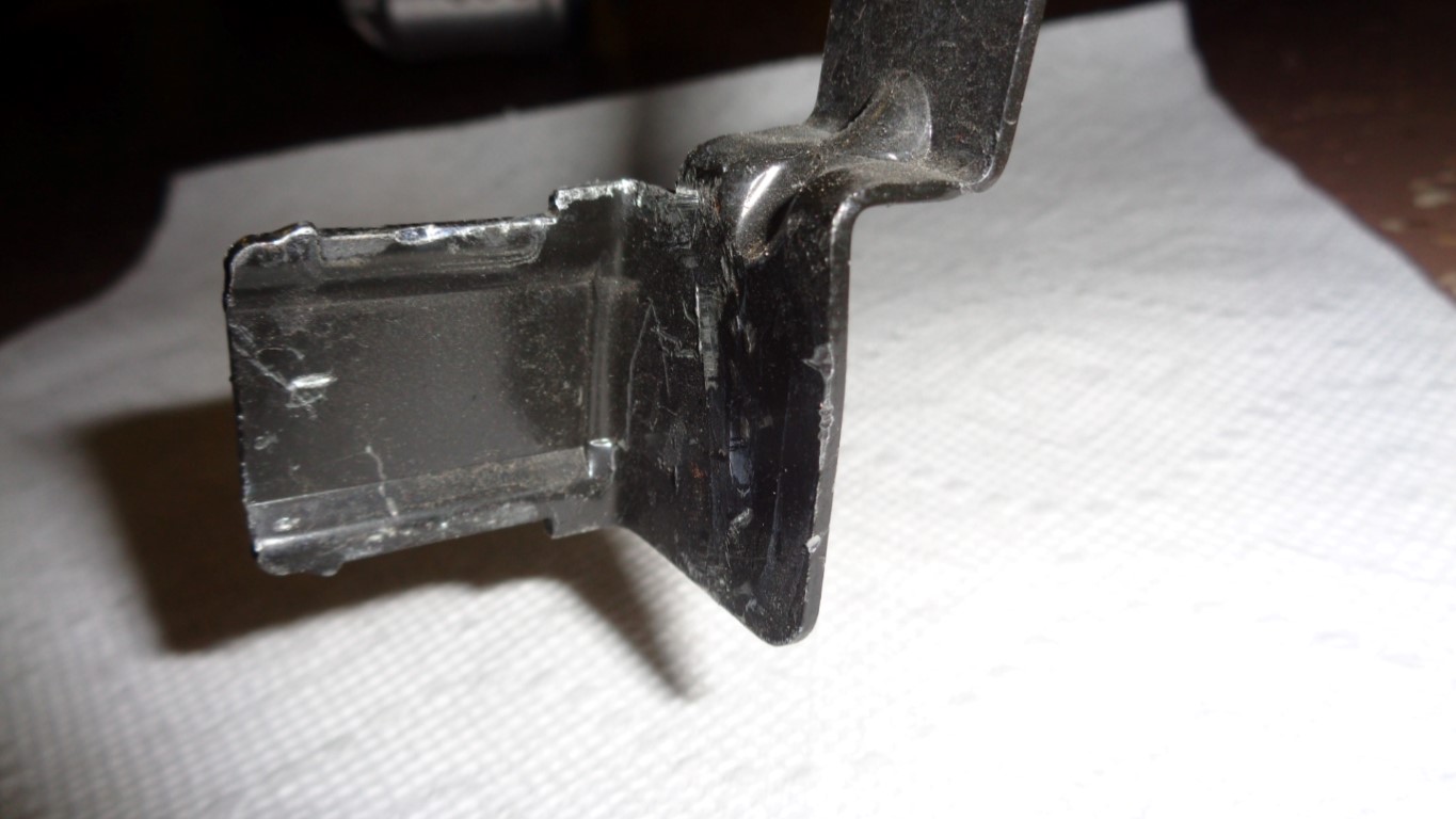

If I had to remove that sensor again I'd file or grind off the two "****" near the outer edge of the bracket that make it difficult for that sensor to slide off. (see photo of bracket)

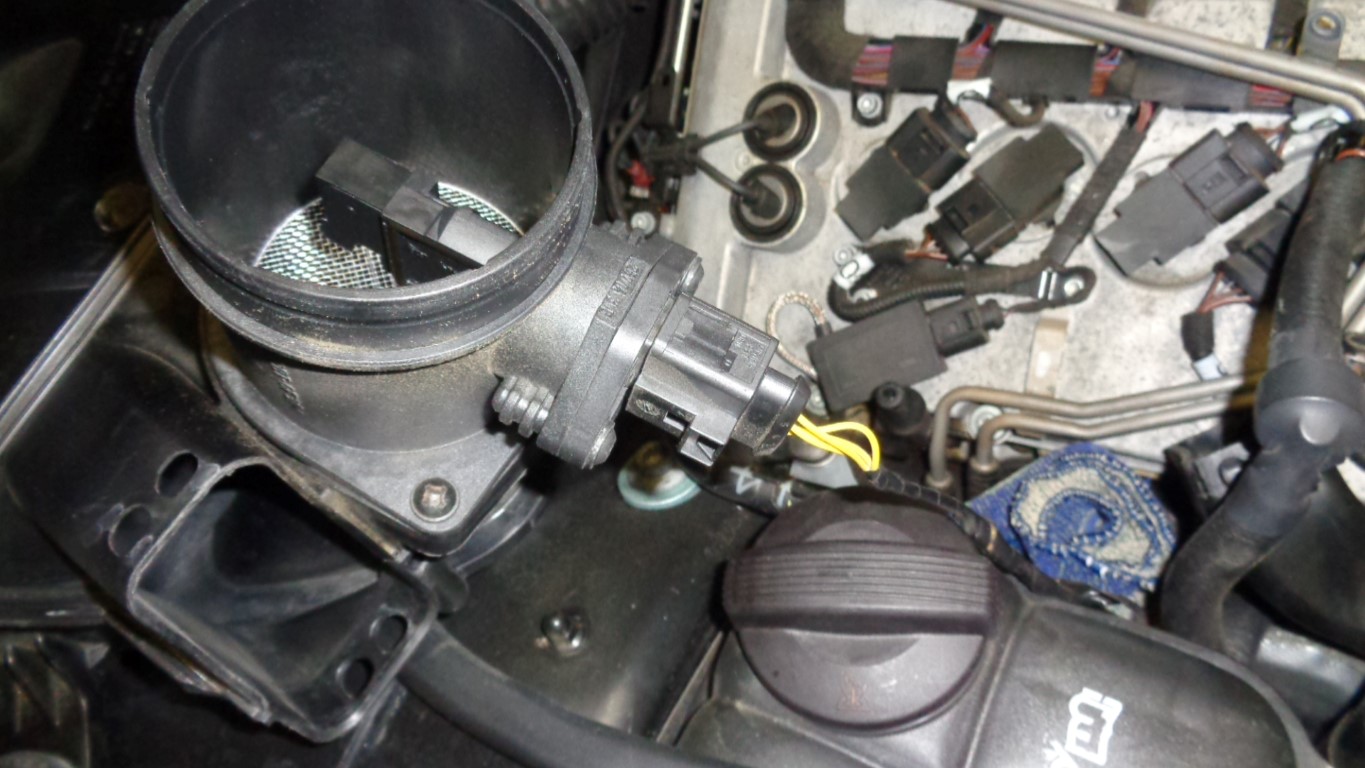

Since I was having difficulty unplugging wire connectors I chose to leave the wires connected to both MAFs. I just flipped the air cleaner boxes over and set them on the cowl. (see photo)

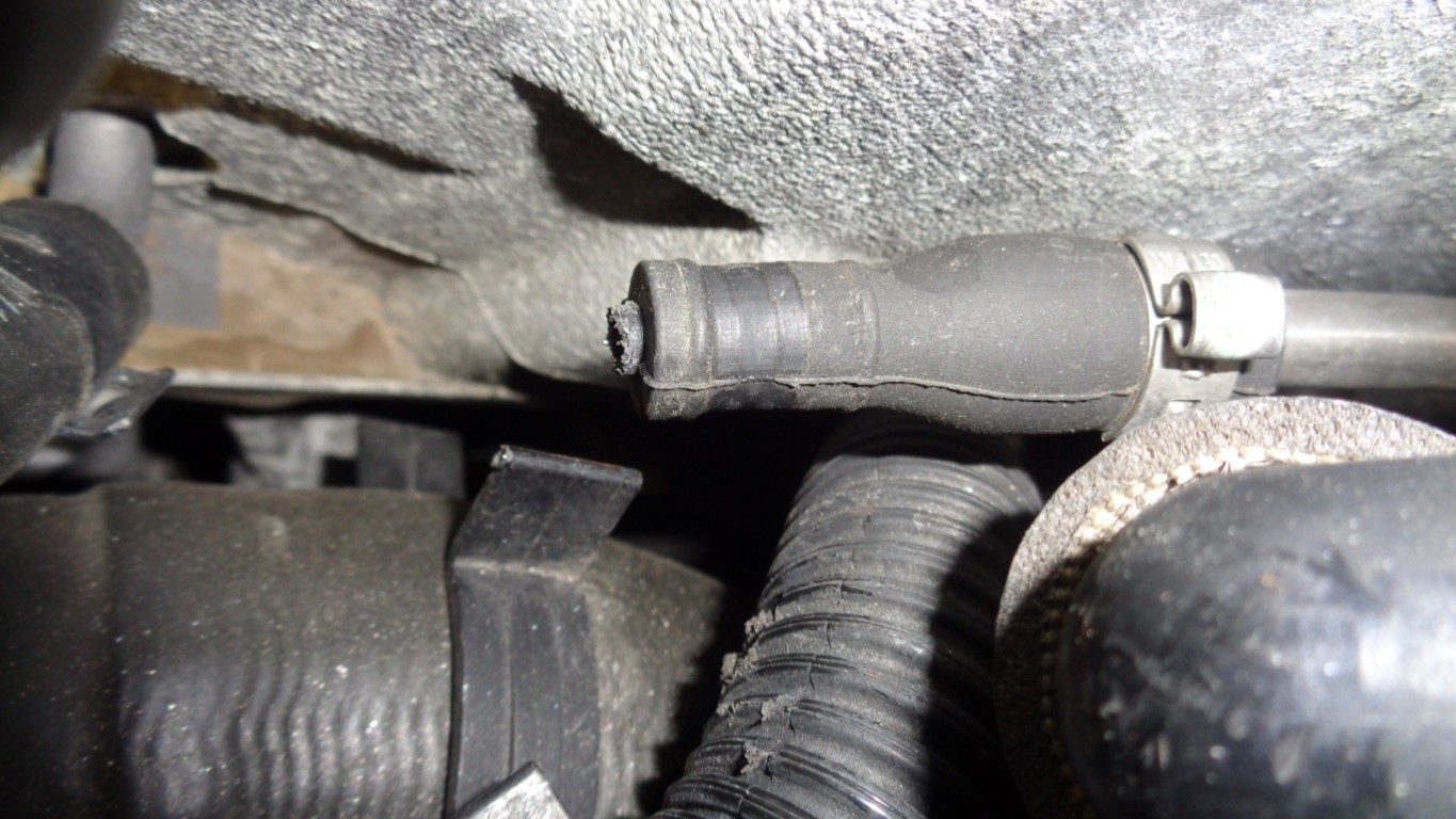

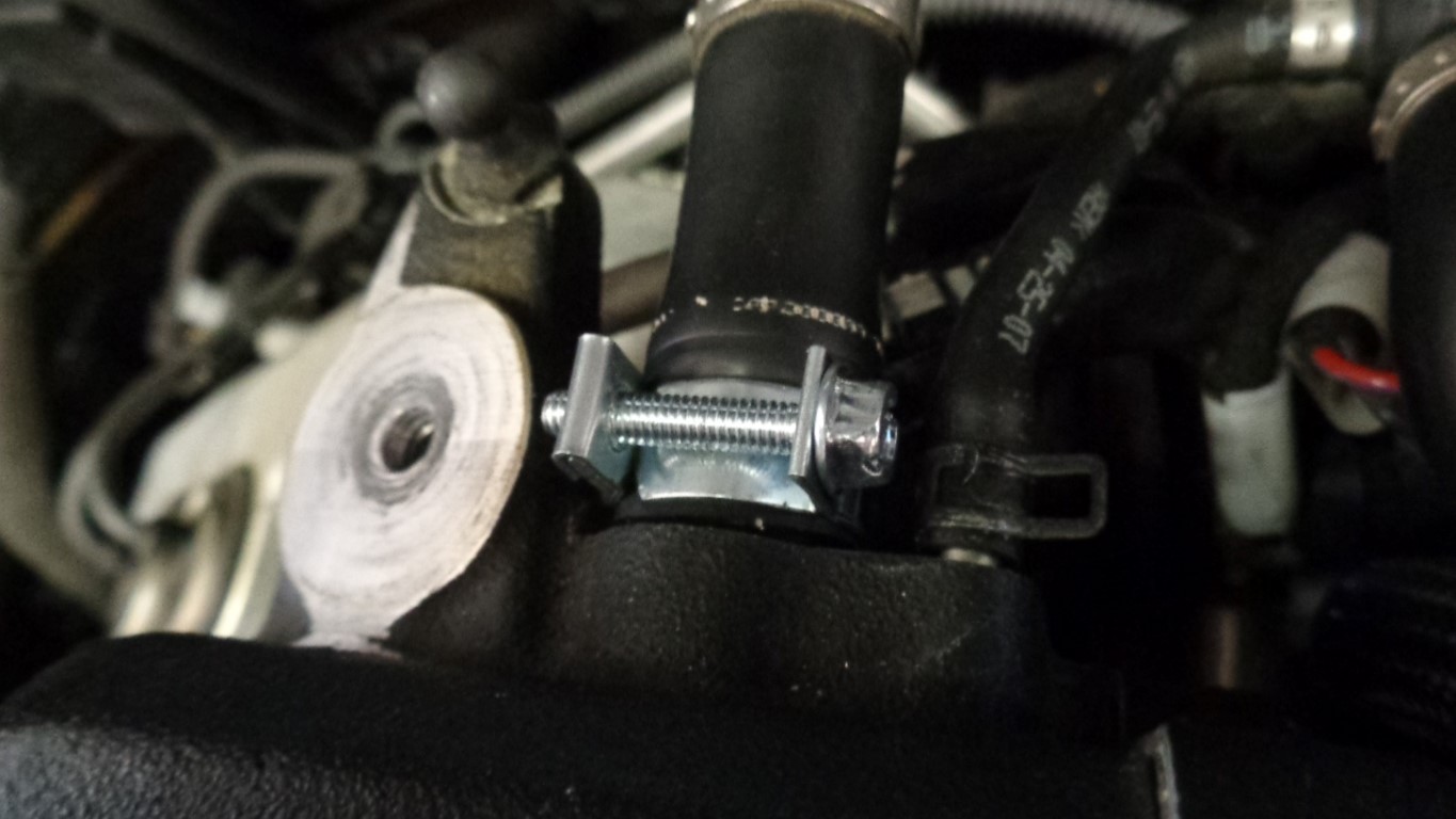

I tried the trick of not disconnecting the hoses at the rear of the intake manifold and just propping it up with a spray can. That didn't give me the free access to the coils and plugs I wanted. So I went ahead and cut the two hose clamps and removed the intake completely. Upon reassembly I used to high pressure fuel injection clamps to replace the two original clamps. (see photo) I have two of the OEM clamps but not the tool to squeeze them.

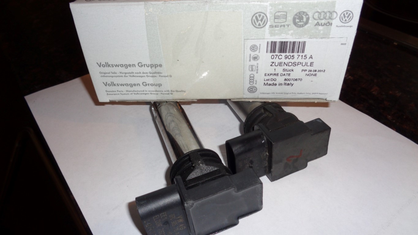

The plug in cylinder #2 was rather black compared to the others. To be cautious I replaced the coil for that cylinder as well as the plug. Got the coil for $30 from my local VW dealer. (see photo of new and old coil and part number on box)

.....On your job...the original hose clamps are better and cheaper than the screw type...the originals are Oetiker and can be crimped with conventional Tile Nipper tool...they are better because can't loosen with vibration...JimB

I've been working on cars for 45 year and have never heard of a screw clamp loosening.
Note that the clamps I used were not worm clamps but OEM clamps used on many cars for high pressure fuel lines. If they were a problem we would have read about the numerous engine compartment fires and recalls by now. Also the advantage to these clamps is they can be removed easily and reused. Not so with the OEM Bentley clamps. I actually got two of those in my 40,000 mile service parts kit but chose not to use them.
Be careful using tile nippers to close the clamps as they can overstress the clamps and lead to failure. In other words if you overdo it you can nip right through or partially through the metal. I believe the correct tool is designed to stop before you get to that point. Could be wrong about that though as I don't have one.
