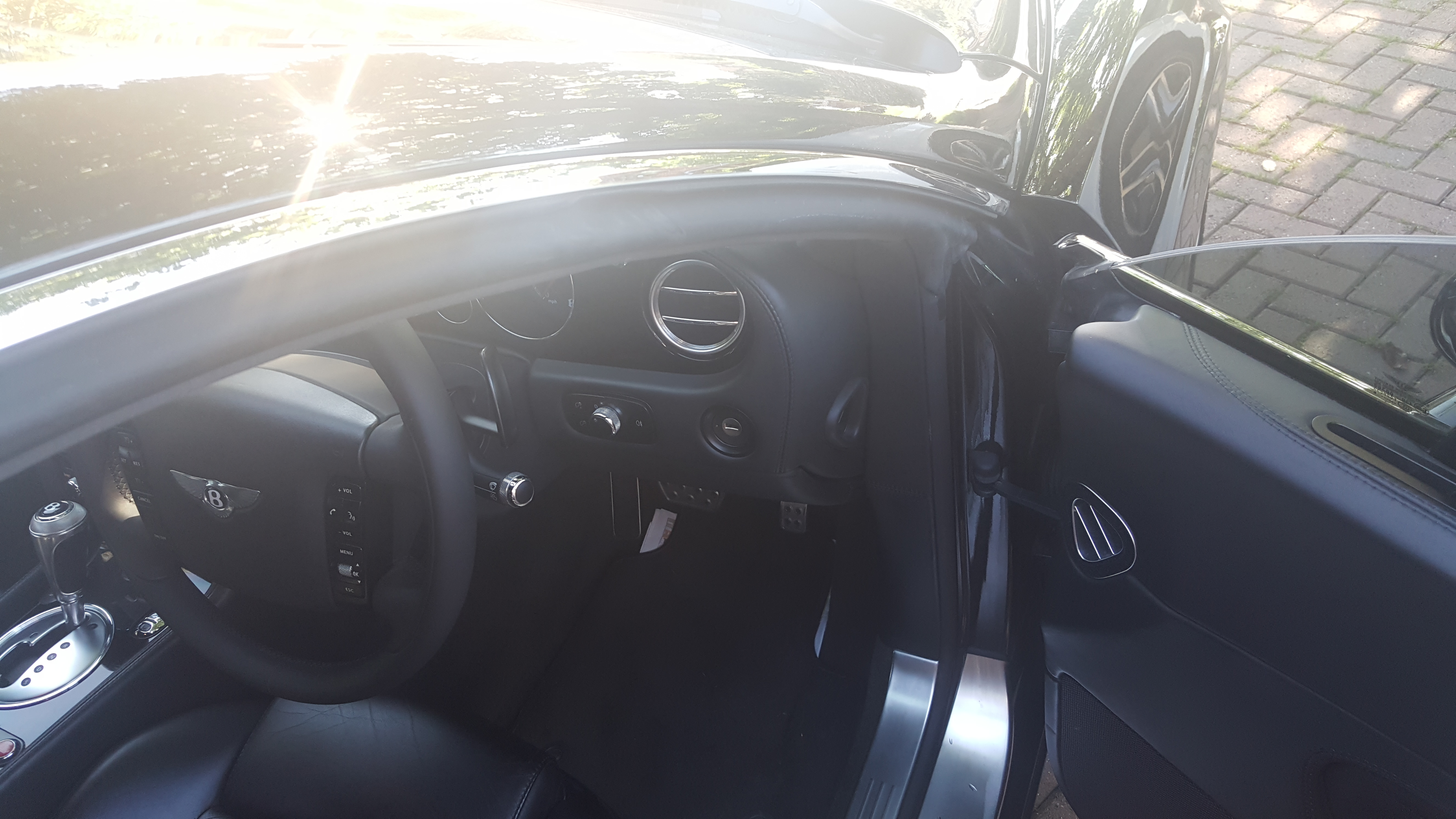

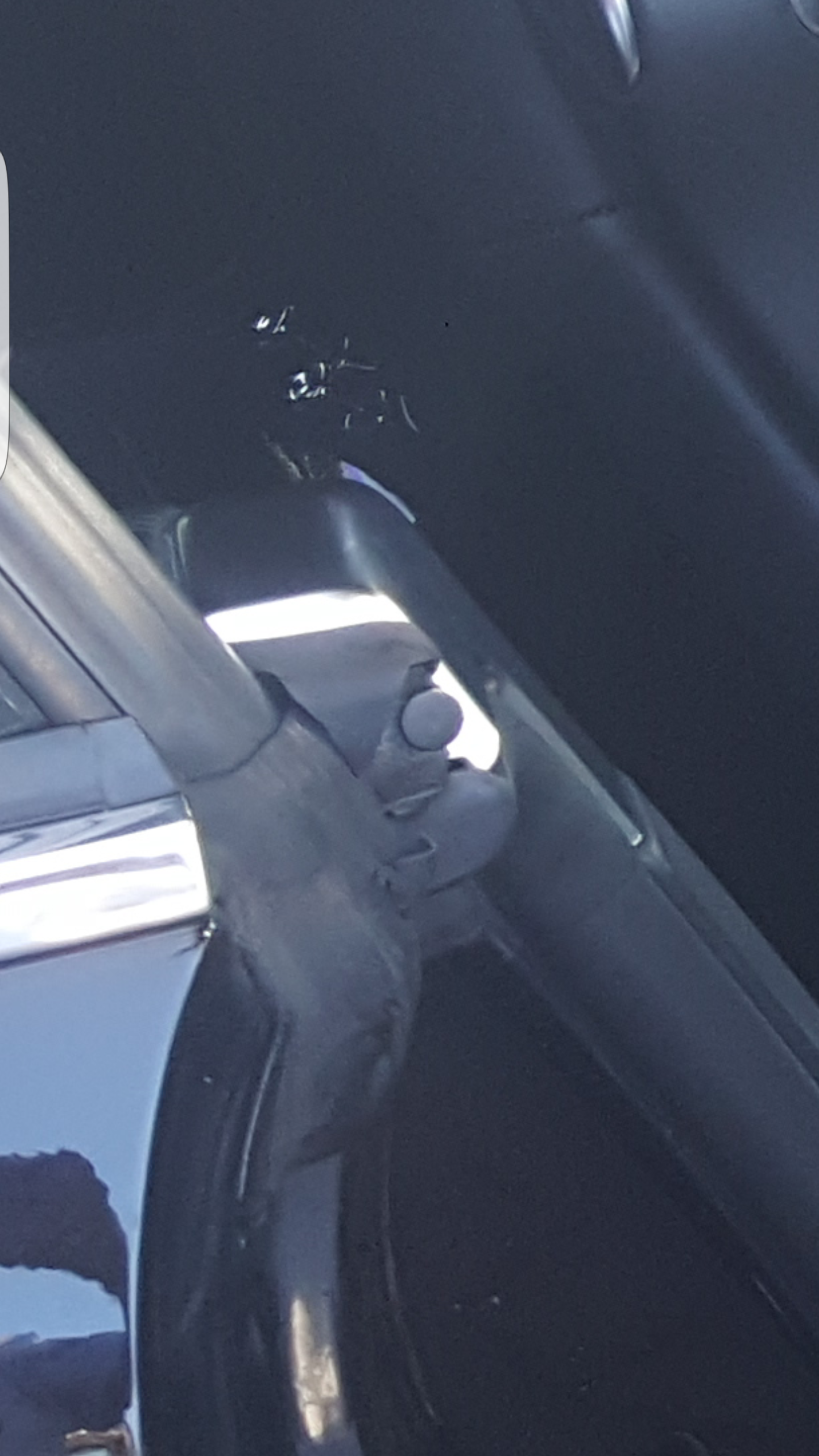

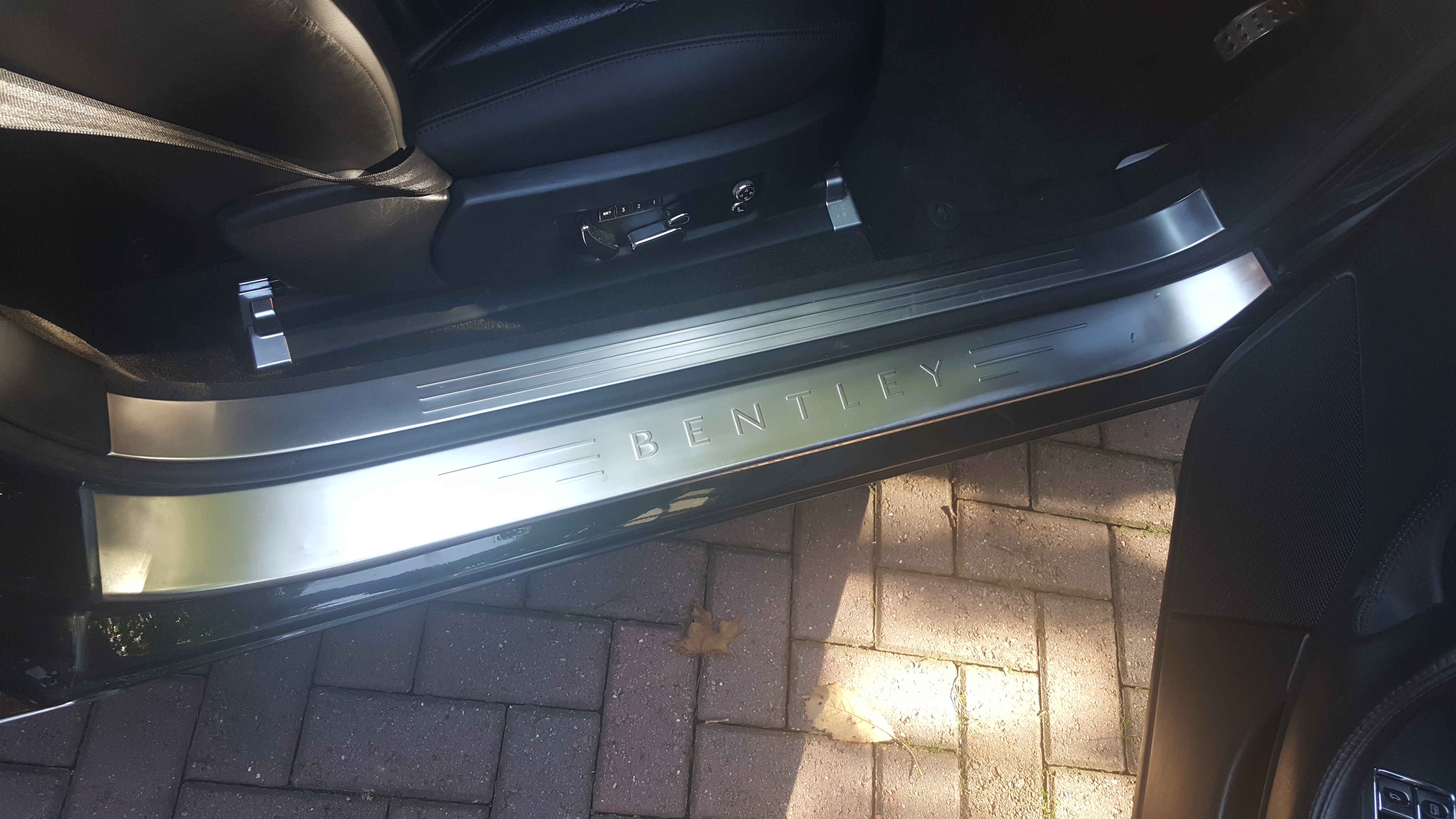

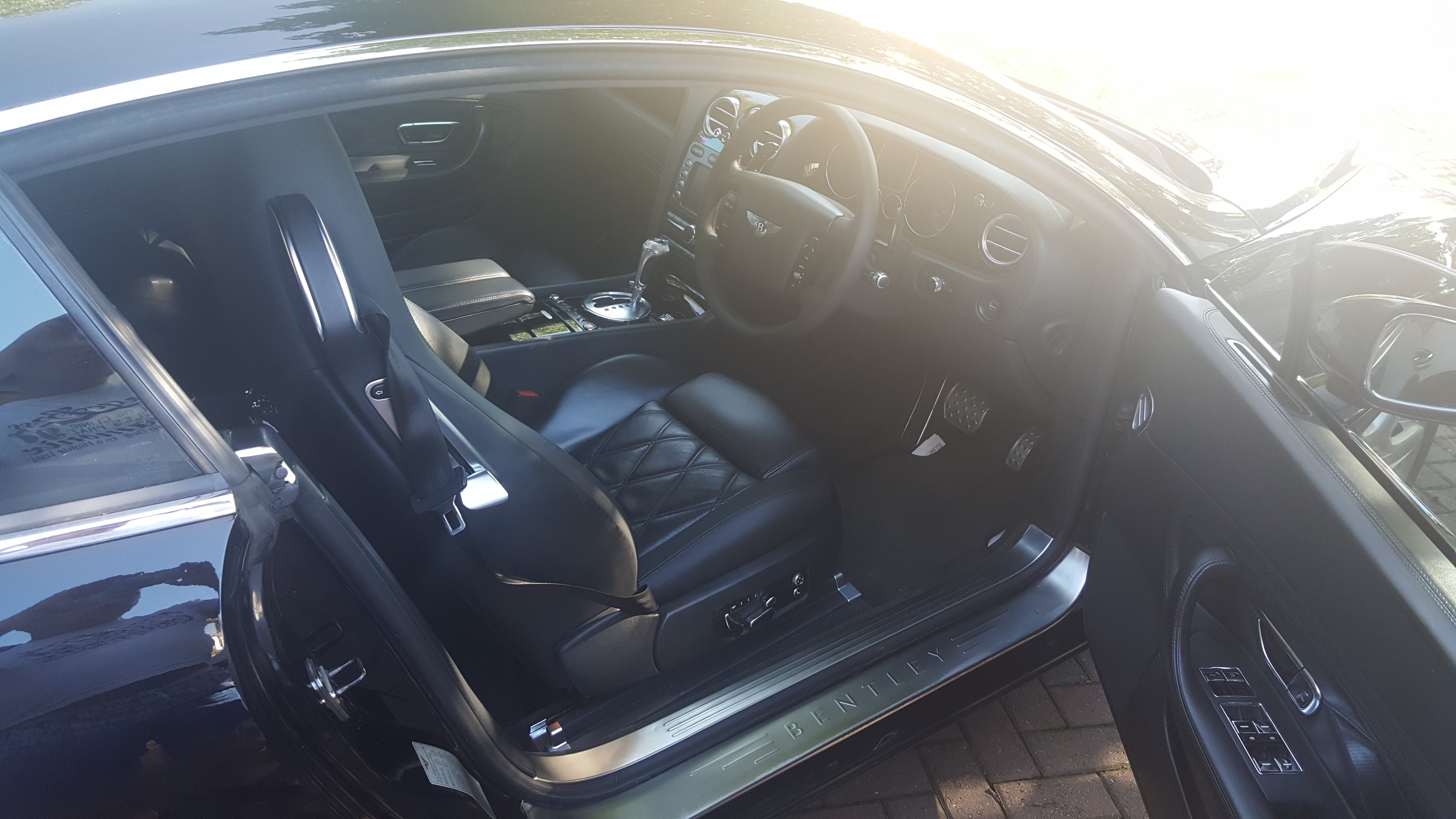

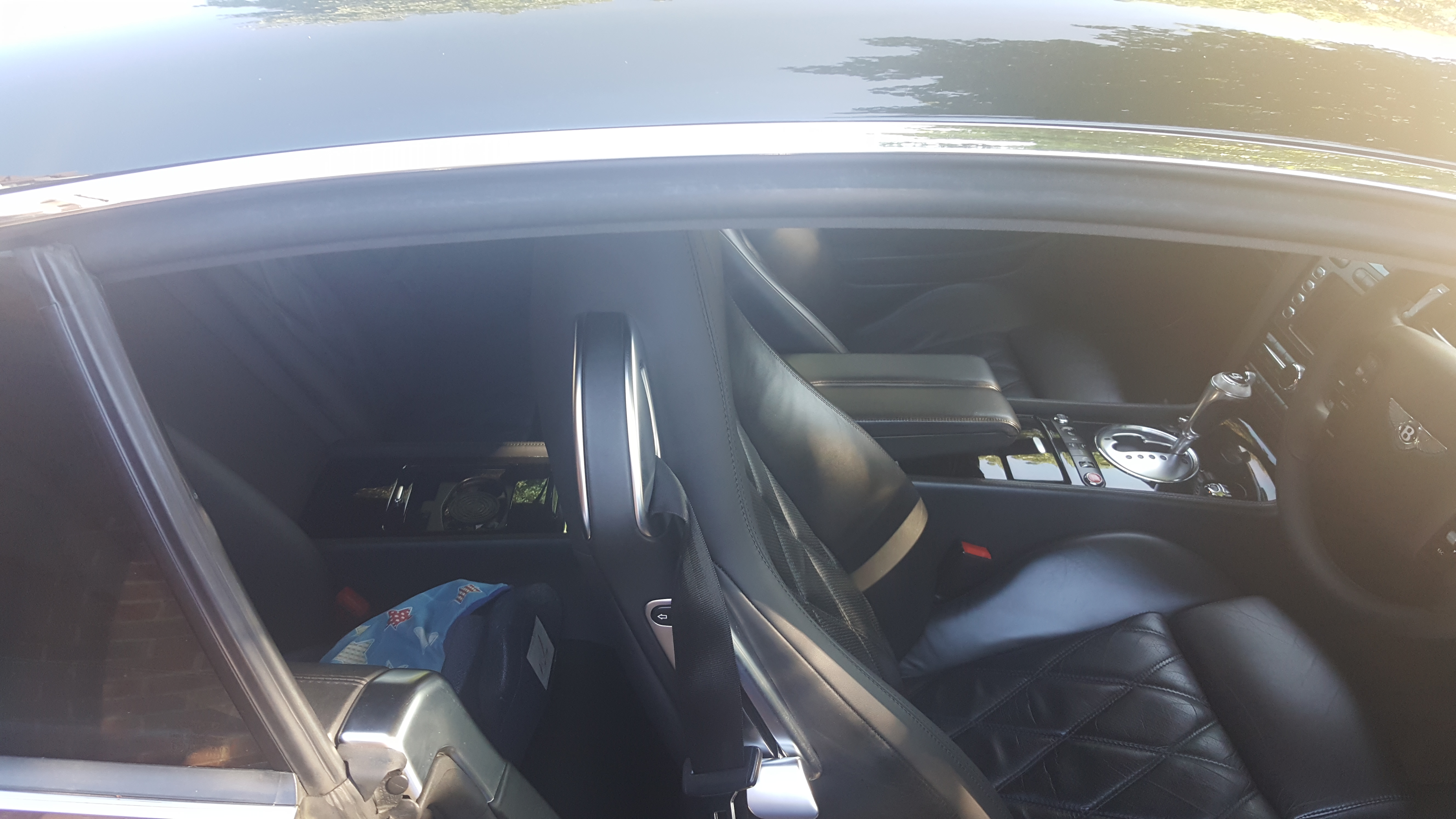

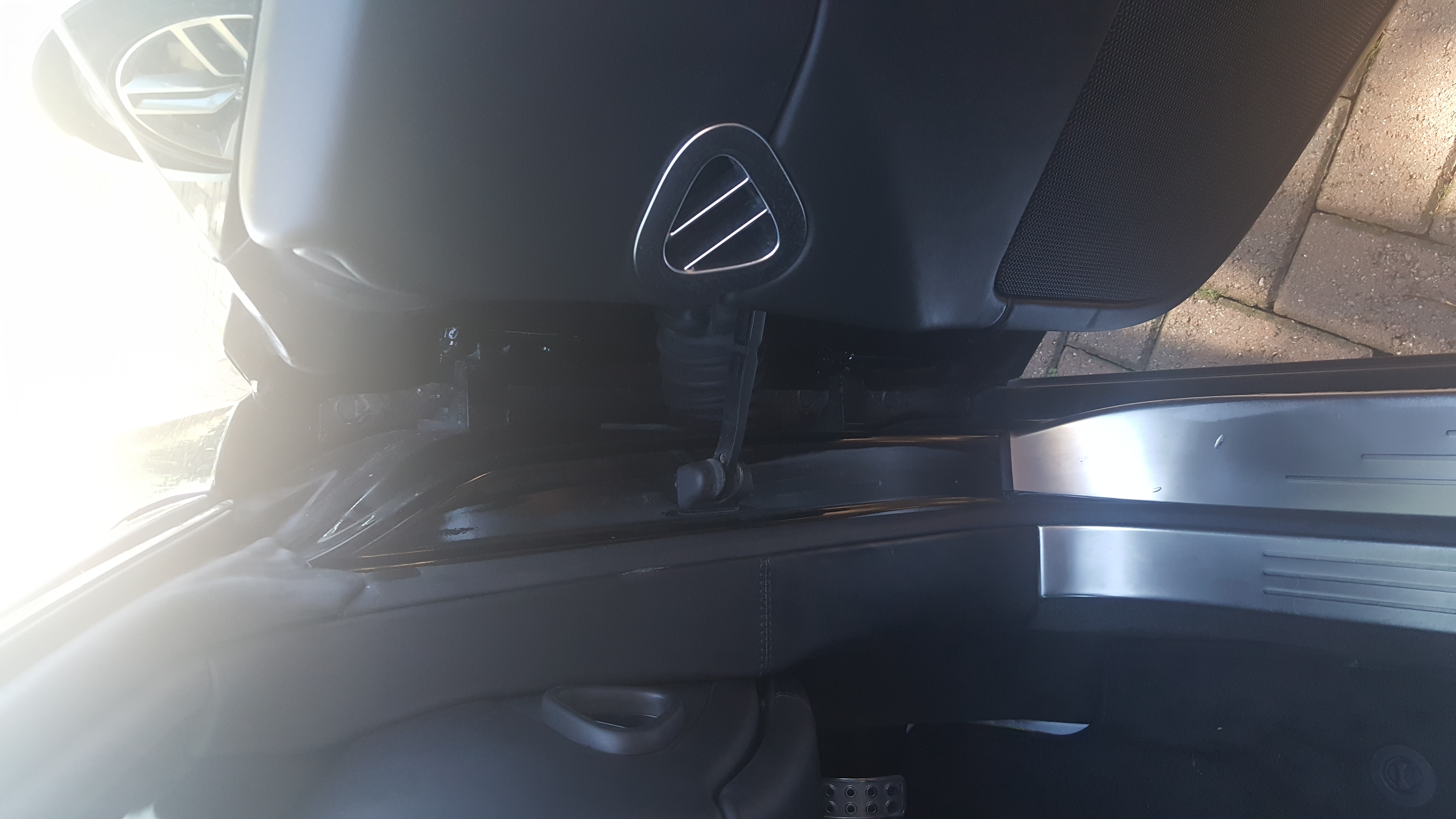

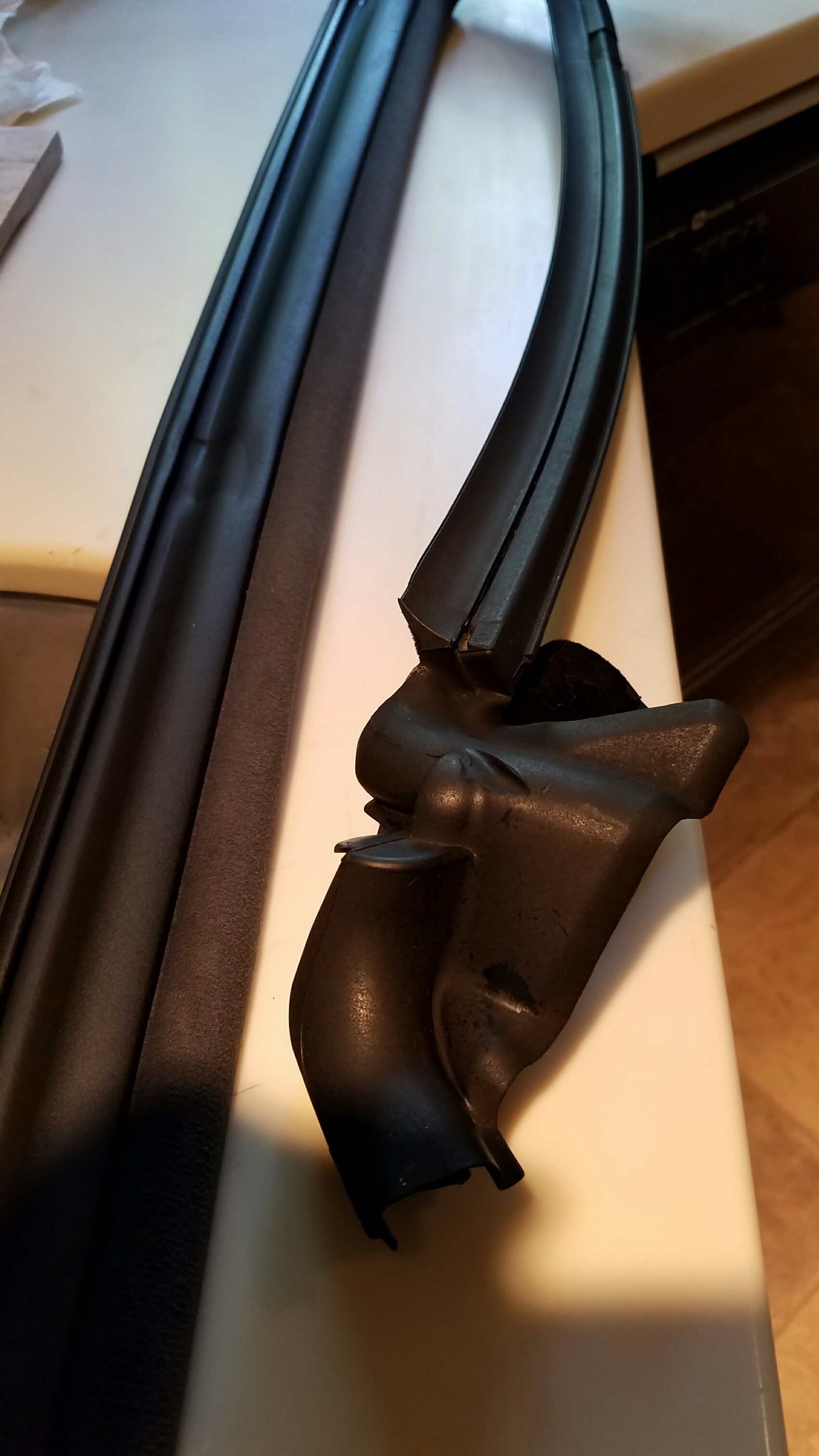

Hi Johnny
Sorry not the best pics as there was a lot of sun glare, let me know if you need me to retake them and thanks for your help

There is some rubber damage to the chromed area next to the bottom of the rear window
not sure if that could be the issue? Iv priced up both the upper and lower rubber seals. Lower comes in around £35 and upper is £650

Hello Mike,
Yes I would say that the damaged portion of the upper gasket by the rear window is letting the water in as it is pretty well torn up, and then the double gasket system on the door itself is holding the water in, that is why you have water on the sill, the door system is doing it's job but the quarter glass seal/upper door jam is not, bend down and look at the bottom of the door to see what I mean about the lower door gasket trapping the water, if you fix the top then no water should get in, I have that complete upper gasket, but I am across the pond...
sending PM.
