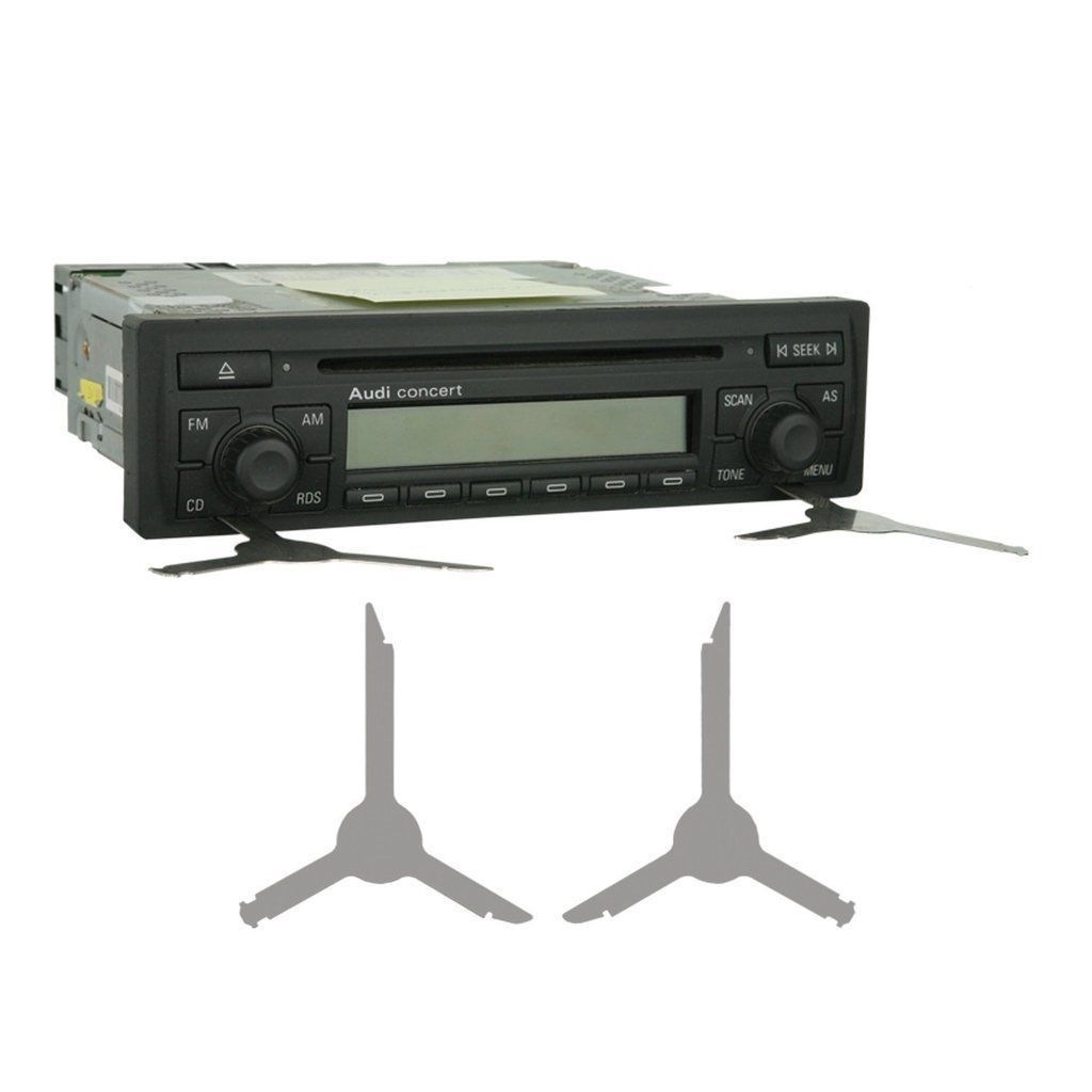

For the Grom Bluetooth to work, the CD changer is completely removed. Once out, press on the two small tabs of the CD connector in the rear, to release.
A pair of these available on Ebay or Amazon
CD changer removed. Once the keys click in, there is no resistance from the housing. .
The connector as shown at the rear is all that's needed to connect with the GROM. To remove the keys, press on the lower bronze colored metal bar as it will click and release.

What search term do I look for on Ebay for the removal keys? Does a new unit from Grom come with the keys?
There are NO keys that accompany the Grom. Borrowed mine from a Bentley tech.
The following should work:
https://www.ebay.com/itm/4x-Car-Radio-Stereo-Release-Removal-Tool-Triangle-Key-for-VW-Audi-Mercedes-Benz/273434070262?hash=item3fa9f0ccf6:g:7uIAAOSwikRbiCf g]https://www.ebay.com/itm/4x-Car-Radio-Stereo-Release-Removal-Tool-Triangle-Key-for-VW-Audi-Mercedes-Benz/273434070262?hash=item3fa9f0ccf6:g:7uIAAOSwikRbiCf g

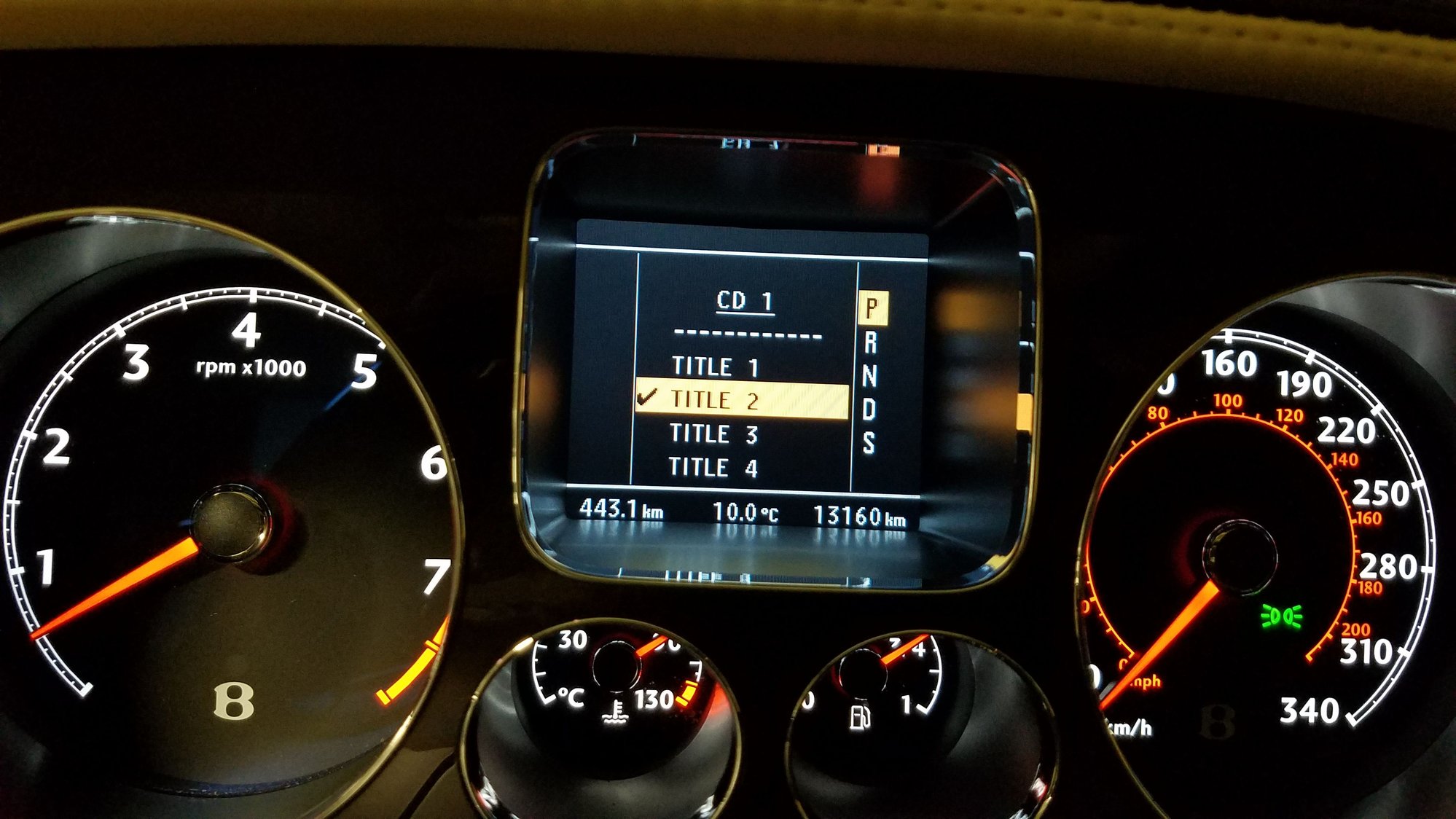

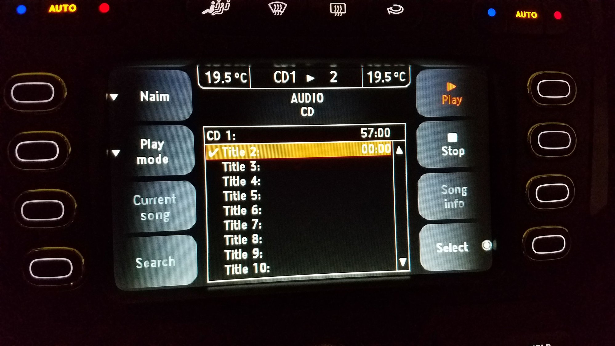

Grom installed
Grom installed yesterday. With the vehicle in OFF, it was a simple task of plugging the CD changer connector into the supplied Grom cable. Turned on my Samsung S9 to enter the bluetooth scan setting. Grom appeared and pairing was quick. The result is having excellent quality audio from my phone (Google Play and Spotify). Being Android, I knew no titles available, however scrolling forward/back can be done through both the center head unit or steering wheel controls.
The OEM bluetooth telephone system continues to work, therefore installing the supplied Grom microphone was unnecessary. Music is paused during calls and resumes from its previous spot.
The Naim system has never sounded so good with the endless songs from my chosen playlists. I can attest that one will listen to way better sound quality than Satellite and FM radio. The Bentley drive has become more pleasurable. This bluetooth product is one upgrade all Gen 1 Continental owners should consider. Repeated thanks to RICO.ADAMS and this thread of TONYGUNZ.

Used a foam cube to keep unit temporarily in place.
Scrolling through center radio unit
Scrolling through steering wheel screen
