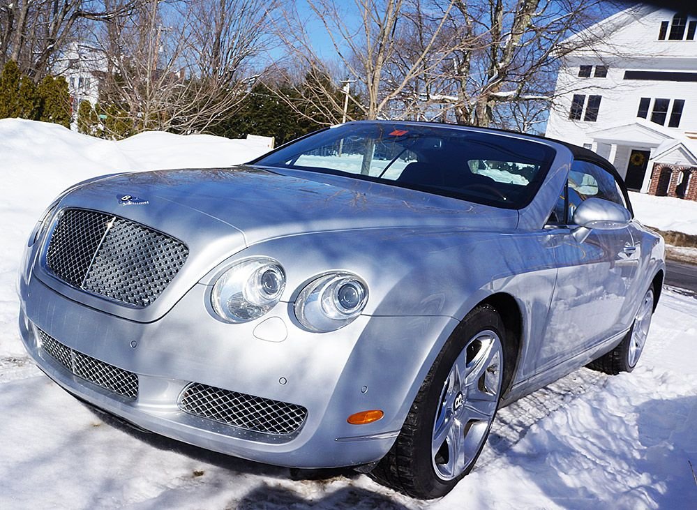

What winter storage??

Agreed, the MOST FUN i ever had driving the Bentley was in the snow.
