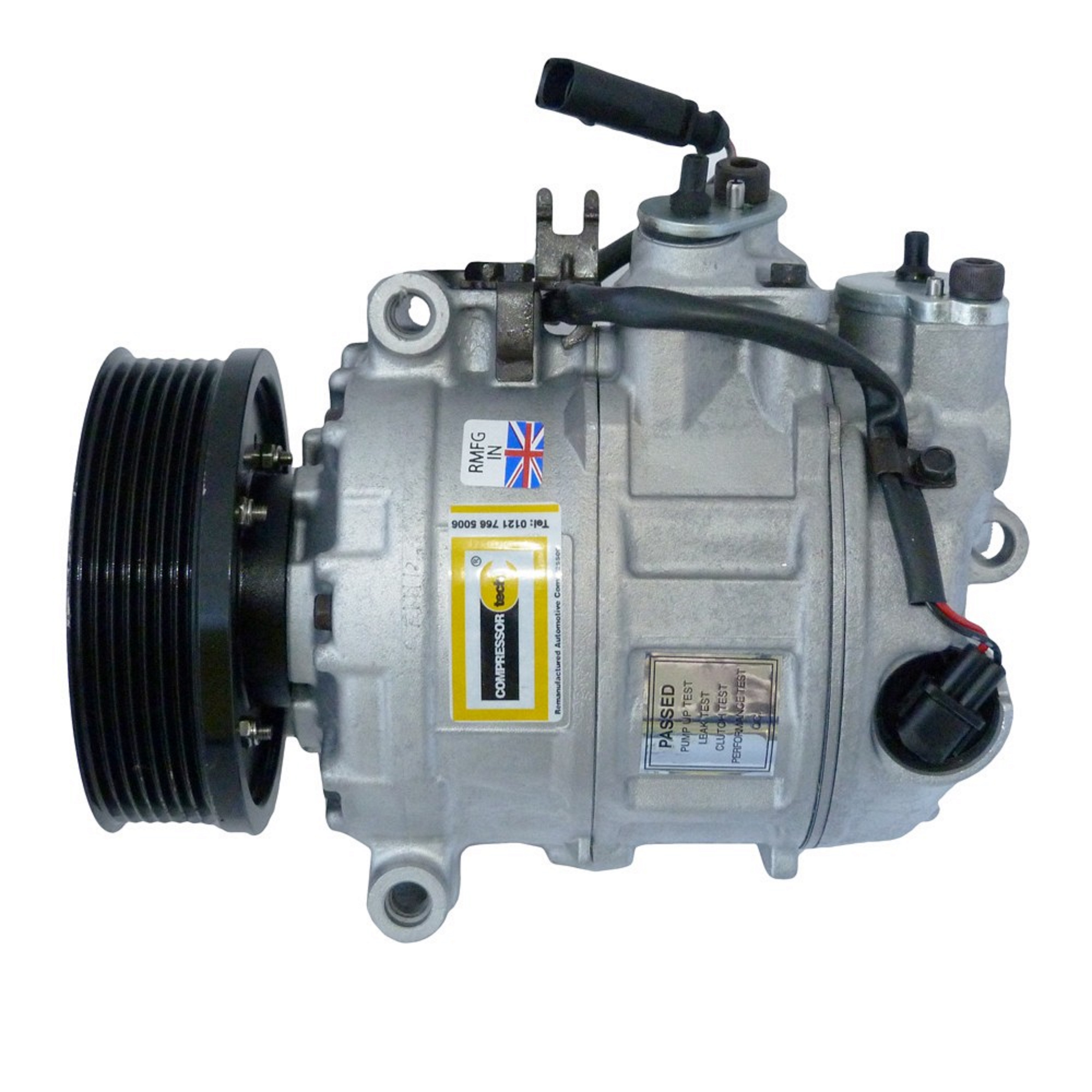

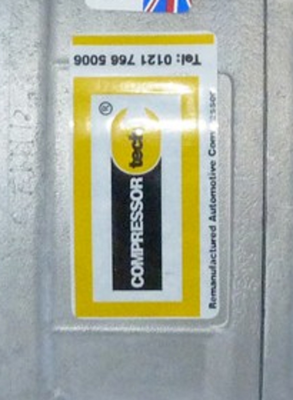

Did anybody notice the sticker on the "NEW" unit from Flying Spares, "RMFG" in Britain....
"This is a new, genuine Bentley part."
I come up with re-manufactured as also seen on the yellow sticker.
http://www.flyingspares.com/shop/ben...3w0820803.html

LOL! Selling remanufactured as new. Why am i not surprised. You could sell the car before it costs you another $5000. Am soooo happy to sell the GTC and no longer have nightmares about the costs of car repair or dealing with the VW Group who seem to not care at all about their customers. Even a repeat customer like me they burned.
