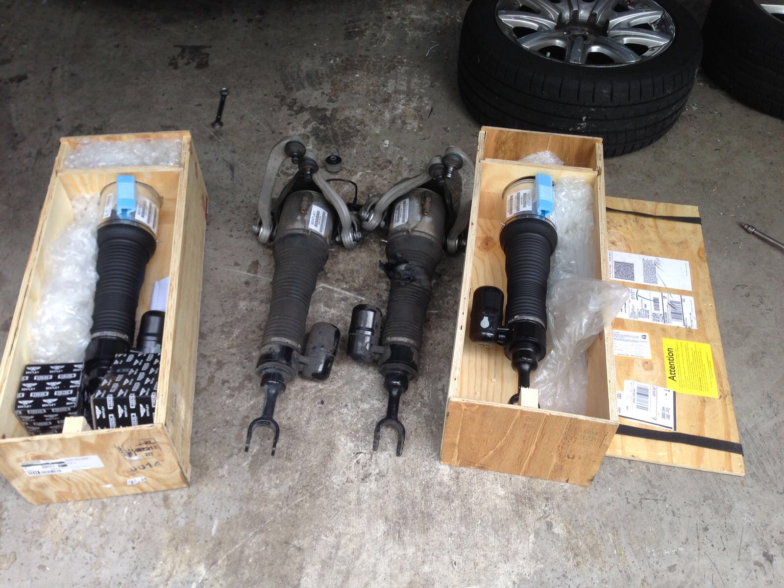

My front right shock just blew today and soon after i got the warning car is too low, stop car.
I would like to remain with air shocks so the question remains which company to use for recon front shocks?
Comparing Arnotts or Rebuildmasters shocks which are more durable or are they better options out there?
Many thanks!
J
Many thanks!
J

Appreciate your input as always Johnny.
I've not heard of Aerosus but a quick search shows some negative reviews from end users.
Given that recon only replace the air components and use old strut with an unknown age I've decided to go with new OE.
Do you know if there were changes to OE shock as flyingspares show different modification code, B vs D and M. What do the shocks from your parts bin show?
scuderiacarparts
3W8616039B (LHS)
3W8616040B(RHS)
GBP1,395 each
Flying spares
3W0616040M (RHS)
3W0616039D (LHS)
GBP1,653 each
Thanks
J

Good Morning Jc,
I saw this first in my email "Just searching around and found that the new Arnott shock on their website does have the electronic dampening in their new struts.", and the answer is no, they do not.
Now, as to what flying spares is stating, they are incorrect, and if you press flying spares to contact Arnott, they will find that they to have been misled, Arnotts new strut does NOT retain any electronic dampening adjustments of any kind, what they did is put a resistor inside the strut and did not tell anyone that until I pressed them with phone calls and on AW, even when I called them their tech tried to tell me that their "new valve has 4 levels of dampening", I laughed and asked for details on how if in fact did not have the electromagnet dampener, and after several back and forths on the phone it came out that it was just a normal shock valve with no adjustments of dampening levels at all, and the fact that they stuck a resistor inside, that to they were hesitant to tell me, instead stating "we will tell you how to fix the dash warning light after you purchase our struts", NOT COOL !!
Also just to clear the electrical connection up, it has nothing to do with the "auto leveling", the electrical connection on the top of the struts is strictly for the dampening of the strut, the auto leveling is taken care of by the airbags that are attached to the struts and only have a air line feeding each airbag, the leveling is done by way of level sensors at all four corners attached to the suspension, a air compressor, and a suspension control module.
And as to the link for arnotts Bentley strut, I take it as very misleading, I mean really, why not come right out and state that the new struts do away with the electromagnet dampening which in turn takes away your ability to actually have a setting of sport VS. comfort, and takes away the many different mappings used in the electromagnet dampener based on the skyhook theory, it is NOT just the airbags that set the ride feel and control, it is the electromagnet struts also, and how about the fact they think it is okay to put one of their new struts on one side of your vehicle while retaining the OEM unit on the other, does anyone else see a problem with that, I mean one side of the car will be reacting electronically to the road conditions, while theirs does not....

Hi Johnny
Appreciate the input as always.
I did type up another msg but deleted as Im constantly searching for correct information and was thrown off when flying spares told me the Arnott retain full OE function.
Having searched this forum I see that Doug from Arnott stated that whilst auto levelling works the dampening adjustments do not work.
I have since copied that link and sent to flying spares who will in turn contact Arnott and confirm what they are actually selling. I was about to purchase the new Arnott from flying spares when I recalled one of your messages stating it did not have the adjustable dampening function.
So after searching high and low for suitable new shock with all OE features, I'm back at square one and will purchase front pair from flying spares.The price difference between recon with core and delivery to mine is around USD620 so new is defo the way to go for peace of mind.
Thanks
J
