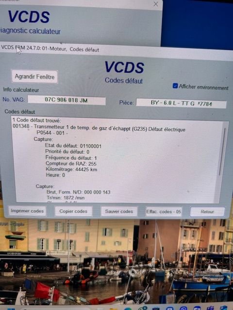

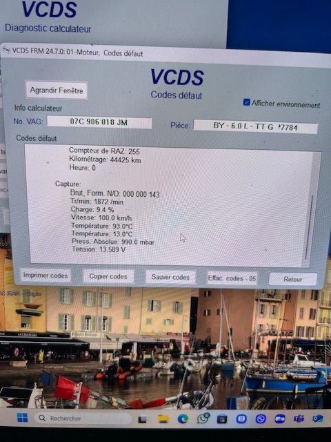

hello friends I hope you are well.
i just had a problem on my bentley contiental superpsorts of 2010 here is the photo
but I don't know
if it's the probe on bank 1 or bank 2

Salute,
The fault is signaling Bank 1. Usually a cold solder on the PCB board. Sometimes a reflow can save the unit. However on the US ebay sites the exhaust temperature sensor price has dropped alot. The main issue is Bank 1 is challenging to remove the probe.
