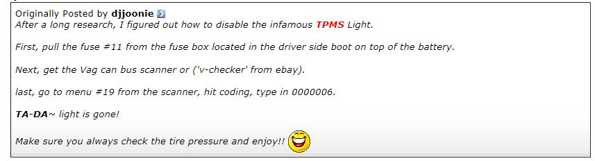

Tire pressure light
Originally Posted by PMS
Sadly, I have disarmed my TPMS as I found it unreliable and prone to battery failure in the transmitters. Consequently, I won't be able to answer your question. It does seem plausible that the car is "smart" enough to adjust.
how can you turn on the tire pressure warning cause mine stays on and it’s annoying.
Thanks
Thanks
This topic is covered several times in this forum. Here is an example.
