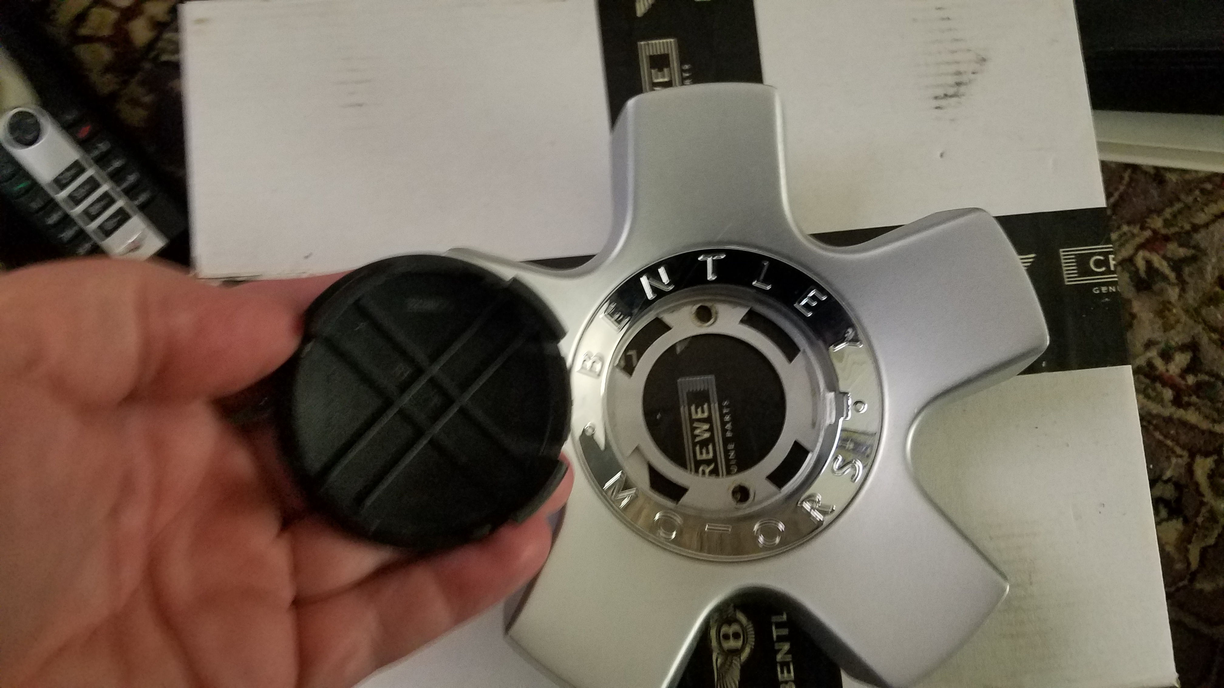

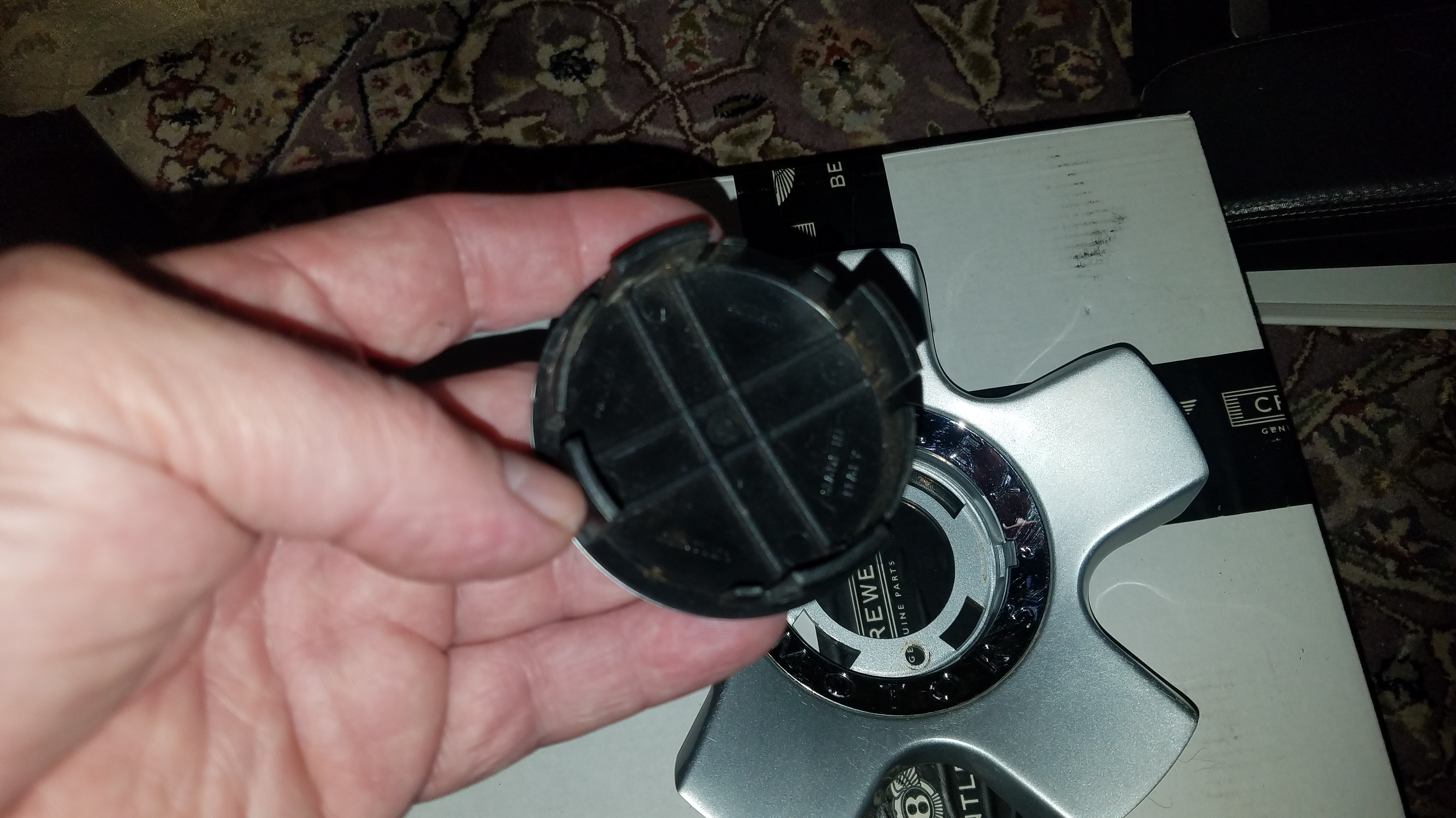

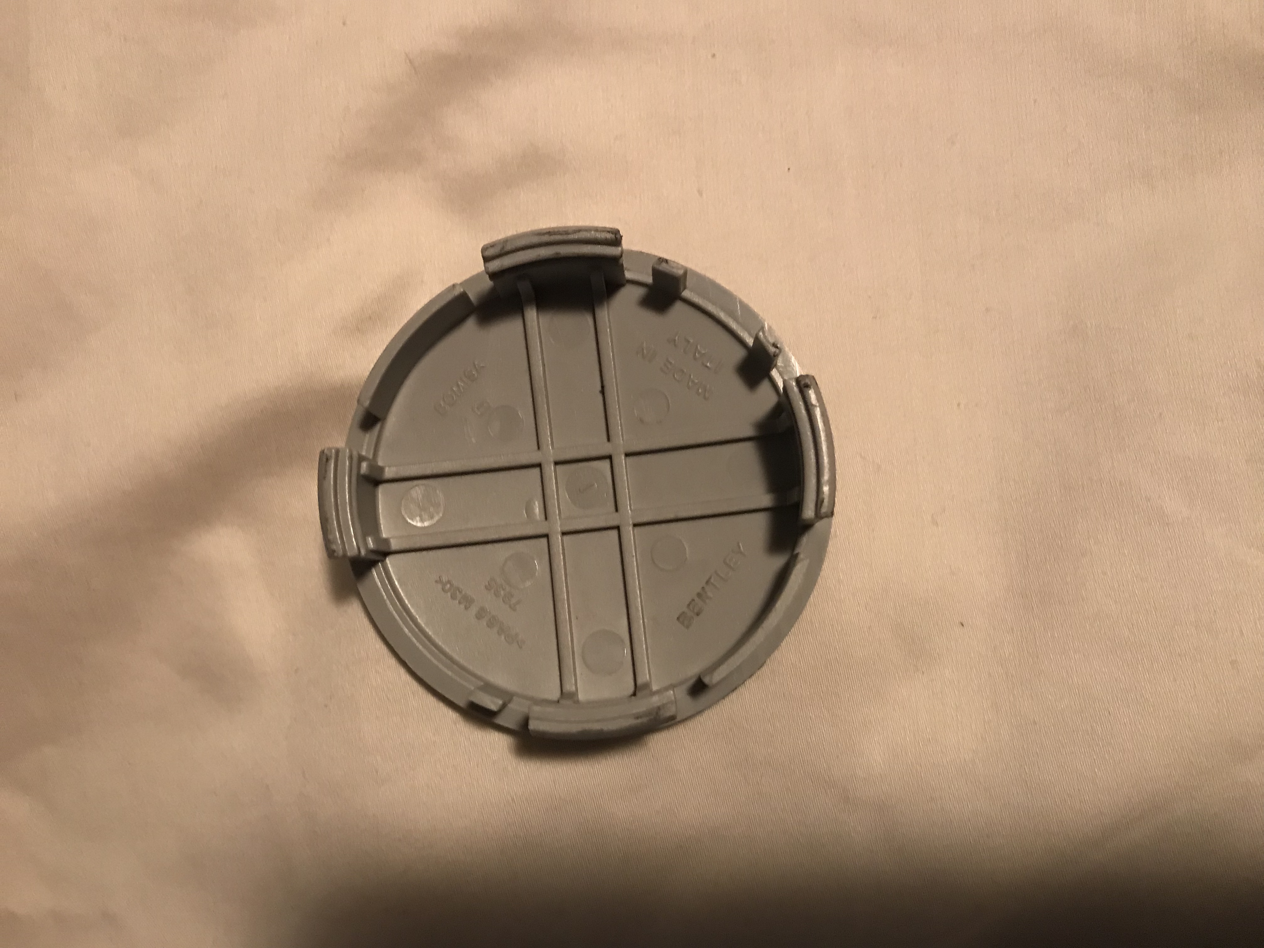

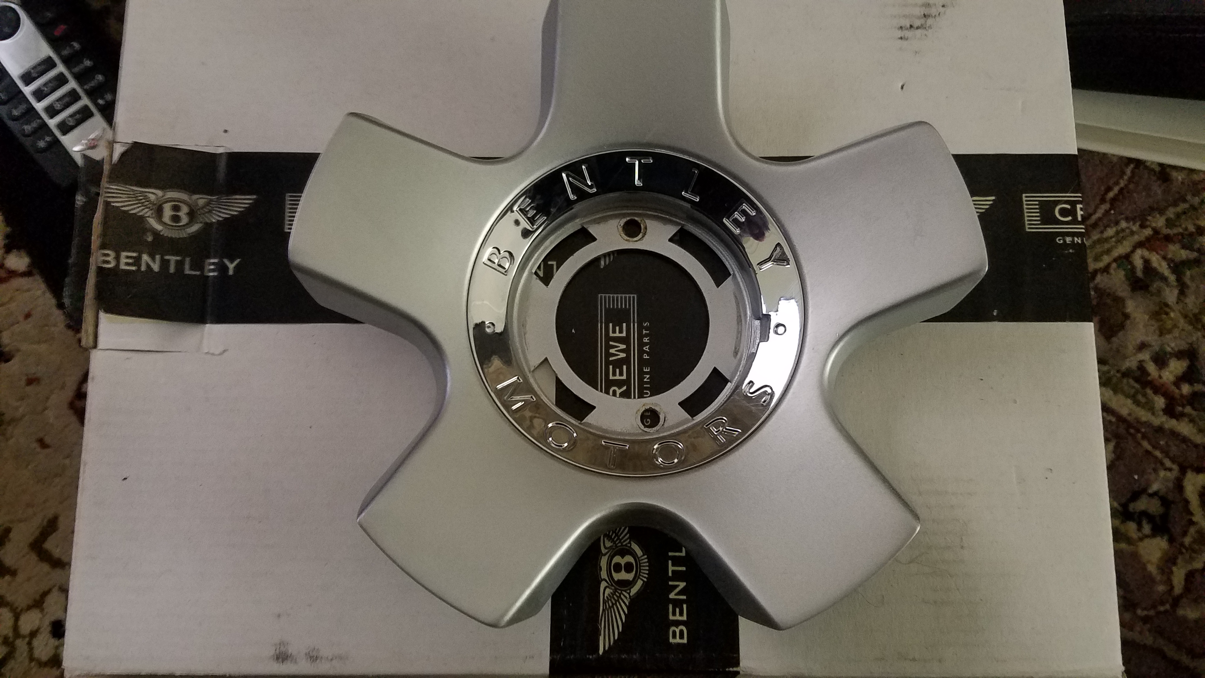

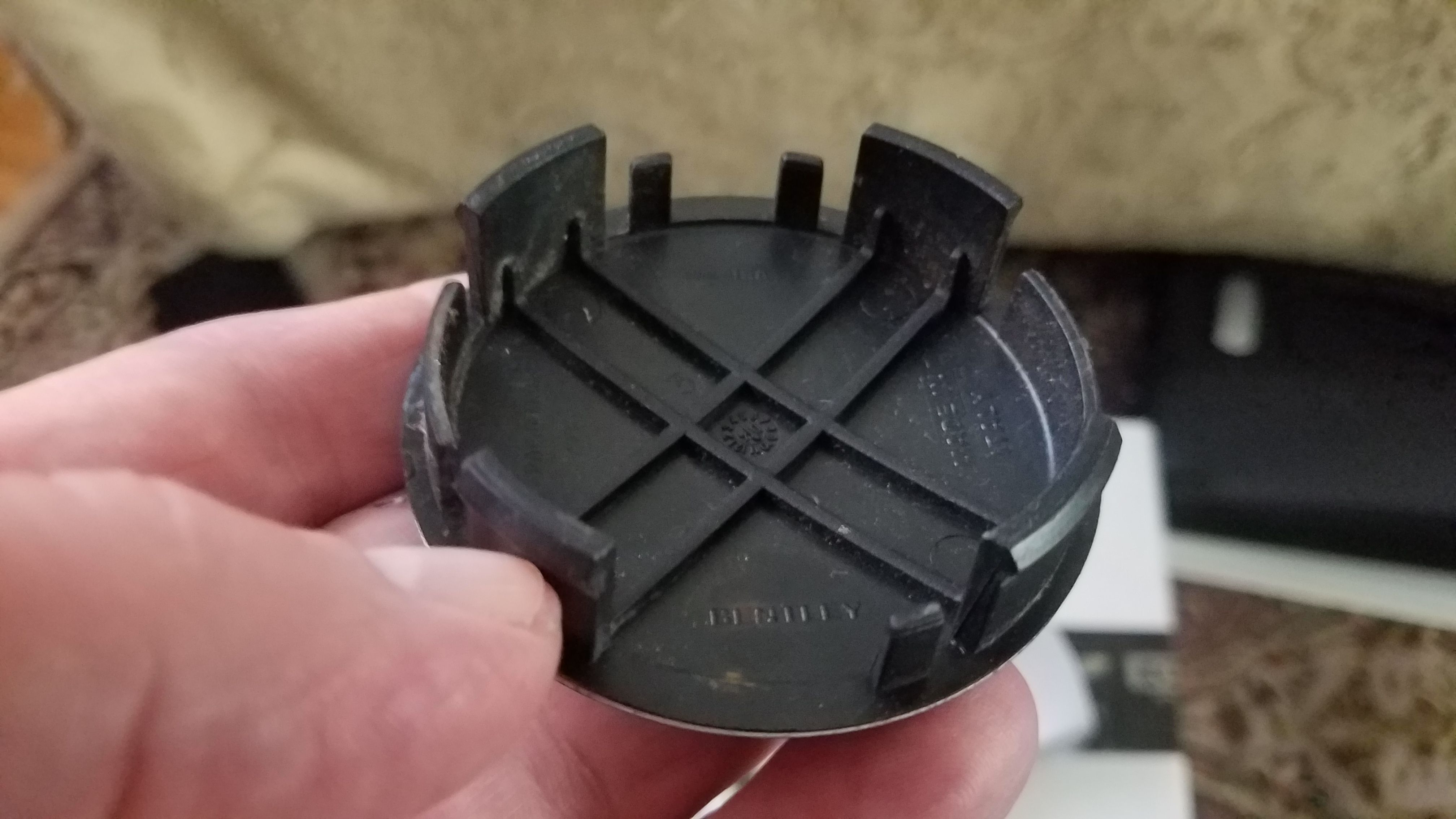

Had my tires changed and for the life of me, I cannot install the center B round caps in the wheel. These are plastic letter B disks with 4 prongs on back. I am having a tough time installing these. Is there an easy way to accomplish this?

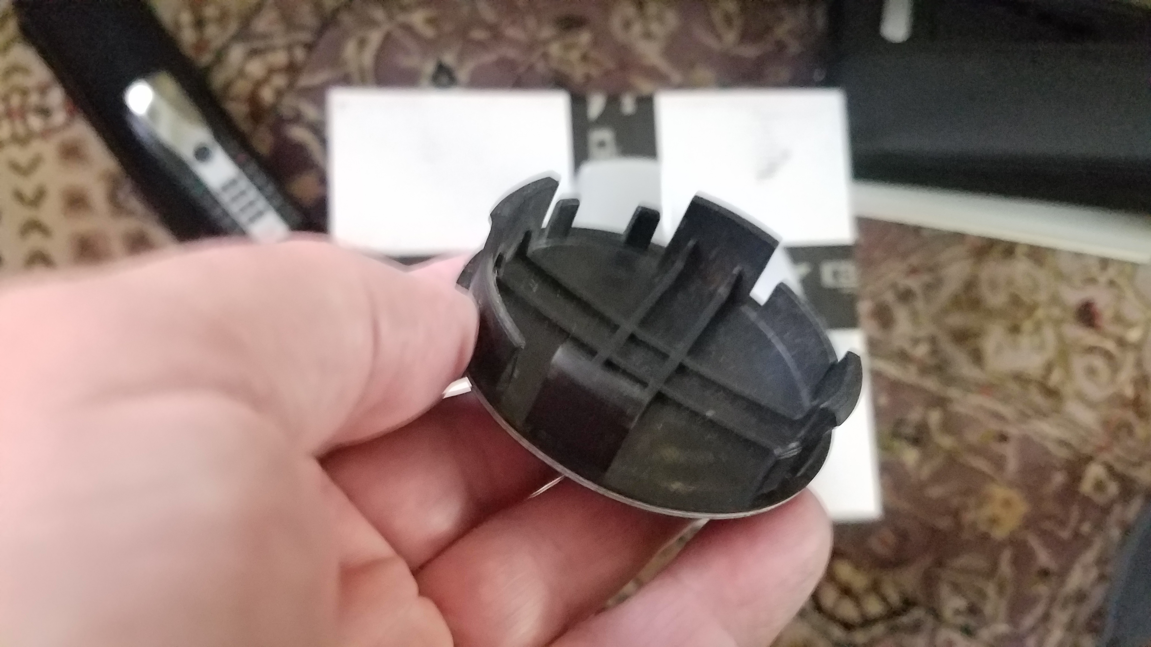

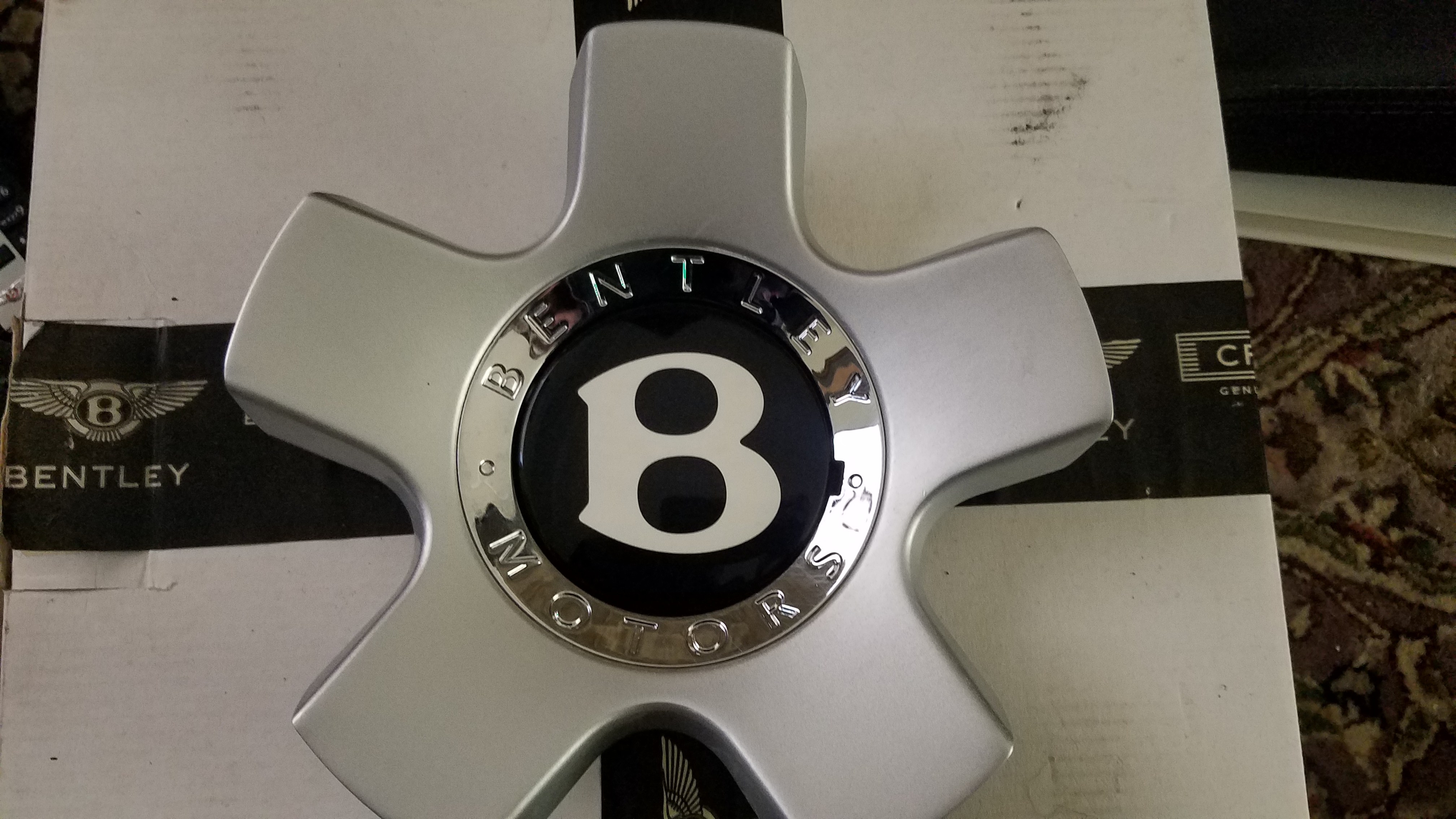

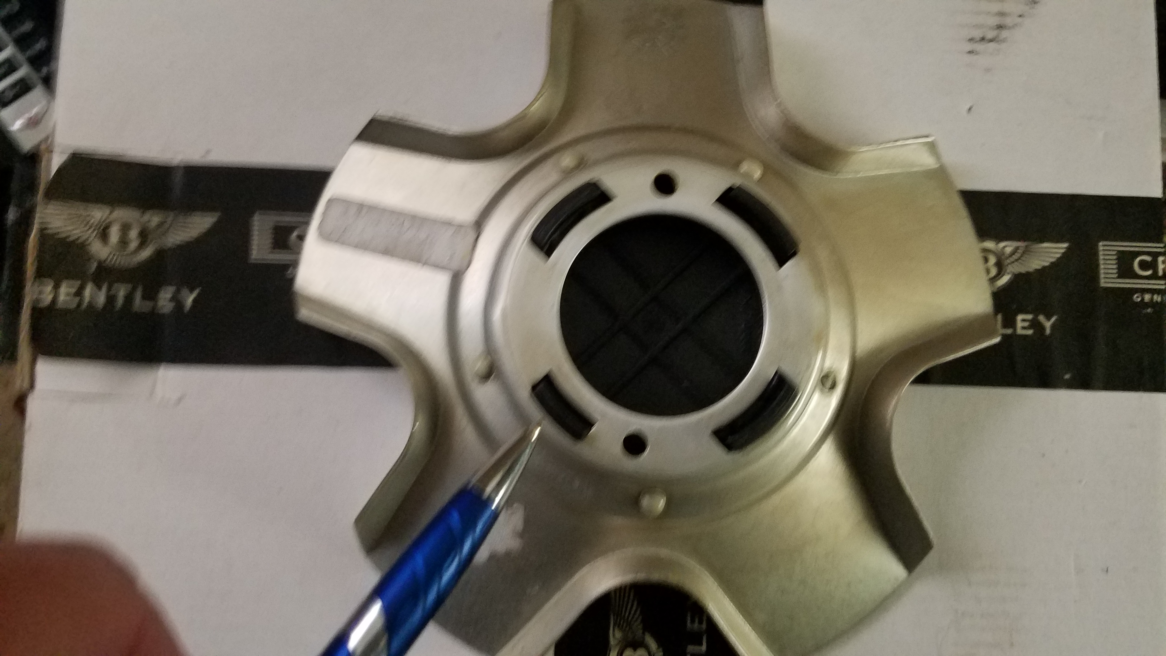

If you look closely at the 4 prongs, you will notice that one of them is smaller, (shown by my thumb), that smaller prong lines up with the smaller receiving hole in the center wheel piece, (shown by pen), just be sure to put the two bolts in first to hold center piece on.

i had to crazy glue my caps to stay in. Kept losing them on highways with big potholes I was giving ebay people good business buying B center caps every season. The answers above are solid, just need to shimmy and align the slots.

Problem with cap was that the center metal ring that goes on the wheel was bent, have to get another one that matches the rim.
