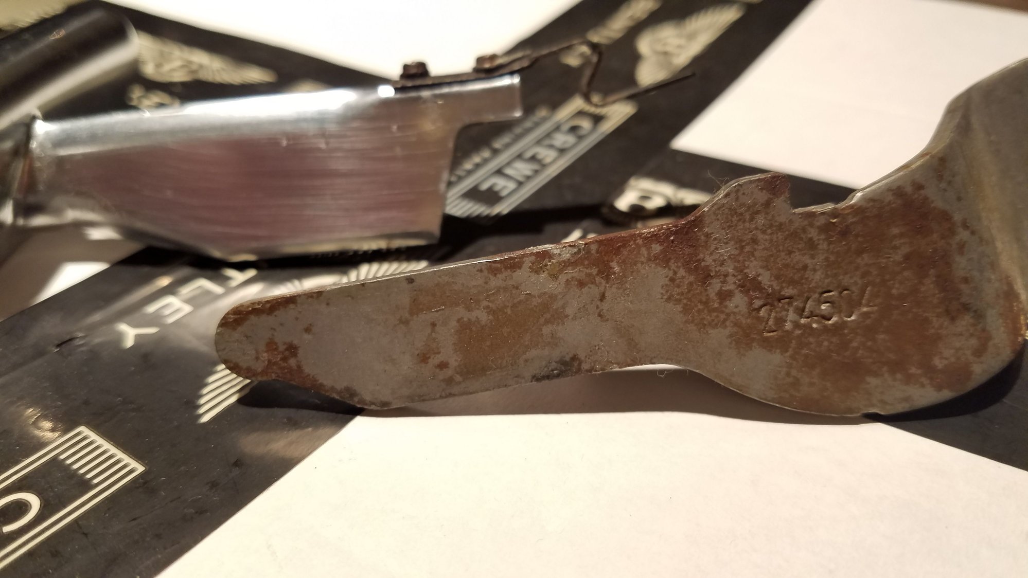

Anyone had to fix the seat lever?
Putting something in my back seat this morning and while using the lever to move the back forward, it came off in my hand. Has anyone had this happen or know a round about price on getting it fixed?

Hello TJ,
Just push it back onto the lever, just to note, there should have been a cable attached to the handle at one end, and the other end is attached to the seat frame, it may have been removed during a service, or it snapped at either end, as they do, this is to keep the handle from falling to the ground if pulled or knocked off, the cable is not needed to hold the handle in place, just push it back onto the lever you see in your picture until the clip shown in my picture clicks into place.
If you have broken your handle/clip, I have the item pictured for $ale.
Part # 3W8 881 633 or 3W8 881 634 depending on side.
Johnny

Johnny I was hoping you answered. I still have the handle, it just came off in my hand. I'll try that when I get off.
Thanks you!

Please confirm part number as shown in picture.
