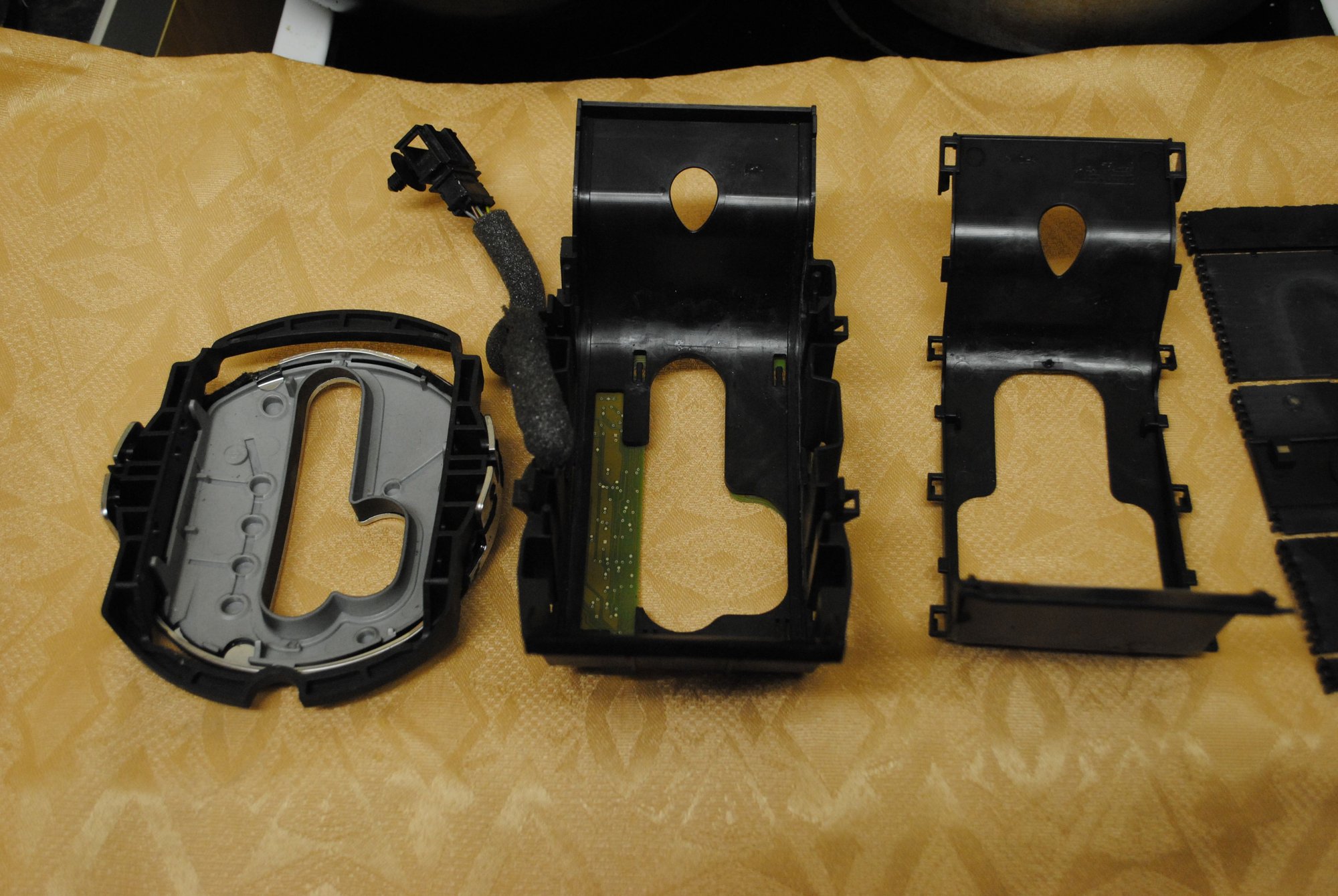

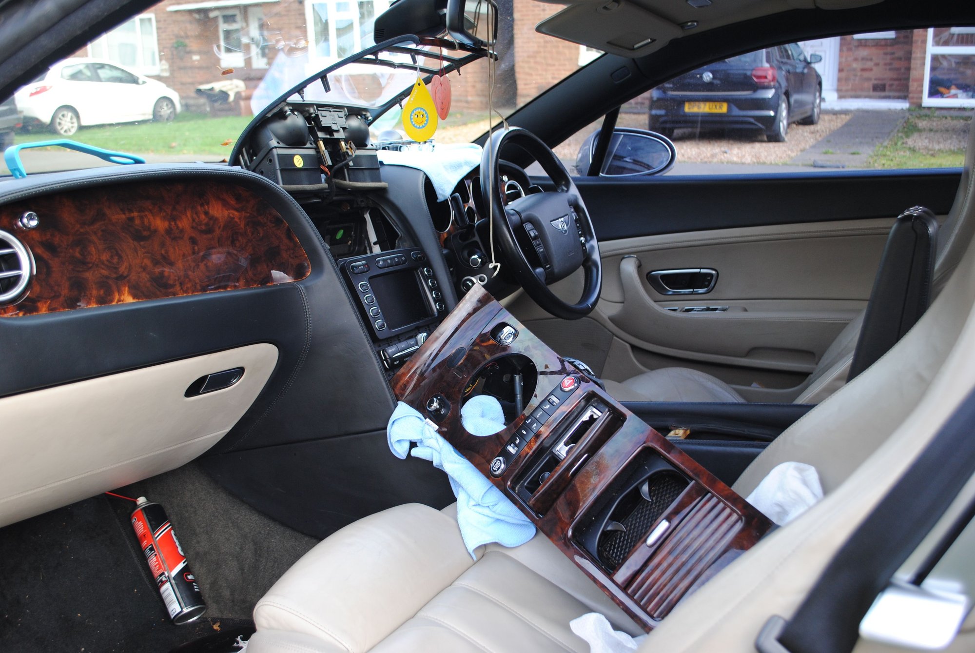

Not so simple
@US06GT
This is the best instructions on this gear dust cover i have come across Im doing this some time this week hopefully time permiting
I think im going to remove the Radio trim and Radio to make things lift up straight i did have a look earlier someone had tried and failed chewed up the collar on the gearstick and other bits
The issue is the two front metal clips that i feel need to popped out straight up as with the others ...I know some faff about twisting and pulling and hoping you will be lucky you might not be
So just a big thank you to @US06GT for the clear pics and Best Instructions on here without the guesing game
So how do you get the front two metal clips out can someone enlighten me ?
Edited
To get them out remove Radio surround woodwork be careful ..Plastic trim tools wedged in at the top a good steady pull to release the top two metal clips ..Quite tight as never been out ..there are four more clipsand out she pops ..
You have to lift these metal clips straight up to remove the centre gearstick console..by lifting the back they lock in even tighter ..Each to there own way though
Remove the four radio T20s screws giving yourself abit of wriggle room and viola follow @US06GT and @Johnny Hotspur GT great tips on doimg it there way
Pay close attension to the plastic clips when removing the Alloy gear bit from the plastic bit
You have two clips each side I did it by inserting a small driver into the clips on one side only and it releases easy
Good luck to all for having a go on this great forum
I found it alot easier to get it out of the way making it simple to undo electrical clips etc ..Its very tight in there said the Actress to the Bishop Uk joke
IMPORTANT TAKE NOTE ?
I lubricated the sliding bit with Krytox GPL 206 greaseto ease its operation for future use on the sliders to stop a repeat of doing it all again
NO ONE MENTIONS THIS LUBRICATION IN ALL OF THE POSTS I HAVE SEEN on here
https://imgur.com/sOzkmOi

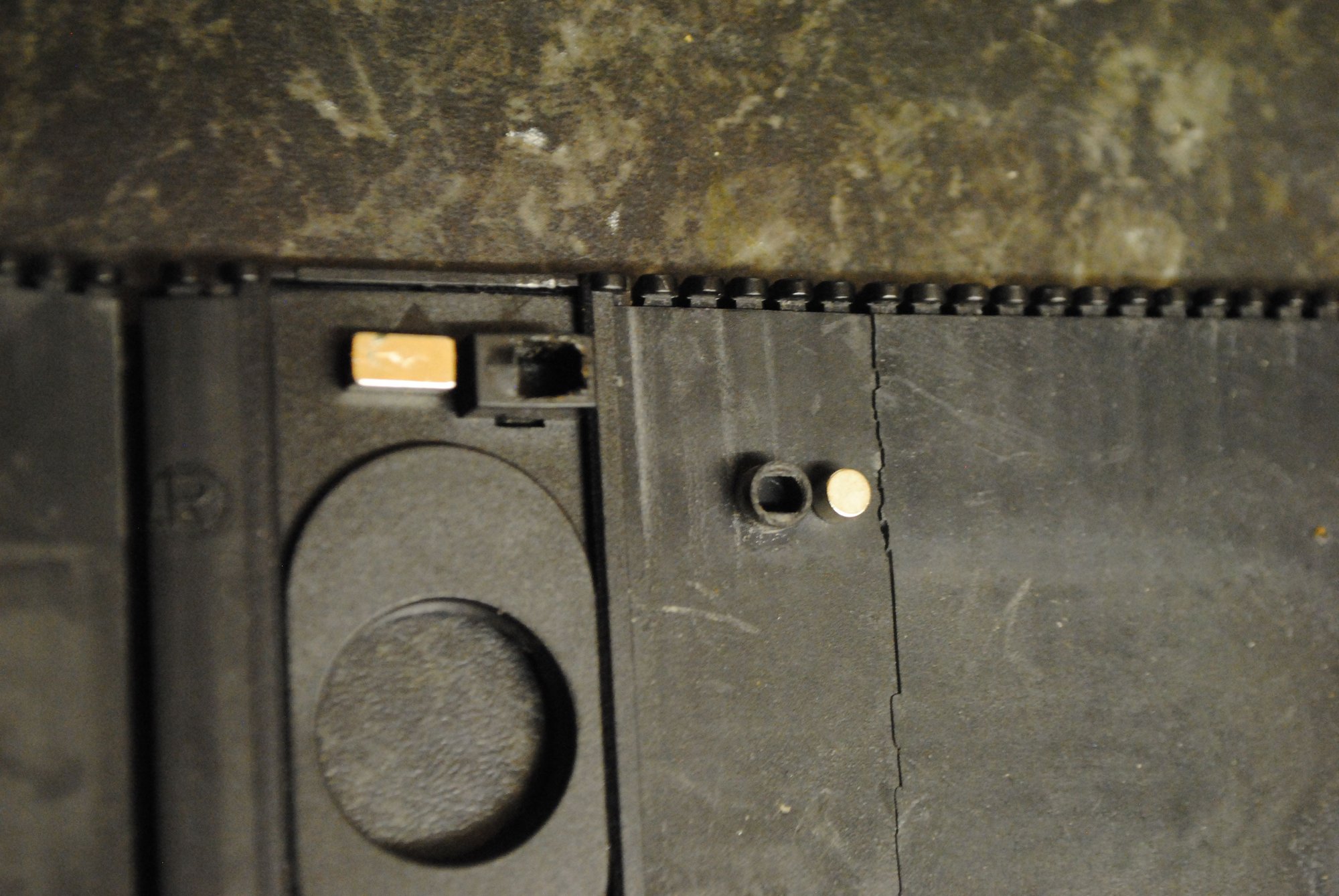

Make sure to verify the magnet orientation as per my post #17 above. In your pic the magnet to the left of the shifter hole looks smaller the the OEM one. It may be fine but have a look.
Old Nov 12, 2024 | 09:33 AM
  #42
scrinja's Avatar
Joined: Oct 2024
Posts: 98
From: The Midlands UK and Sierra Blanca
Rep Power: 15
scrinja has much to be proud ofscrinja has much to be proud ofscrinja has much to be proud ofscrinja has much to be proud ofscrinja has much to be proud ofscrinja has much to be proud ofscrinja has much to be proud ofscrinja has much to be proud of
Thanks Bruce for the heads up its in and working Ok ...I was abit concerned but checked out fine im glad to say

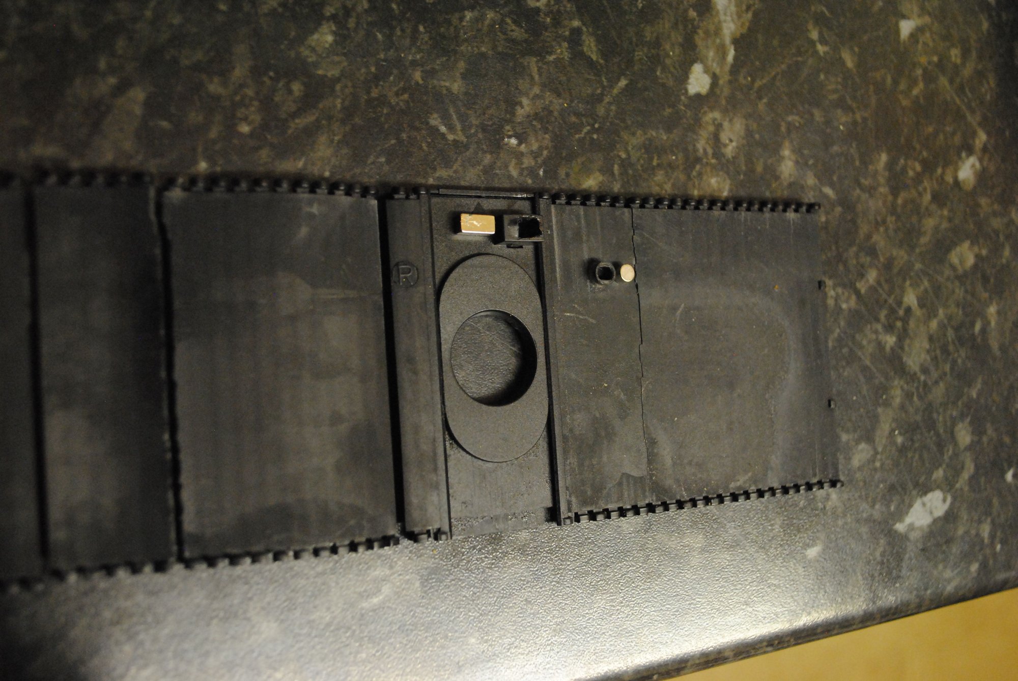

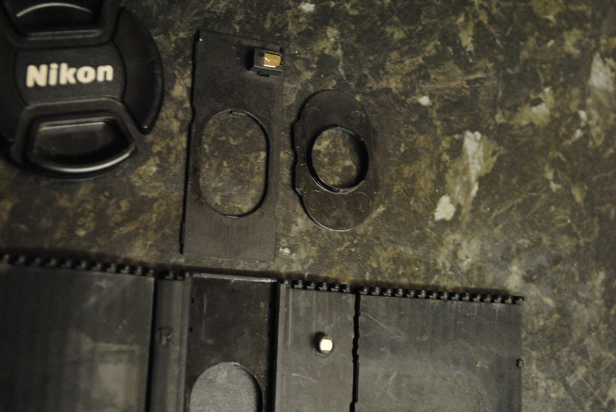

Have a look if interested
Had a Closer look
Original 2005 and so lasted 19 years
I`d Glue it paint it
I`d Glue it and maybe wrap it in Carbon Fibre
Original 2005
Original 2005 Magnets
Pulled apart
Pulled apart
