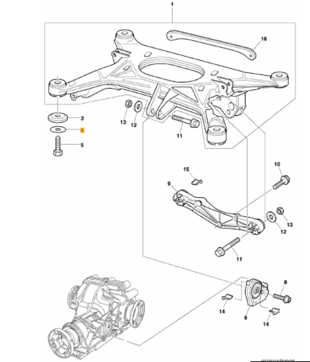

I have listened to the video many times, I even posted on Facebook and got some views, but no answers, what is sticking out to me is the fact you put the car on the lift in drive and had no noise, now to load the CV joints while on the lift in drive, you could apply the brakes lightly to simulate load somewhat, being you have no noise on the lift, I thinking that rules out the brake pads, rotors, driveshaft, etc., BUT, how about the subframe itself, how are the bushings there, your picture shows some piece of one missing, and being you say it is when you are on and off the throttle at very slow speed could it be the subframe shifting....
Just some thoughts.

@Johnny Hotspur GT nice, Tomorrow I will check that bushing..
what is the part missing there? would u please take a picture for me?
Thank you alot

How many km on the Bentley Spur?
While investigating the subframe bushings and the CV axles make a YouTube video going slowly over all the components on the rear of the car. We will look at them carefully.
The reality is there are multiple components that can clunk. Among other components are the sway bar bushings , even the bushing that carries the rear differential. Indeed subframe bushings on German cars are notorious for separating.
