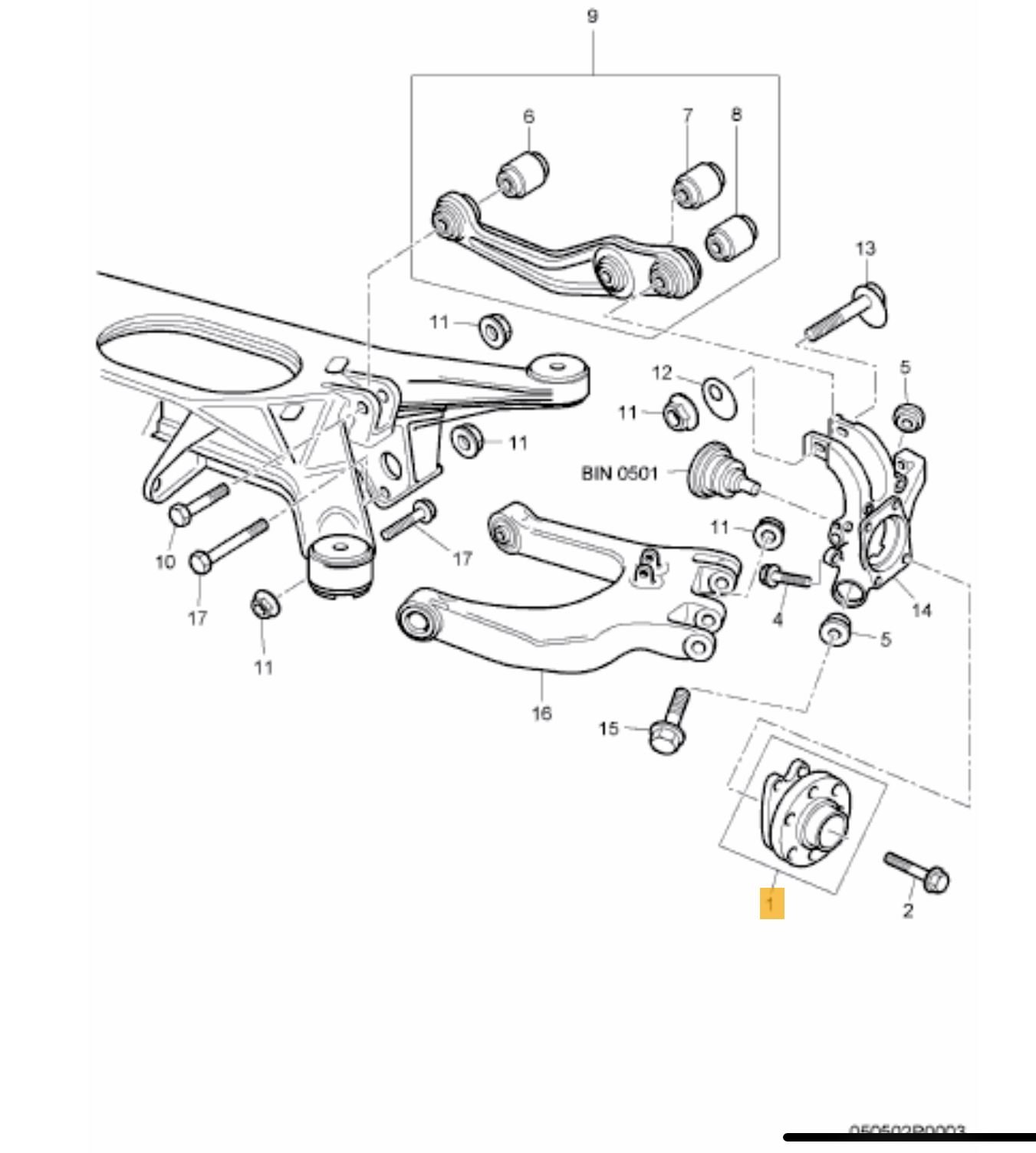

Best to check all the bushings front and rear of the car. Usually when one is bad others are not far behind. Number 6 in the diagram is an example of the type of bushing to check. They vary in diameter all of them should be pried on. When prying on there should be a minimal amount of movement and good resistance. When prying on a bad one it's obvious it's bad.

@1eapplebaum I check up the number 6 & 7 & 8 in rear left, replace it with the Audi one and the problem still the same...

@1eapplebaum today I tried again by changing the whole new arm, Number 9 in the picture but the problem still the same.
