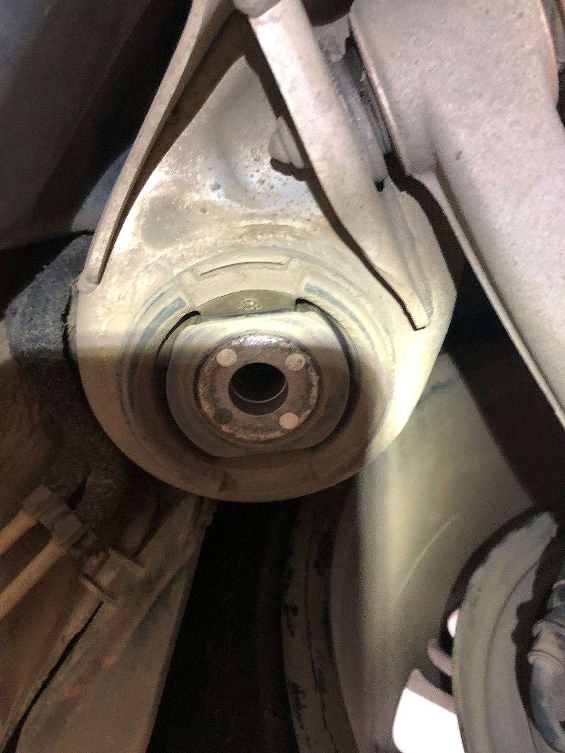

Today I put the car on lift
no clunk at all
here is the video I made
I checked all subframes bushing & the rubble they all seem new

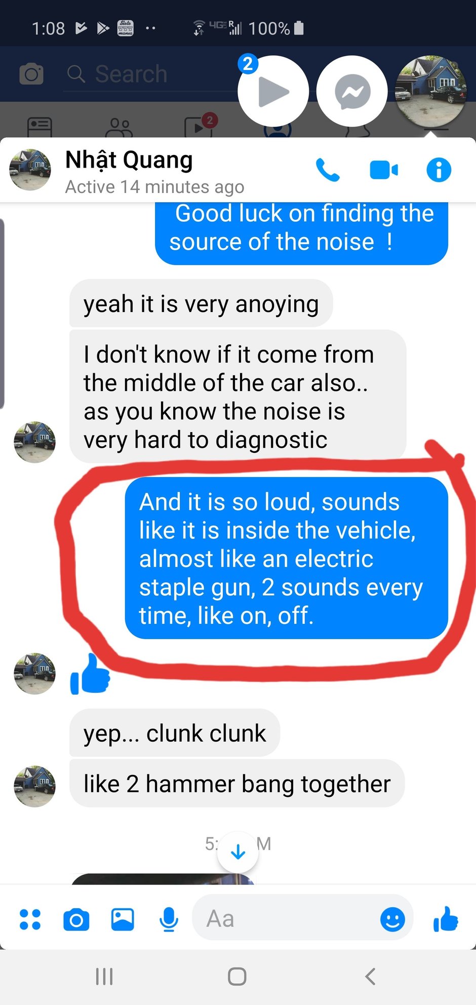

Glad you found the issue, I thought it was too loud to be from outside, and that it sounded electrical and precise, as in the same every time, now to find out why it does it every time you reach 5 MPH, once they are automatically locked, they shouldn't lock everytime you hit the the 5MPH mark every time you pull away from a stop, scan the central convince module and others for any faults.
