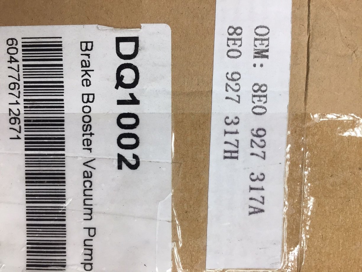

Hey British
Here is the P/N
Sorry for the rotate. This is the box from the last one I replaced. These pumps are all the same number. Just google the part#. Plenty of the VW ones online. I purchased this one for a VW but went into a Bentley. Also, don't worry about the alpha suffix. This one is a 317A, could be any letter and all are the same. Just buy what's least expensive and DO NOT buy a used one! Plenty of those too on Ebay.

Also, if this, in fact, is the vacuum pump making the noise, replacing it with new will make it quieter, but it is not the fix to this problem.
