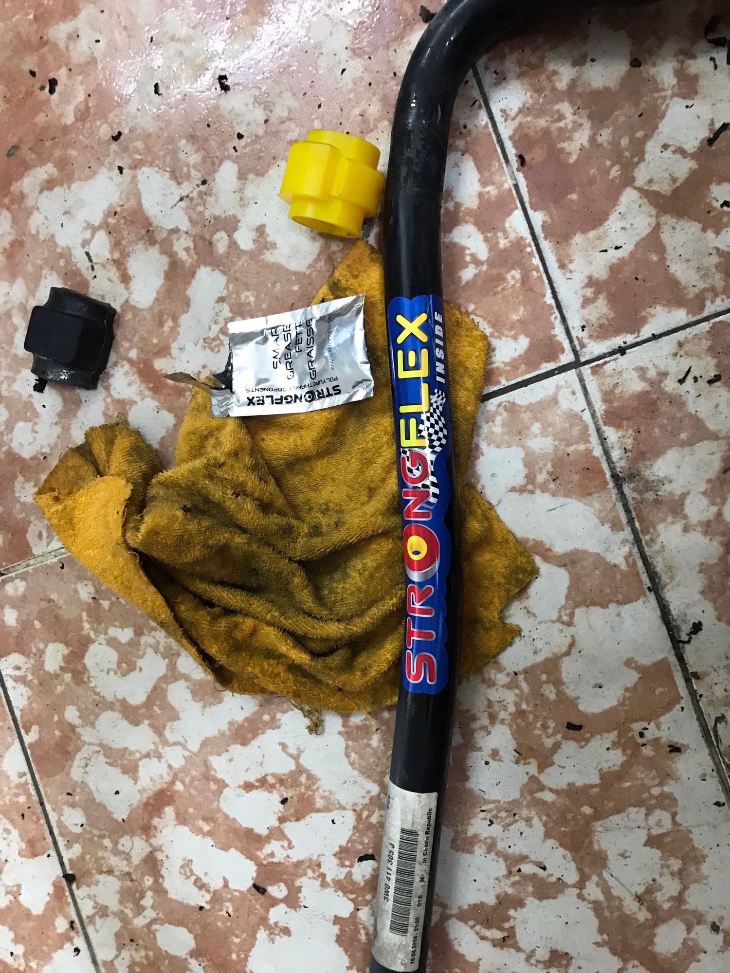

@johny..
I din't replace it yet because mine is looking fine....
here is the picture of mine
and for my swaybar bushing I did replace it with the the one made by polyurethane from Strong flex...
or are there anyway I can check sway bar link? other than looking at it?

Well, my links looked just like yours on my A8L W12, yet they were the cause of my clunking, now some 30K miles later the clunk is back, so I will be checking the links and the SB bushings this time.
Did those hard bushings fit snuggly onto the sway bar without any play ?

@johnny : ok then tomorrow I will remove my sway bar then test drive it short...if the clunking from there then I will let you know..
The bushing fit perfectly and the inside diameter is 31mm.. here is the link
www.strongflexuk.co.uk/front-anti-roll-bar-bush-sport-2233.html#.XbHspi8xWfA

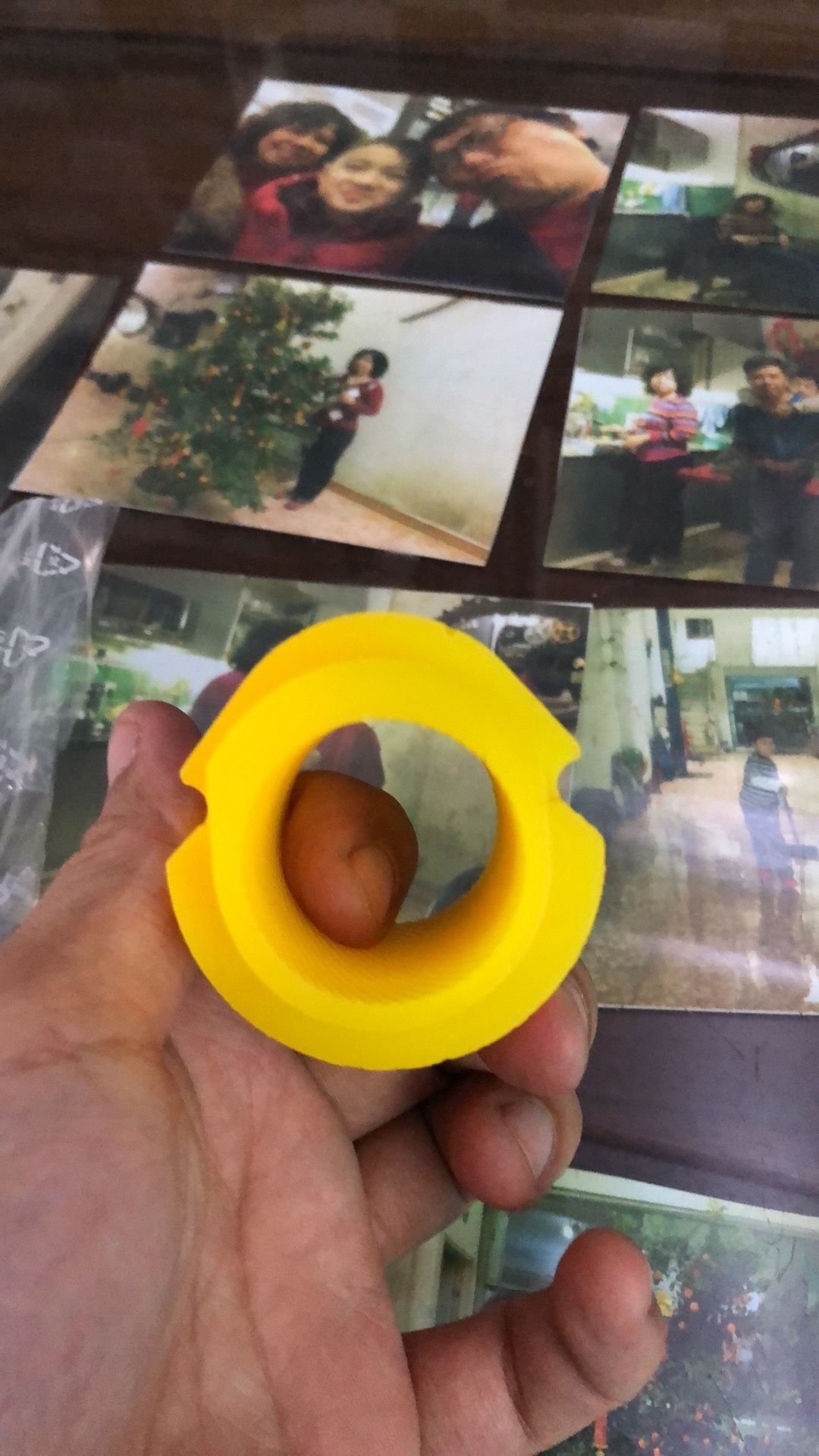

Old Oct 24, 2019 | 12:26 PM
Johnny Hotspur GT's Avatar
Administrator
Joined: Jul 2014
Posts: 3,946
From: Montgomery NJ
Rep Power: 1002
Johnny Hotspur GT Is a GOD !Johnny Hotspur GT Is a GOD !Johnny Hotspur GT Is a GOD !Johnny Hotspur GT Is a GOD !Johnny Hotspur GT Is a GOD !Johnny Hotspur GT Is a GOD !Johnny Hotspur GT Is a GOD !Johnny Hotspur GT Is a GOD !Johnny Hotspur GT Is a GOD !Johnny Hotspur GT Is a GOD !Johnny Hotspur GT Is a GOD !
When they are new, this split is not there.
