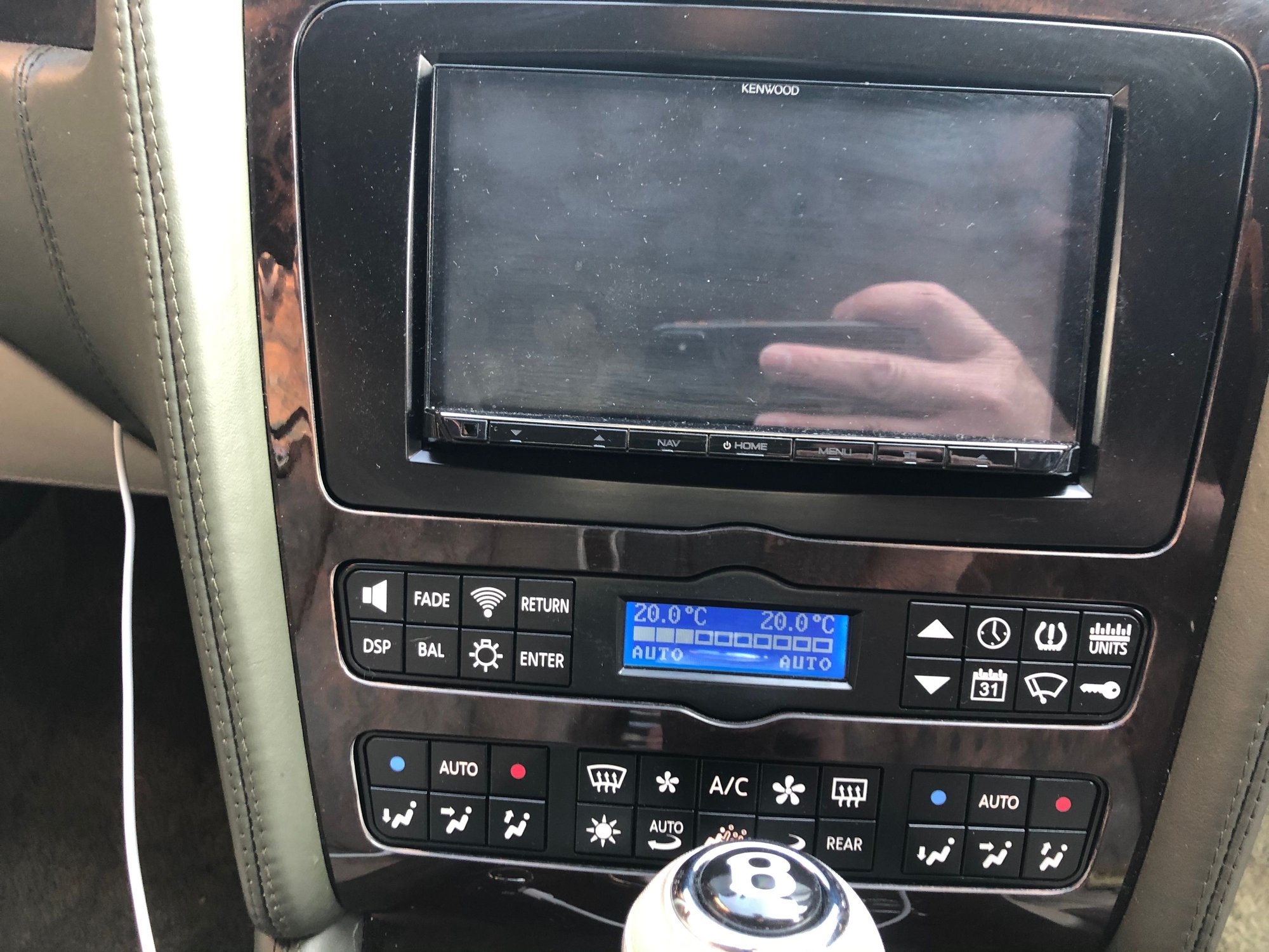

Image of Ben Hur with power off but display active
Hi All I noticed last night when i shut down the engine and opened the car door on my 05 GT (with a ben hur unit fitted in 2018) that whilst the Kenwood stereo shut off the lower display panel with AC fan settings stayed lit up. I locked the car and set the alarm and still it stayed on. I checked it this morning and the red lights on the door tops are flashing and the doors are locked but i can still see the panel is on inside the car?? I also double checked the interior light and it dims and goes out when i close the door. Any ideas??

I will go and take a look at the settings but it was still on after 11 hours last nights and despite checking a few times today it is still on in the dark.

Latest Update. The Unit is "locked" no buttons work and even with the radio on their is no volume. Looks like i will need to do a hard reset by either finding a fuse to remove or disconnecting the battery.

Fuse pulled and all is back to normal now! Everything is set to off on the Ben Hur lighting delay etc so i will leave it like that for now. The only lights that stayed on were the mirror lamps as before. I don't think i have had the headlamp delay since the unit was fitted so suspect it has been off all the time. Any all back to normal for now thank you.

1) no headlight delay as settings are off on the Ben hue light delay.
2) When you switch between lights on and lights off the Ben hur changes. The brightness of the central panel changes high lights off dimmer lights on. Also the ac and auto buttons are bright yellow with lights off. When lights are on the remaining buttons light up white.
If there is a flicker at lights out it is the brightness increase did not really note a flicker.
3) daytime the Ben hur is lit as per lights off in question 2.
I have pics of the display day night mode if the above is not enough
