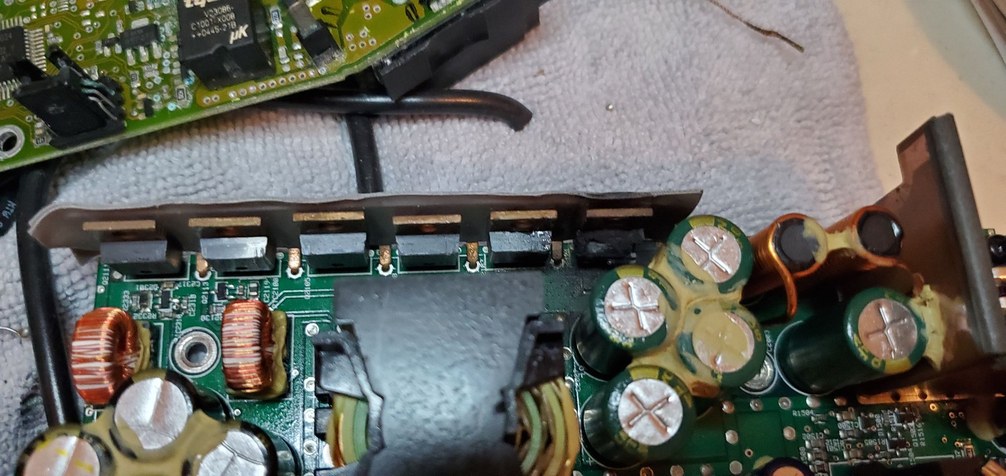

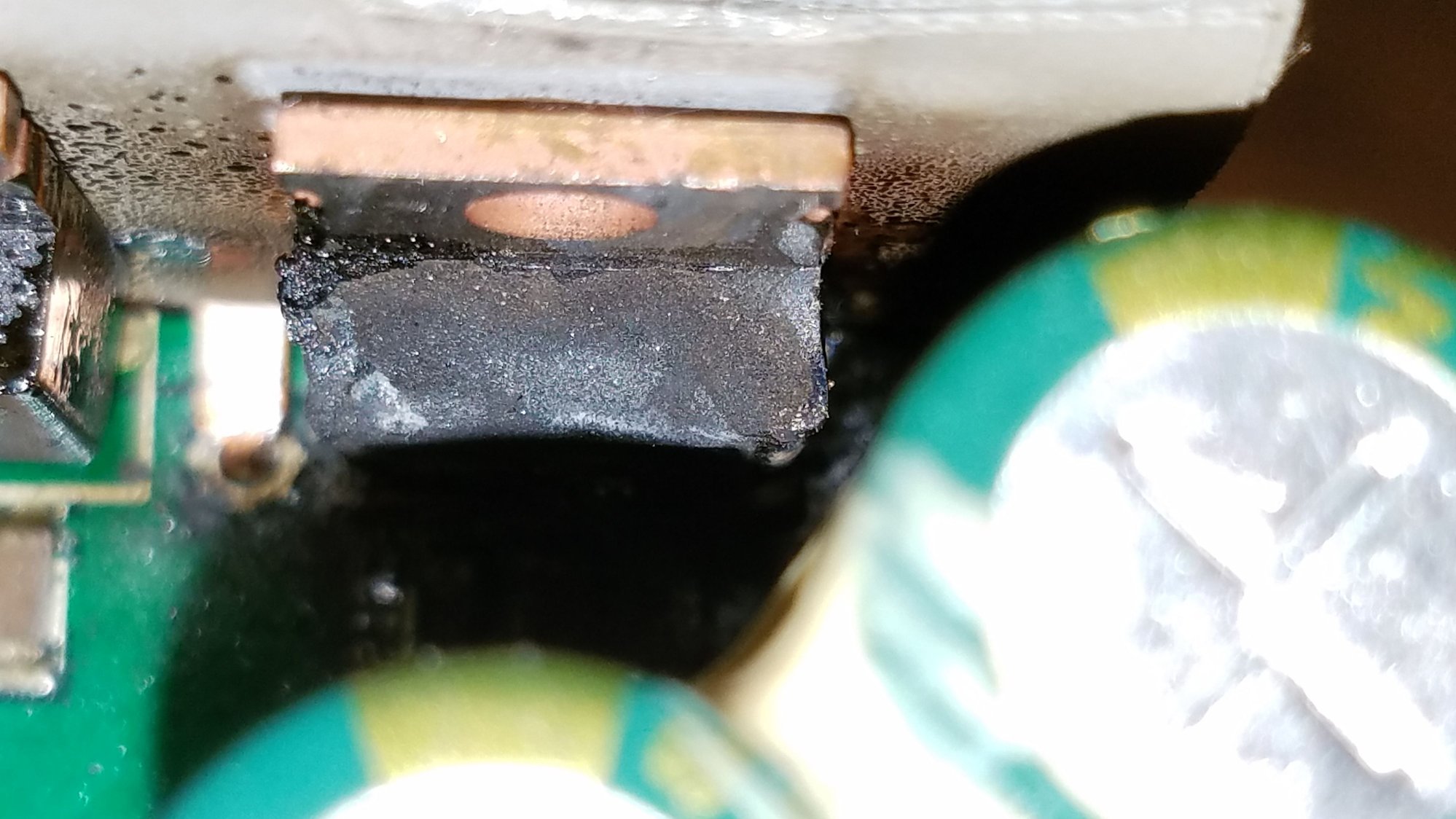

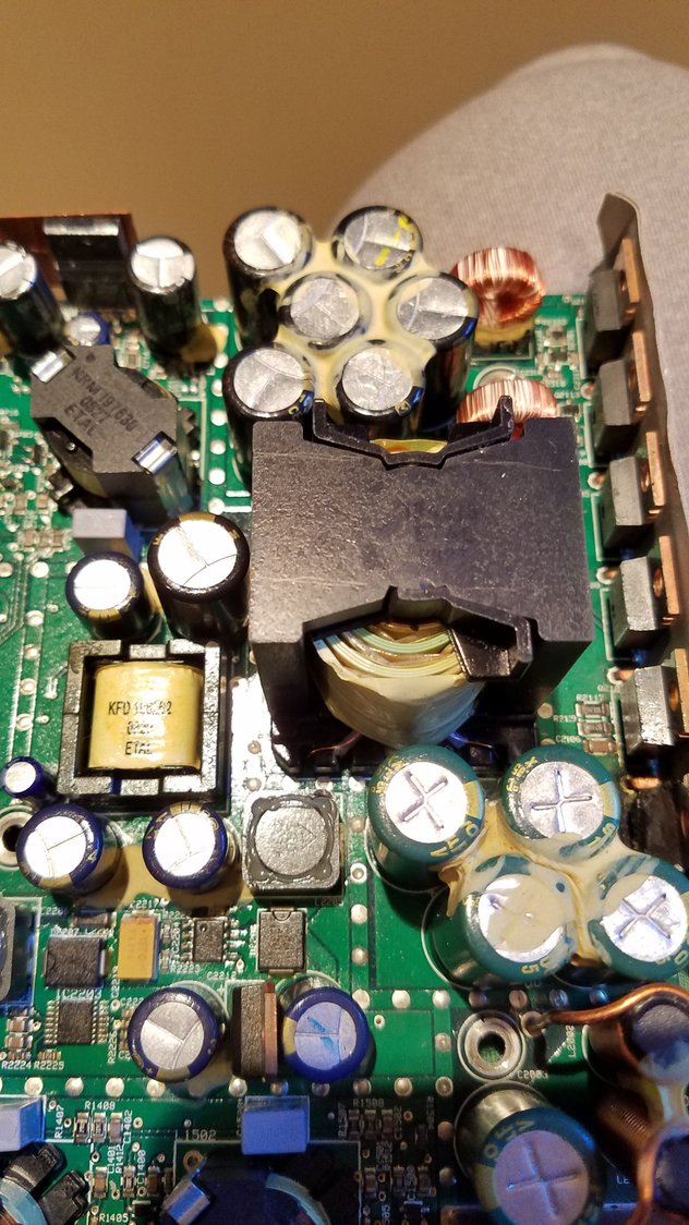

Hello Randy,
That video did miss a few items...
I just want to be sure on one thing as you did not make any comment as to the amp shown in the video, I want to be sure that you did have a NAIM amp as I pictured in previous post.
Also, here are some shots of a 3W0 035 466 D with a blown mosfet or two.
