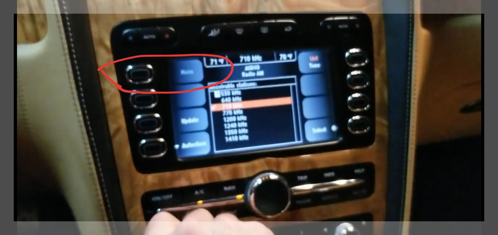

Also, please press the NAIM button and tell or show us what you see.

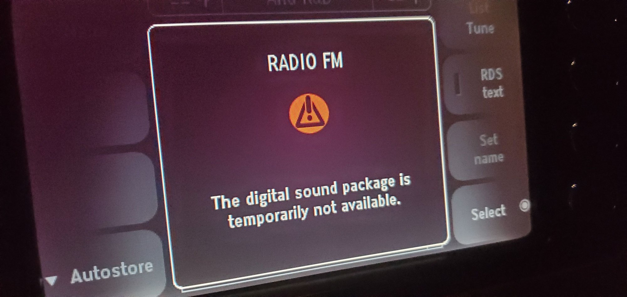

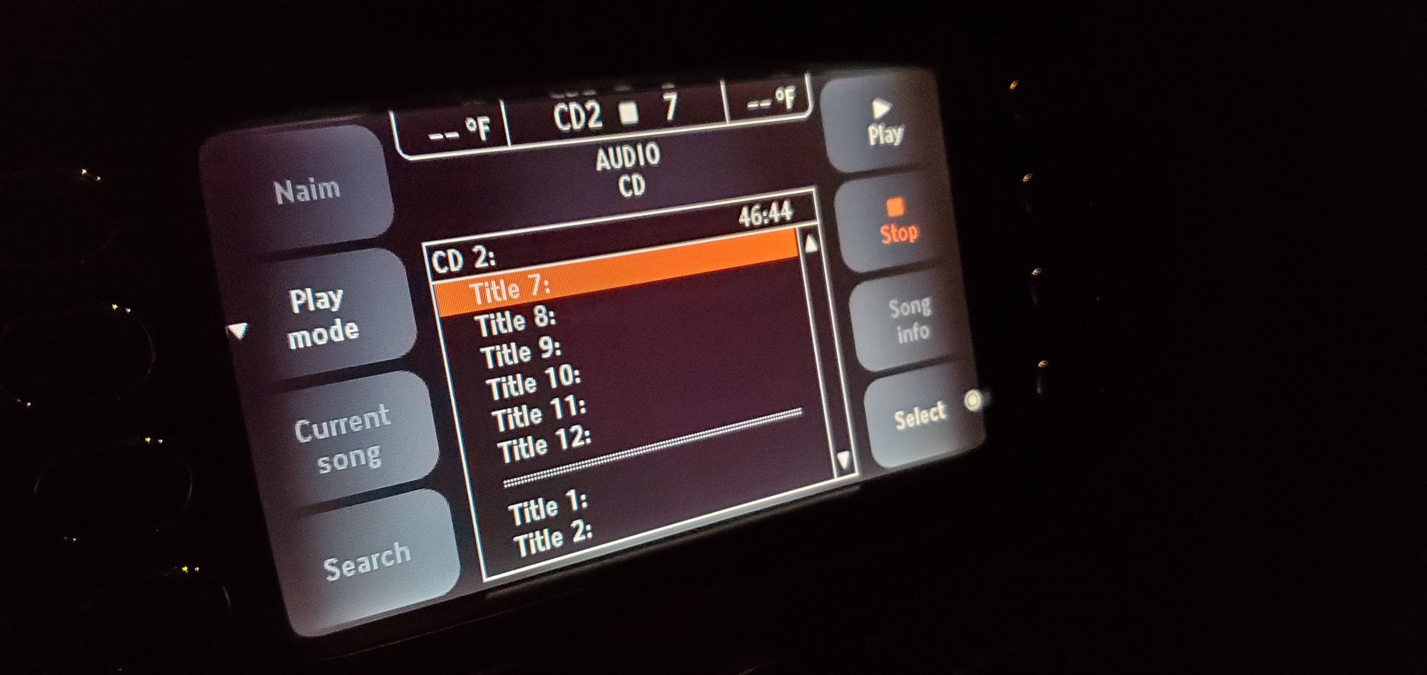

Well Randy,
Sorry to say, that is not a good sign.
That is the message you will see, if, 1) the fuses are blown, 2) the amplifier is unplugged, 3) the amplifier is fried, or 4) the amplifier is missing.
No matter which sound source you pick, when you press the NAIM button it will show not available, below are some pictures of the amplifier and the screen showing the message, and the last picture shows what you should be seeing.
The NAIM amplifier is located on the right side of the trunk behind up behind the starter battery.
