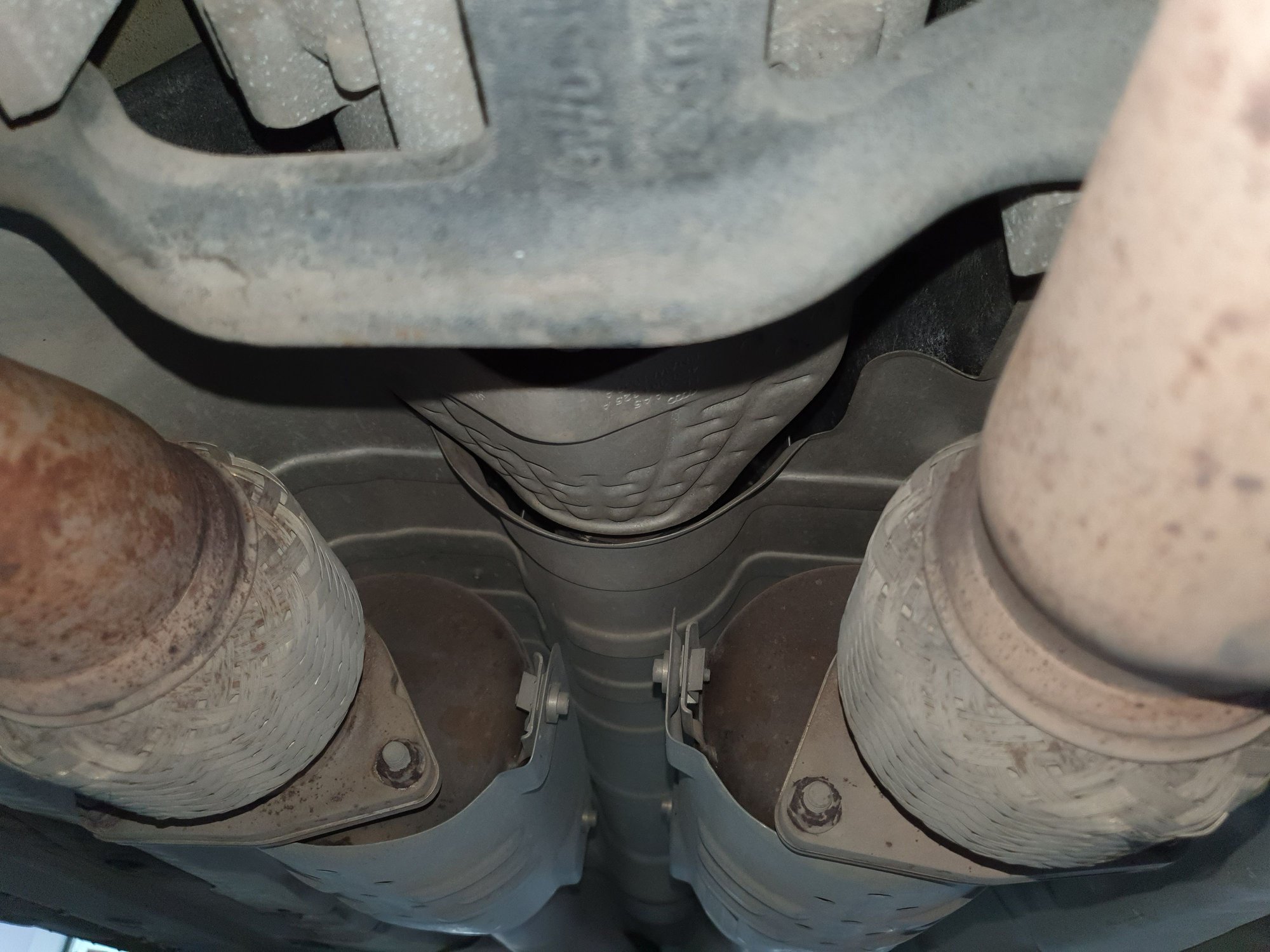

Here are the photos he sent me, I find it's pretty much the same as mine, what do you think ?
I know him.... LOL
Yes, they look the same, he has two CATS there, next would be to drop your pipes to see if the owner in the US gutted the secondary cats as they are not need to pass emissions..
Get some sleep, talk tomorrow.
Johnny

My friend confirmed his Speed was imported from US, too. So basically his exhaust and mine should be the same, right?
I will check on mine to see whether the secondary cats still there 😁😁😁 but do you think this part help to reduce the sound?

Today I have a chance to take photo of my exhaust again. I also check the flap and it opens all the time now. I guess there is something wrong with the flap. My BMW 760Li has the flap close most of the time, and open only on sport mode with hard acceleration.
