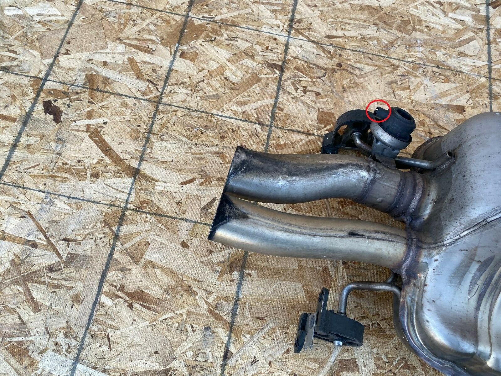

Are the exhaust valves / dampeners connected at both the left and right mufflers ?
Thanks a lot! I'll check this right away
I check and both are connected, and from the pipes I can see it open when the engine is off, and close at warm iddle. The pipe is very loud, there is no different between sport mode and normal mode 😭

Something is wrong with this picture, the flap is open, there should only be one flap for each side of the vehicle, not 4 flaps in total if that is in-fact what you are saying by "one is open and one is closed", one is a straight pipe and the other is flapped, the flap should be closed at warm idle, opens under hard acceleration or sport mode.
Was the engine running at the time of picture taking ?
Johnny
Originally Posted by TungNguyen
I check and both are connected, and from the pipes I can see one is close, one is open, on both side. The pipe is very loud, there is no different between sport mode and normal mode 😭

Your picture that I marked with the green star, is not closed, that pipe is a baffled piece, what is shown in your picture is the other end of that pipe, as in the other end of the muffler.
Hi Johnny,
Thanks for your help. You are right, the photo was taken when the engine is off. I will take photo when the engine is on warm idle and post here tomorrow.

No, we need to see that the flaps are physically closing when they should .
So let's wait for your next picture.

Vacuum .
They are spring loaded open Vac closes them .
All quad pipe high end set up the outside pair of the quad is vacuum valved . It’s a generic exhaust system not Bentley specific .
Ferrari , Maserati , Aston , Alfa , M series BMW , Merc AMG etc etc .Bentleys quad are disguised by the oval tail pipe trim .
To permanently keep the outer pair open + associated noise if you wish , you pull off the Vac pipe and block it off .....self taper or golf T .This fools the engine management and no CEL s .
So when you initially start when cold , it’s open hence the growl until there’s sufficient Vac to pull it shut .
Sport mode or hard acceleration cuts the Vac .....it springs open = the noise .

How ever having said what I said in post #14 the pics look odd as there appears a valve in each pipe .
Inner is open , outer closed , which is normal if the engine is off .
So for the “ sport “ / loud sound to seemingly be there all the time there must be a fault that opens the outer ( and the inner in this case ) all the time .
So no vacuum or insufficient vacuum is eaching the outer valve to suck it close and it’s prematurely opening = loud noise .......This needs investigating.
