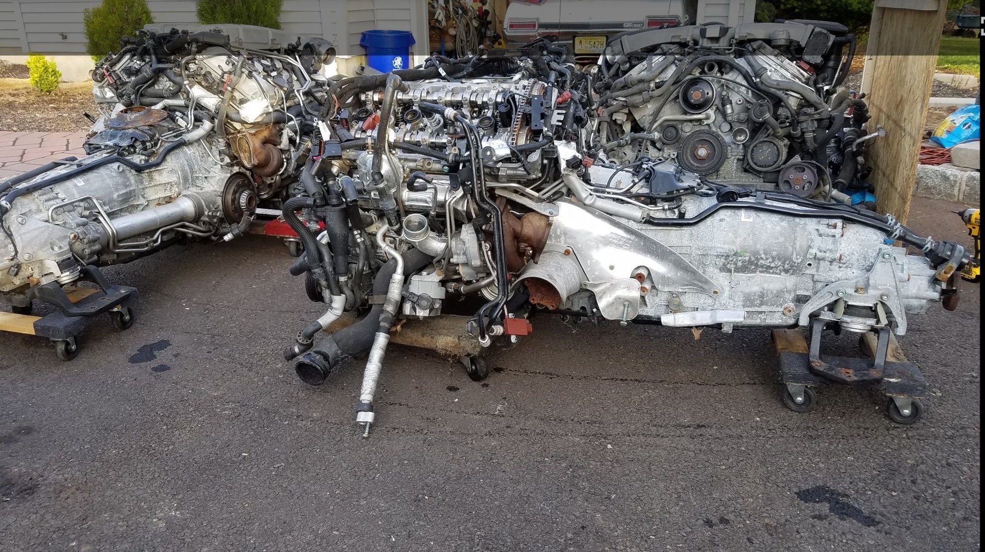

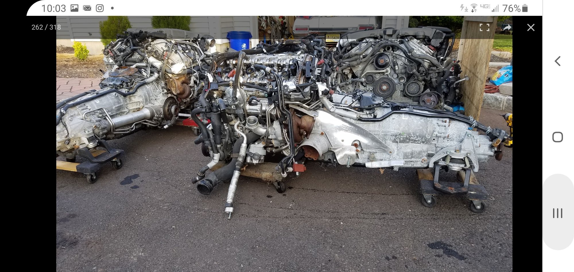

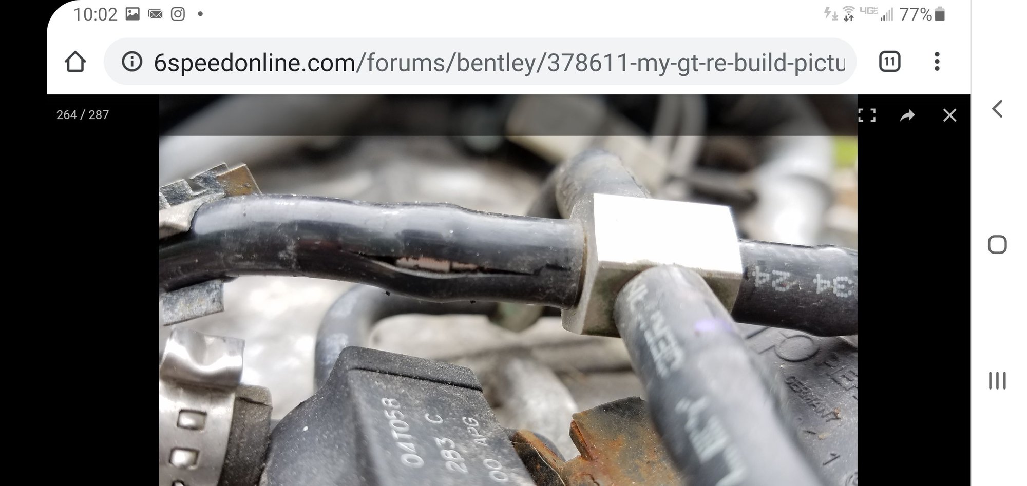

As far as looking at the lines, you may be able to use a telescopic mirror or a camera probe to look at certain areas, but, the most important part on top of the transmission is the connection areas and they are covered by a black plastic shield, so kind of tough to get at, if the seller can not confirm that this well known problem has been resolved with new metal lines, or at least all of the connector points repaired with hose and proper clamps, I would be asking that to be taken into consideration of the selling price, I believe that you are in Chicago, so if you would pinpoint your area, then any members here reading this may have a good shop reference for the job, which I have seen done for between $3500-$4500, so if you can negotiate that into the price and bank it for when needed, that's one way to look at it.
I will say that some members here with 05's have never had an issue with the lines, others have, and my 2005 with only 8840 miles had every connection where the plastic tube meets a ribbed/flared metal or plastic tee, or straight connection at the intake, each piece is split, you can see that in my rebuild thread, and in my video or the firewall vacuum lines runs.
And yes, I agree, the smoke test will just tell you if you have a problem at the moment, not if any upgrade was done.
If you are hands on, they are plenty of us here to guide you.
Here are some pictures of my 8840 mile lines, also you can see the black plastic shield on the engine/trans to the right.
Johnny
