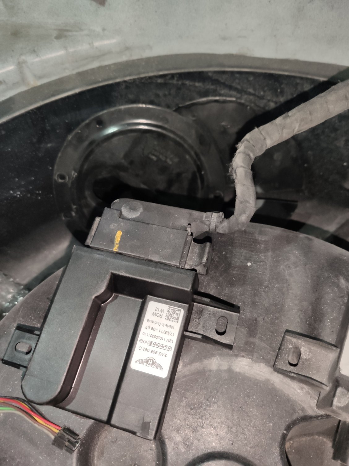

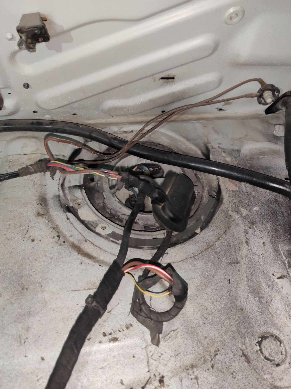

thank you, I will try to see if it can be useful for me. The main issue is that a cable and the left delivery unit is really missing and I don't know how things should be. I don't know if it's been cut for some reason from the main central harness or if it's a standalone cable. It's really a mess there
All I phisicaly see is a connector male on the left cover over the pump with 4 pins attached to nothing
Forgot to mention, it's a LHD car
Left one
Right one (ending to a delivery unit)
