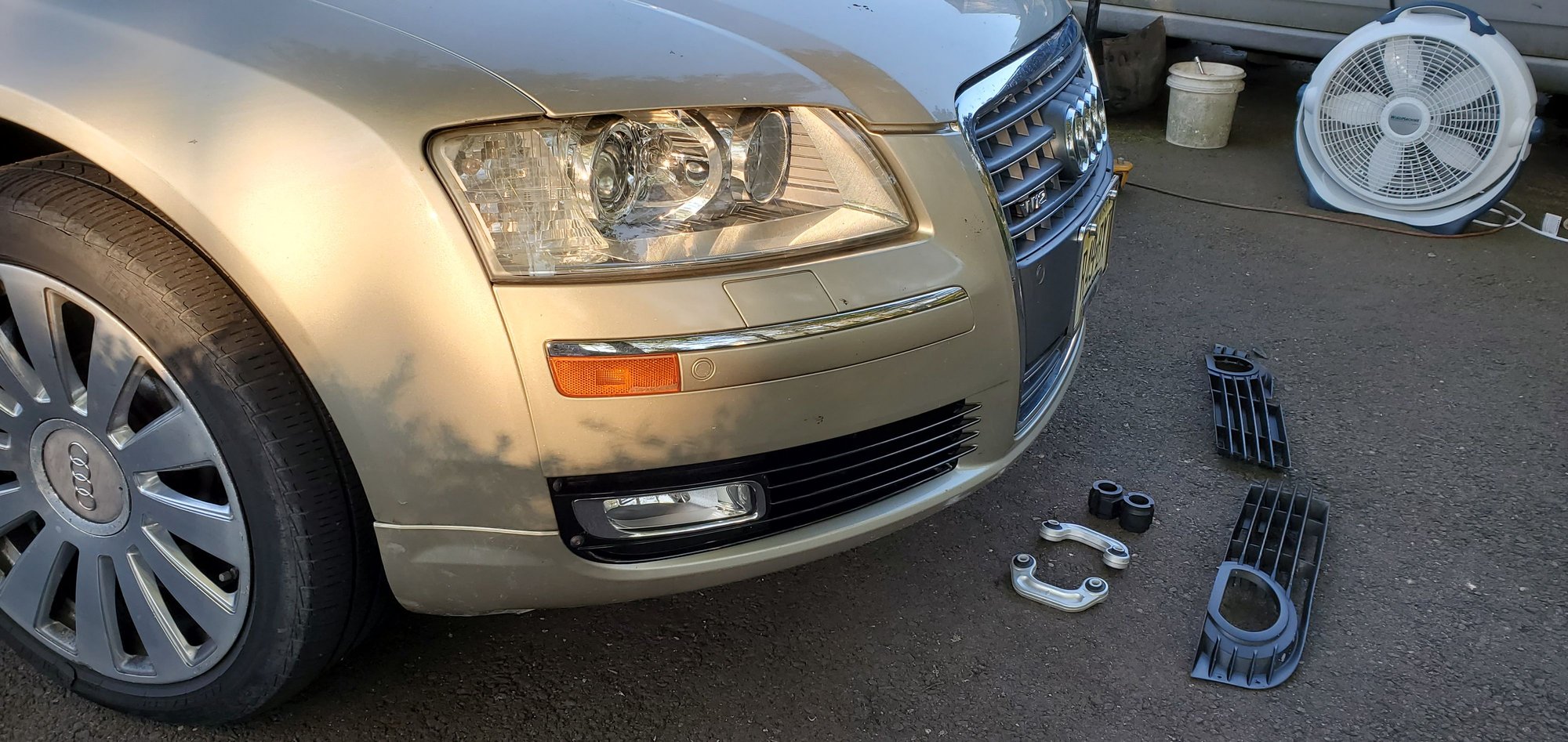

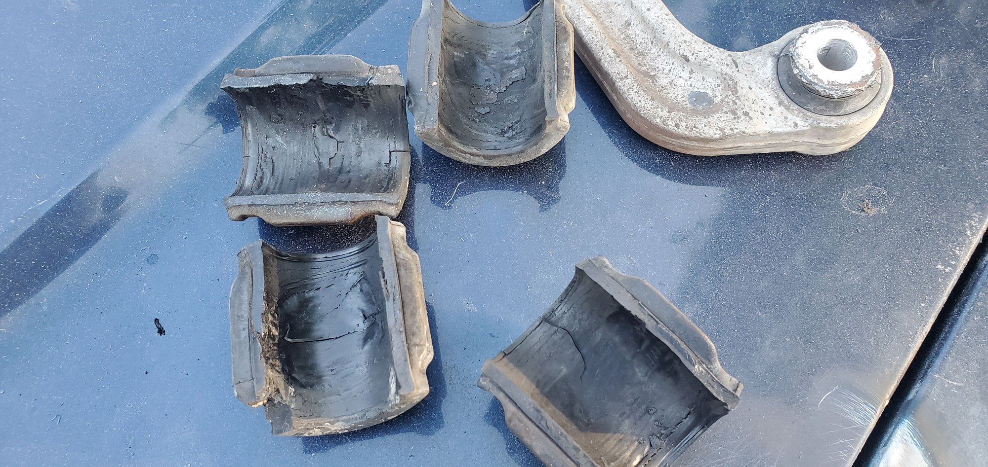

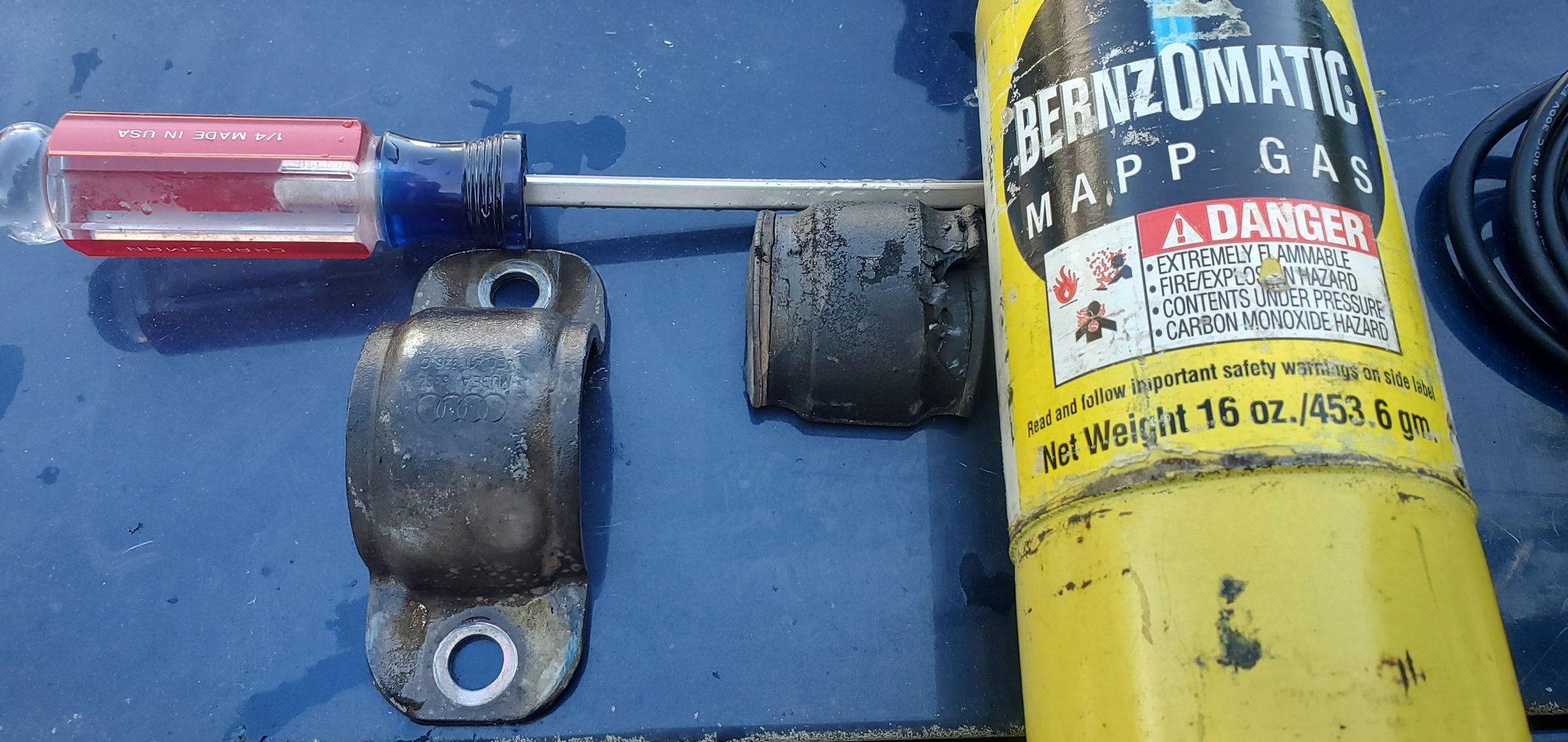

As far as the swaybar bushings, as DG stated, they are known as to be one piece with the swaybar, so is as the same on my A8L W12, But I found on Audiworld the replacement size to just replace the bushings instead of the whole bar setup which would be a waste of a good bar, I am on holiday so I do not have the information with me, but do some research as to the diameter size of the swaybar for the Bentley.
I just swapped out the bushings on the A8L and it works as it should.
Johnny
