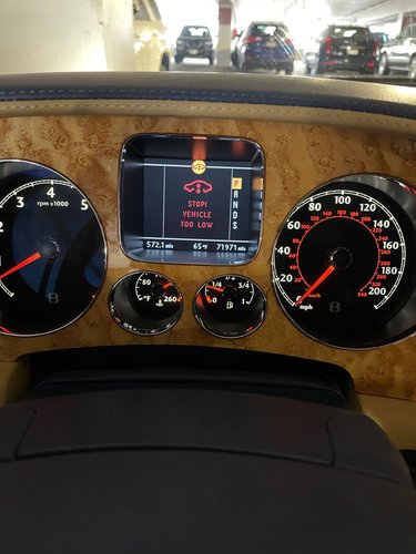

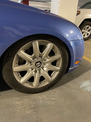

The car is already at my independent's, but I was looking for some Johnny help or anyone else. Valet drove it up, it had "Too Low" red warning on the dash. Suspension is low over the tires.
Checked the Ross-Tech scanner, only code was "lower limit exceeded". I tried to put it in jack mode but got interrupted and I may have let up on the switches prior to it entering jack mode, or it wouldn't do it at all.
The car hasn't been jacked, it was just parked in a parking garage. I got the warning, then hooked up the Ross Tech, cleared it, then it didn't come back for my drive home. Two days later, the valet brings it up and the warning is back and the front suspension is collapsed on the front wheels. I got it (carefully) to the independent and told them to try jack mode first, (from this forum) but I don't think that's the long-term solution.
Any thoughts? Why do I only have a simple error code?

Blown out strut, no surprise. Changing the control arm bushings too.

Replaced first air strut, it was blown apart. Came back to get the car, it was collapsed again. They found a leak in the second unit, we spent some time trying to figure out why the second one would start leaking at the exact same time.
Independant offered his thoughts, with the first blown out, we over-pressured the second unit. Johnny, any thoughts?
We changed out all of the control arm bushings, that made the ride slightly better, only marginal, but it does feel a little nicer over the road. Maybe that was the two new struts as well.
Apparently the struts had been replaced previously, they weren't OEM.
