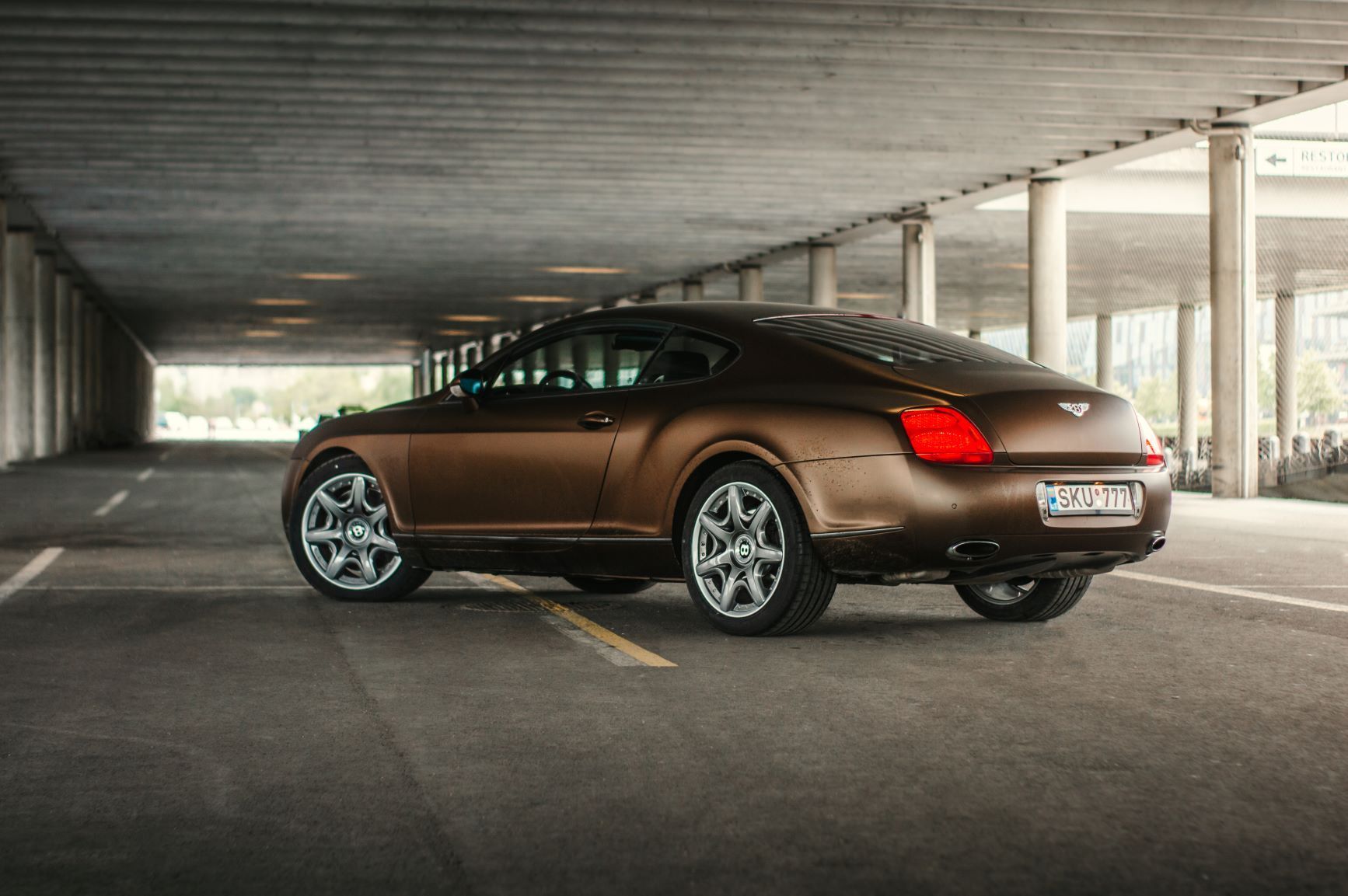

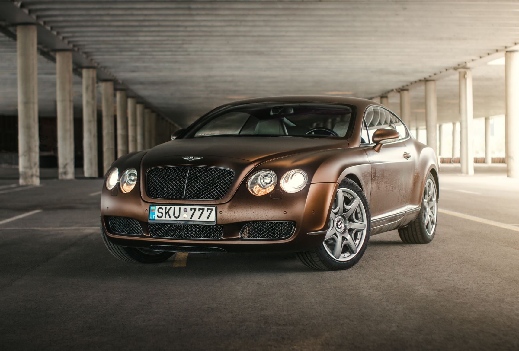

It fits 275/40R20 goes on Bentley Continental Gt 2005, no problems!

Thanks man ), yes, I was aiming for comfort ride, and its is noticeable difference between 275/35 and 275/40, softer on potholes and road imperfections. Colour custom from VAG code, but without polish
