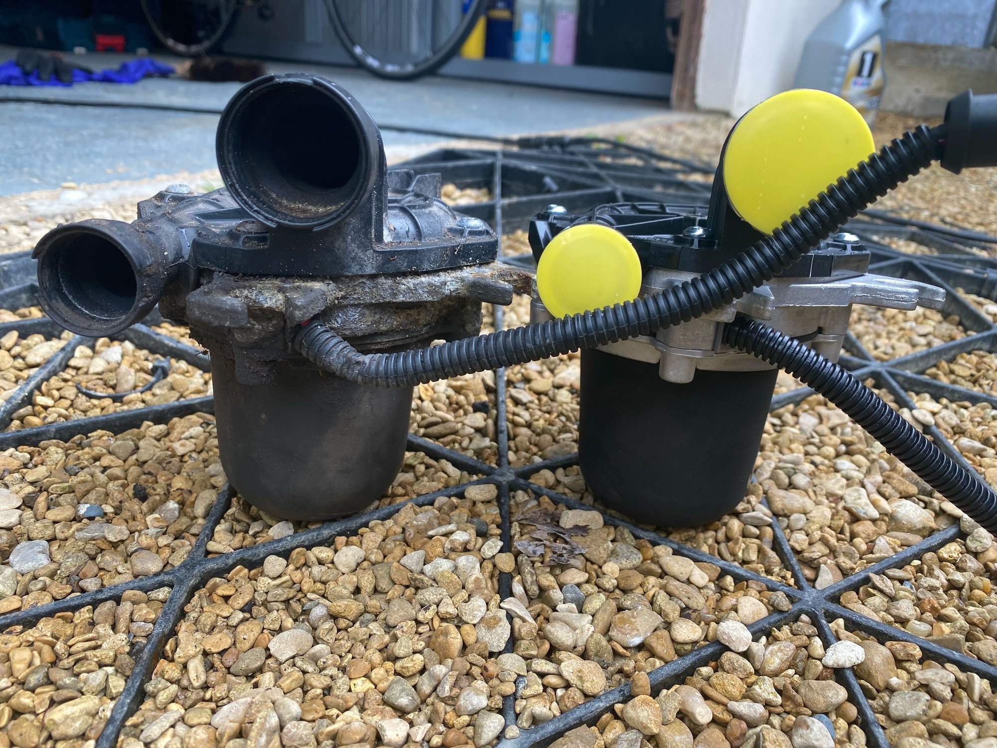

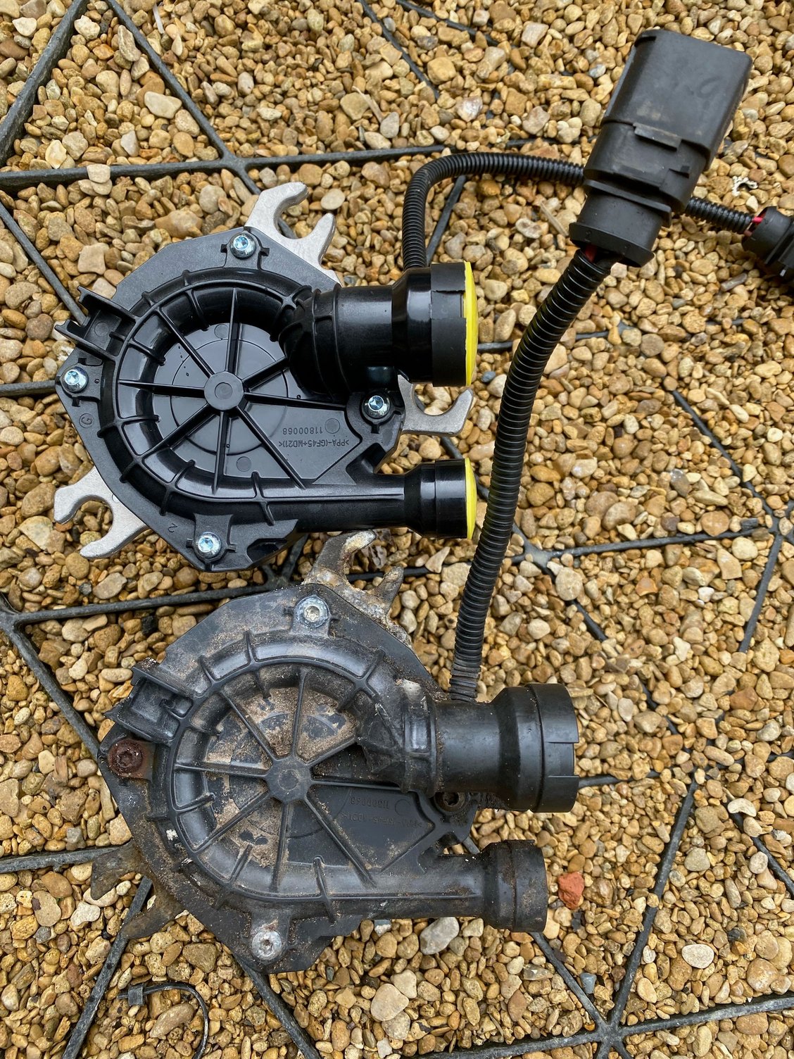

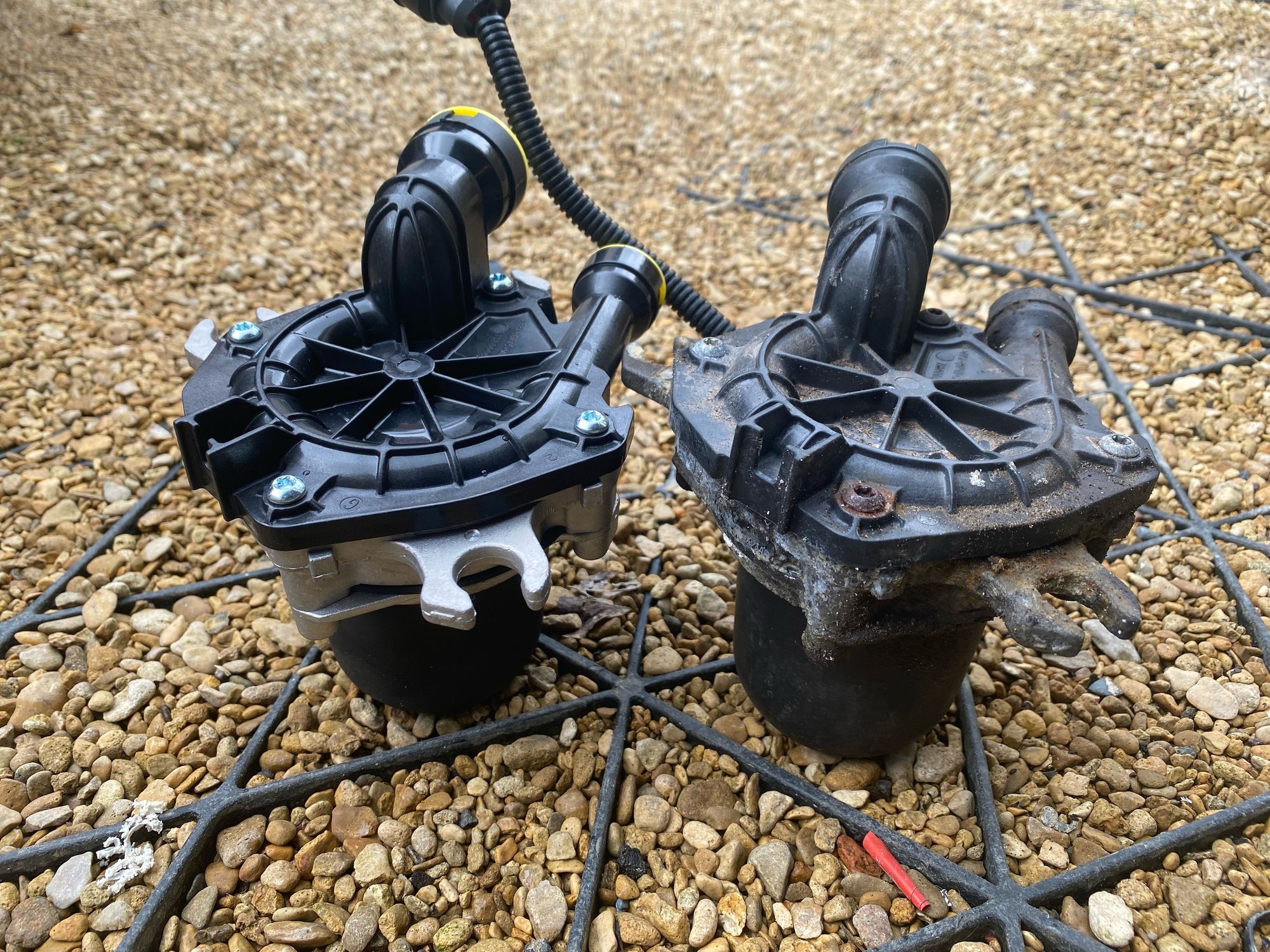

this is my old pump ( removed) next to the replacement ' cheaper ' unit .... make your own minds up ,
there seems to be a really minor difference in a small area of the plastic top cap , nothing that negates fitting correctly , and possible just a generational production difference, but for the price, i am not worried in the slightest , these were a direct swap for the existing units, the new ones do come with a studded rubber mount installation pack , the Bentley is mounted on full rubber mounts, nothing wrong with my mounts so i used the originals , just my choice

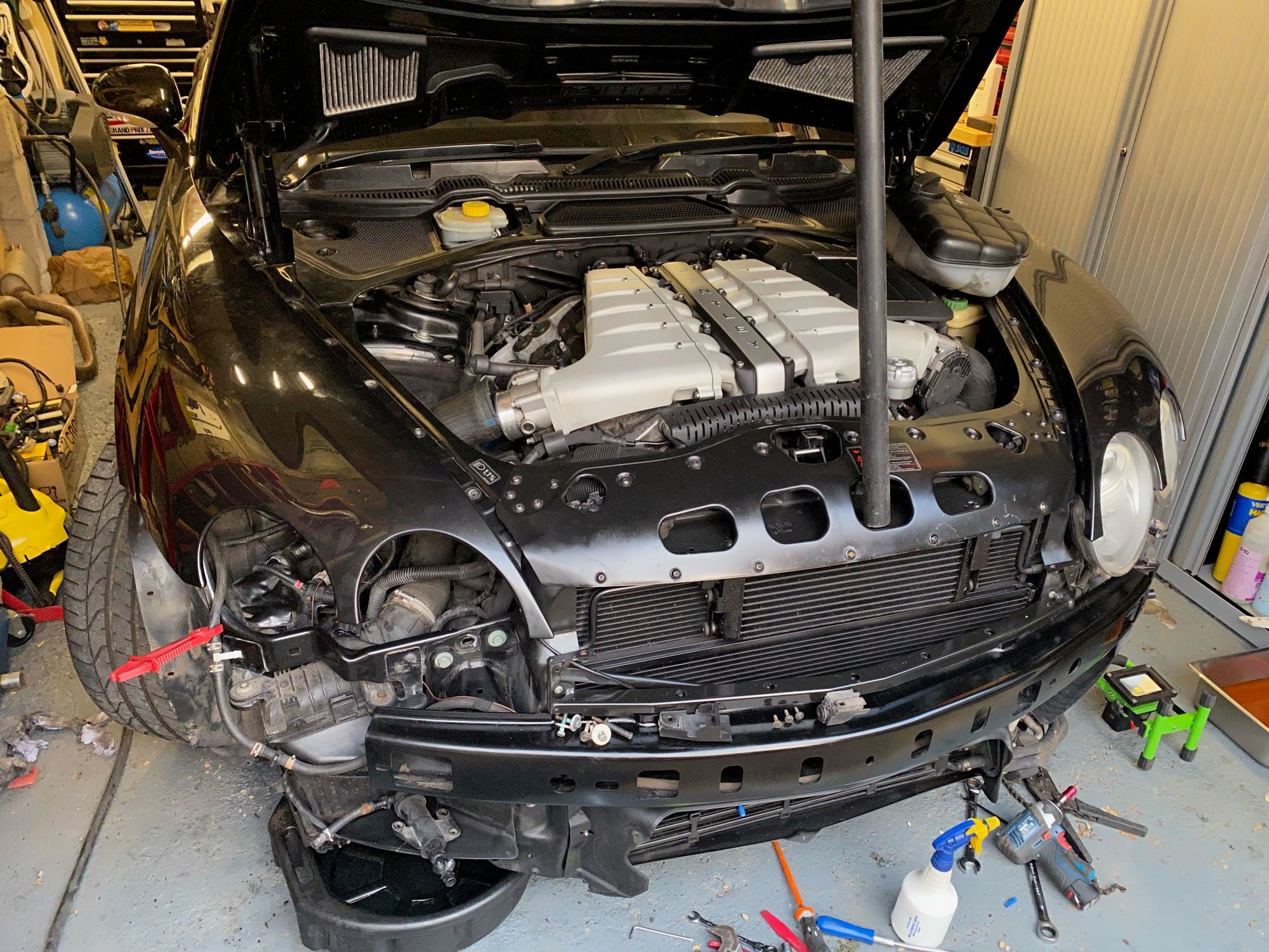

i must resist taking my cars apart...but i just cant help it, lol ( picture of another project involving the headlights....)
