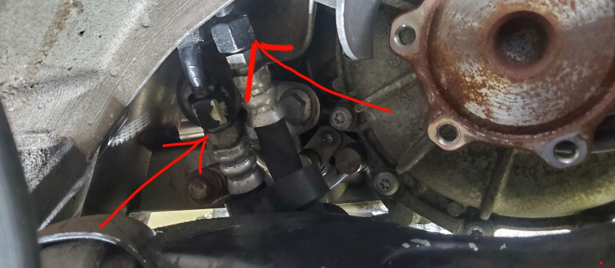

It’s transmission oil. And it leaks underneath this black plate and from the shown pipes connected to the gearbox.

Being that the engine was out previously, be sure to check the two transmission cooler lines on the passenger side by the axle output shaft for proper tightness.
Kilog
That black plate is supposed to have two seals (one for each pipe) which fit into recesses in the transmission casing.
The VW part number is 4E0 317 029 or ZF refer to it as 0501 319 430.
In your photograph it looks as though the pipes are not properly inserted into the thermostat housing.
The pipes are retained by the mounting screw pulling the thermostat housing, so that the o-ring is trapped by the pipe flange.
For this to happen the flange on the pipe must be inside the thermostat housing recess.
Unfortunately neither VW nor ZF list the o-ring part number.
Currently the flanges are no longer visible as before, but there is still a residual leak which causes drip. I think the oil seals are damaged, as this is a one-time fitment item. I'm not sure it was changed when the engine was put back in place. I will order it with the battery cable and the camshaft sensor.
