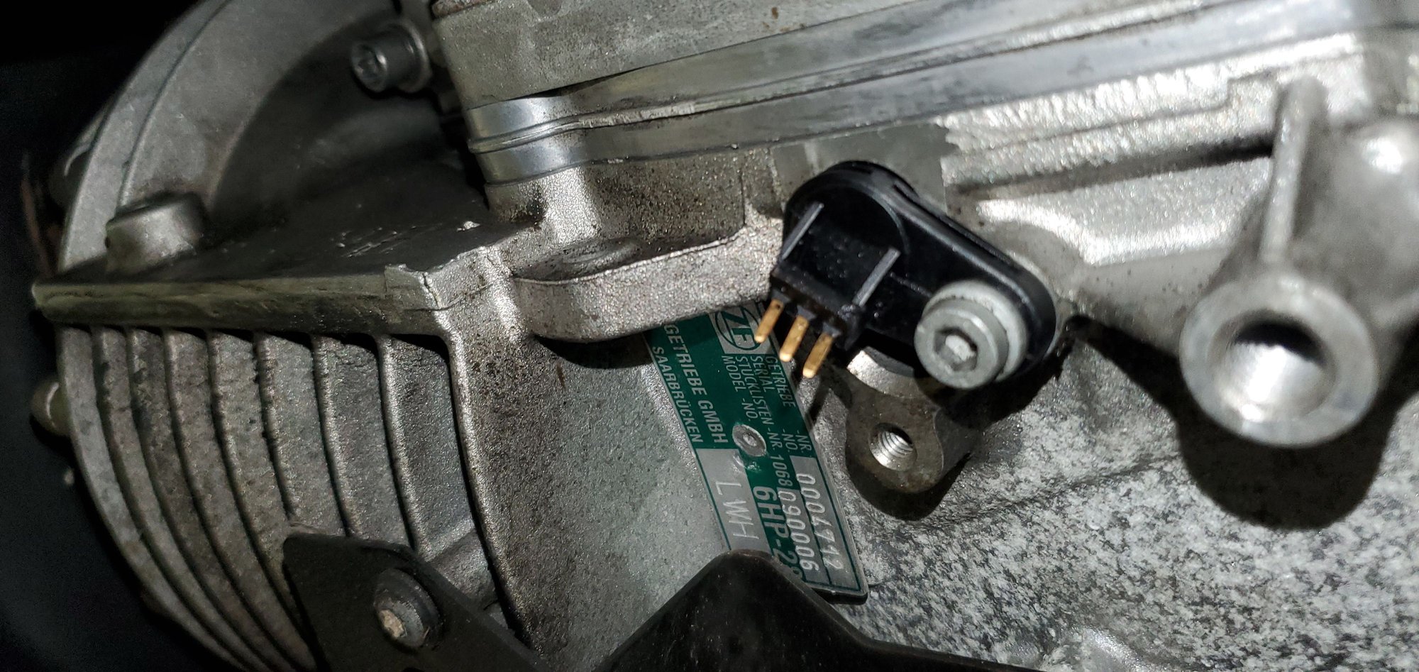

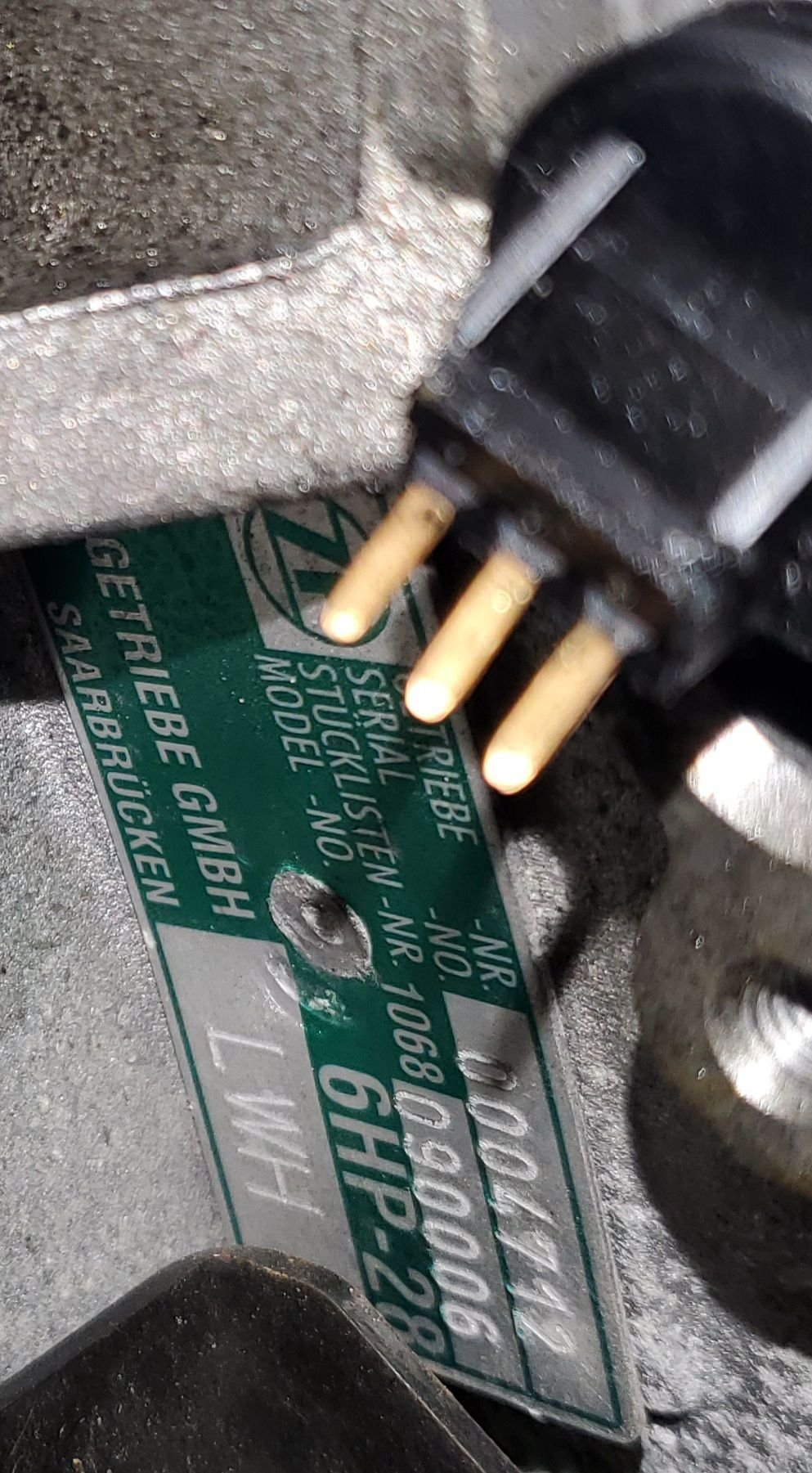

@kilog ,
Right off the bat, 100% the G28 engine speed sensor will NOT allow the engine to fire over (run), it will just crank, been there in my rebuild, so check the plug and wiring at the sensor, it is located at 6 o'clock on the transmission bell housing.
I am confused by your comment as to the starter only cranking from the house (left) battery, for that to happen I believe that your parallel switch would have to be on every time, therefore sending the positive from the house battery to the starter battery positive cable, which then would make me think that you should check the starter batteries positive cable connection and it's pyrotechnic connection.
Please clarify that if you push the head of the relay, does the starter crank every time, and or does the starter only crank by way of pushing the relay head when the key is in the ignition and turned on ?
Has anyone turned the key to the left to activate emergency start aka parallel power mode ?
But FIRST, check out the G28 on the transmission !
Johnny

​​Answer to a question yesterday:
Does the starter only crank by way of pushing the relay head when the key is in the ignition and turned on ?
Answer: Key inserted or not by pushing the relay head i can crank the car.
The G28 fault has disappear. In fact the sensor connector was not well inserted.
Now that it is correctly inserted the fault has disappear as you can find in the attach diag report.
Regards

Hello @kilog ,
Yes, I see the the yellow connector is broken off of the positive terminal, but that is not your issue, my pyrotechnic connection was blown also in my flood car, they actually blow apart, and as I can see by your picture, yours blew apart and someone used bailing wire to tie it back together, take that back apart and clean it good, even inside the hole that the nipple if the cable end slides into, post pictures of it separated if you would, I cleaned mine put it together and crimped the larger outer portion to get a good connection before I found replacement, which I have not installed as of yet, and my vehicle runs and drives with the expired Pyro charge.
How is the engine speed sensor, get to that first, because you have the engine cranking, so I would get on the speed sensor and take care of this cable afterwards, meaning don't wait to find a replacement, make a connection and check the speed sensor.
I want to hear this engine run!!
Johnny

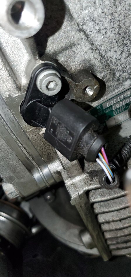

Answer: Key inserted or not by pushing the relay head i can crank the car even with the negative cable disconnected from main battery I can still crank the car by pushing the head of starting relay 433.
The G28 fault had disappear. In fact the sensor connector was not well inserted.
Now that it is correctly inserted the fault has disappear in the former diag.
But now it is back again.
I have to dismount it and check it out
Regards

@kilog ,
I would get a new speed sensor, it's not just the connection, the sensor itself goes bad, you may want to pull it out and make sure that it is clean, no oily gunk build up.
Johnny

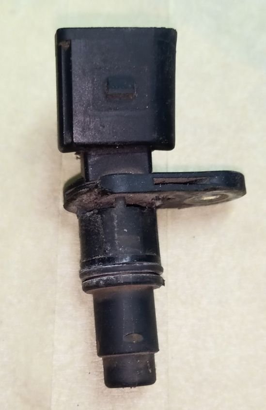

I pulled out the speed sensor I discovered it dry and a bit dirty. i cleaned it plugged it back and connect its connector firmly. Then I went back and crank the car imagine what happened...
it fires up!!!
Hurray!!!
Here attached is the last diag sessions (no more G28 fault in fact, and the report is shorter too)
Thanks you all...
