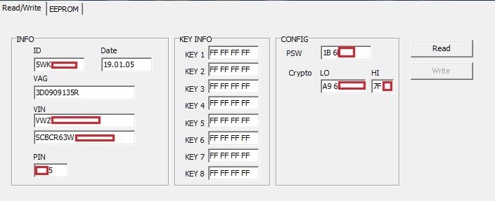

Finally I disconnected the Kessy and unsoldered the 93c86 eeprom.
And guess what I found: NO KEY configured
In the attached picture it is read from Carprog.
Can I program the keys with Effi (ZedBull software) and how?

OK I am in the middle of a job right now, but being that you have the pin/skc code from the KESSY and the 3 original keys to that original KESSY, correct, then you would use the Roas-Tech as I did to re-pair your 3 original keys back to the KESSY module because you now have the Secret key code...
