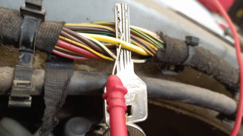

To solve this issue I removed the right wing of the car
then I had to find from the harness where was the wire to the starter solenoid
finally I got it as shown here in this picture.
And than by chance I found it at the feet of the driver on the left side,
Also because I was looking at the best way for the cable to run from the front to the boot, and the harness down the feet of the driver was just there accessible since the carpet was removed (to access to the kessy).
Finally I found the same cable in the harness on top the left battery in the boot
So all the way the wire to starter solenoid is good meaning that the problem was inside the fusebox.

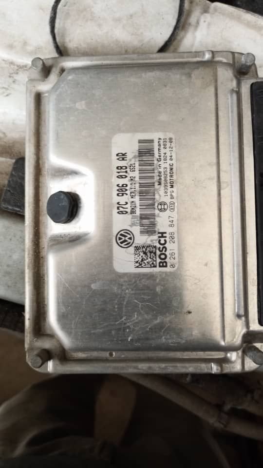

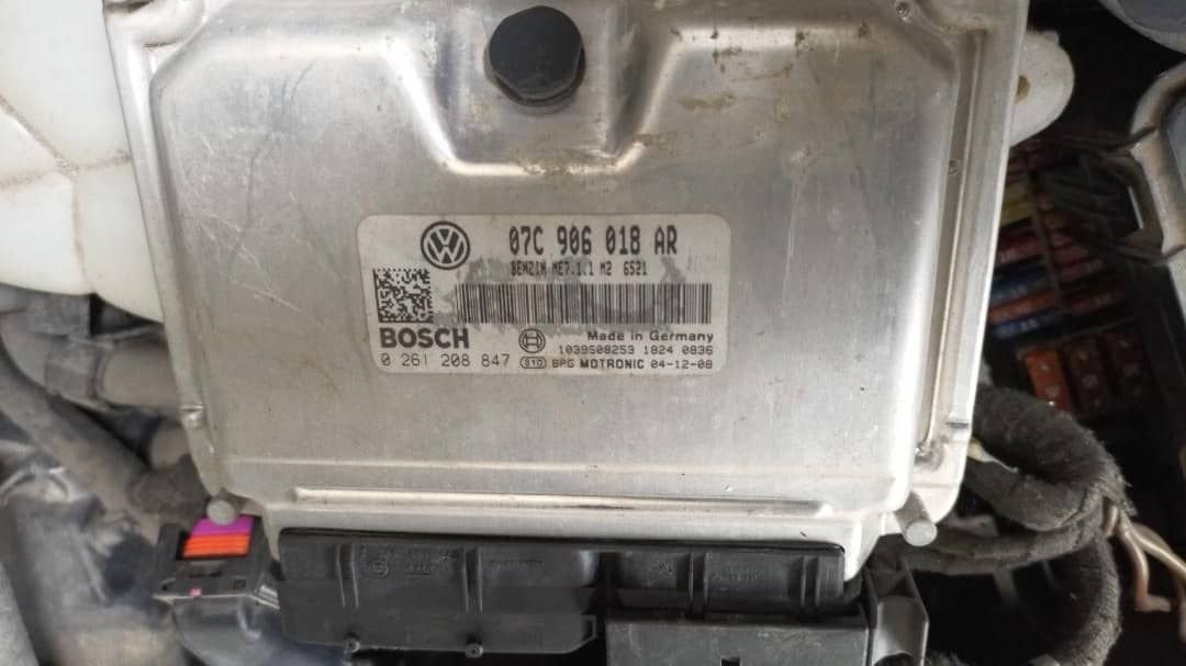

The ecu engine I reports misfires or 1, 5, 6, 3, 2, 4 cylinders. all these cylinders point to bank 1 of the engine. The bank 1 of engine cylinder 1 to 6 does not fire
This means that it is the full harness going to bank 1 (to open the fuel injector or / and pull the spark plug from the coil of these cylinders) that is probably causing the problem.
I went to the engine ECU compartment to check that the connectors were properly inserted after putting back the engine.
From my findings i conclude that the 2 engine control units are not connected as it should.
The control unit in the front has its big connector (on the driver side) labeled #2 and small connector labeled #1
while the control unit at the back has its big connector (on the driver side) labeled #1 and small connector labeled #2
additionally the 2 control units are just the same.
Control unit presently at the back
Control unit presently at the front
Then I submitted this question to Johnny Hotspur GT:
"which control unit do i put at the back as control unit #1 with its big and small #1 harness connected to it.
And as a matter of fact the same question for control unit in the front."
From his answer:
"Both ECU'S are the same, and being that nobody labeled them 1 and 2 when they removed them, I can not tell you now which is the master and which is the slave, and yes, as you said, 1 + 1 on one ecu, and 2 + 2 on the other ecu.
In the future, please have your men number the ecu's as 1 and 2 ."
after interchanging both ecus, BINGO! the car is now starting and running smoothly
idling is normal.
moreover engine ecu 1 and engine ecu 2 no longer report misfires.
