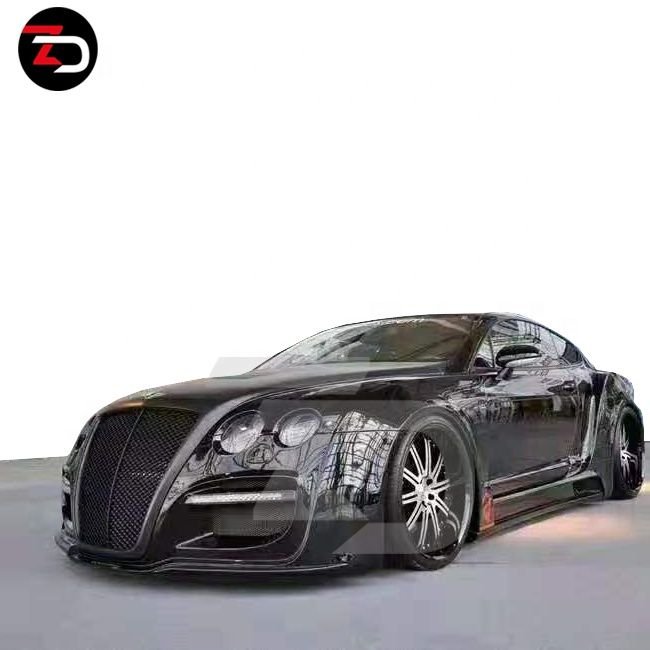

I was looking around Alibaba and found these body kits. Really like the grille but not a fan of the overall widebody kit.

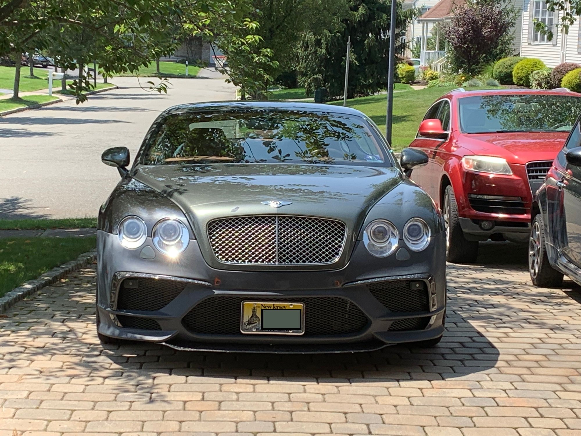

I have that exclusive bumper (at the shop for paint right now). The 5 parts that are supposed to be carbon fiber (if you look at the OEM car) come off and it looks pretty like something in between the speed and ss when removed. They bolt on and off and I'm leaning toward leaning them off.
Quality wise, per my body shop guy, pretty much all aftermarket bumpers suck, as they are made of stiff fiberglass or FRP and do not flex and avoid cracks like OEM bumpers, which can deform and be popped back into place. He's also a former BCGT owner, so knows the cars well and stated the Bentley OEM plastic bumpers, while better than aftermarket are also very stiff and prone to cracking with age. He's retiring from the business shortly and has opted to do the work himself as part of the reason he's getting out of the business is that lack of young individuals willing to learn the art or have the patience to do things right. Thankfully I don't have to leave the requisite note about jack mode and opening the hood, trunk,etc.
Not sure if there are any polyurethane aftermarket bumpers out there for our cars, but as far as material quality that's supposed to be the best per the body guys.
Aftermarket being what it is, they are OK quality, not great, not total junk. I had to elongate two slots, move two hole slightly and spent a lot of time sanding where they sprayed the fiberglass on too thick inside, not allowing the left side to engage the bumper clip properly. No voids, but a bit sloppy where the parking sensor holes are marked and I had to drill those. Finally, I had to supply and figure out how to install the grills.
(edit.... also had to spend a fair bit of time sanding/filing the recesses for the headlight washer jet covers to get them to be flush, like the oem, which are a bit more curved than the flatter aftermarket bumper. Also, about half of the $4k paint costs were for additional fitment adjustments for the bumper, but included several hours of labor to fix a ripple in the used fender I bought. If I had it to do again, I would have purchased the vented fenders from Bentley, for that bit, as it would have been more cost effective and new parts.)
The major effort was getting the sensor/wiring harness moved over and routed so there's no interference.
Here's a pre-paint pic, with the carbon fiber bits on. (I had mine covered in carbon flakes to give a forged carbon look).
pre paint 06 with exclusive and forged CF trim

Thanks Sam, that is exactly the info I was looking for. From what I can see fitment looks good. Maybe it is just the picture, but it looks a little off where the bottom of the grill frame meets the bumper. The grill frame is slightly different on the 08-11; I wonder if this bumper fits one better than the other (I need to replace mine anyway). The parking sensors always annoy me. If the wiring harness is an issue I might just delete them.
I think that bumper might look good on mine (white) with no CF trim and chrome grills. I am looking forward to seeing yours with paint.
Edit: Sam, just saw more pictures of your fitment in another thread. grill frame/bumper fitment looked fine, it must have just been how I was seeing this picture.

Yeah, I think the shadow from a nearby tree makes it look like the grill overhangs a bit, but it's actually OK.
