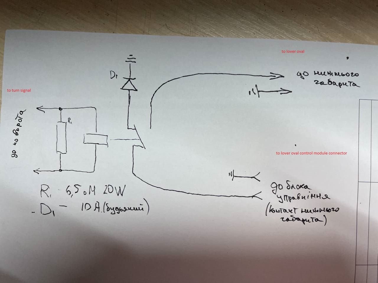

Yeah, I used it on purpose )) I'll post sheme a bit later!

Update, problem is that tail light contoll module is too clever.
Any changes - oscillator shows another signal, and we can expect errors.

I use resistor to emulate consuption of that small lamp in turn signal. Aim was to do "plug and play" device on original module nad original wire, so it could be restored to original in 1min. It is ppissible to solve problem changing sheme of light module, but, it is not what i want.

I thought about this. but then i need to damage wires, i wanted to keep them virgin.
But still, resostors radiate same amout of heat as a light bulb, so.....no difference. in a few days i'll recive my thermalvisor, and make test for 10 min and we will see temperature on resistors, and i ordered new one with copper coat

@Johnny Hotspur GT I found how to fix heat problem. But i need to do little change in controll module, so, if you have brocken units i can make it for you. Or if ill find wrecked units ill present you pair)

@Johnny Hotspur GT look at this emberesing dissapointing result. Yes, i understand that actual temp in this way is lower, couse resistors radiate infrared, but even if it is half lower, it is still not good. Becouse you can't stay on signals more then 5 mins. ****. But. I have method to fix it, and i will, but it need block modification, as i allready was told, so if i find, i''l send you prototypes )

This is final version. The only warning, not to keep alarm ot turn signal for longer then 10 minutes. and that all. So, if somebodyl wants it, tell me here plz.
