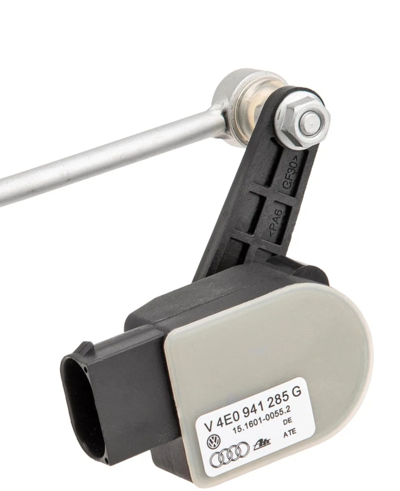

So Ive replaced the unit. My original was a Conti GT 2005 3W0035007G and the replacement was a used 3W0035007M also from a 2005 GT.
It powered right up, controls HVAC fine, says the key is synchronized on startup, etc and car fires up. However, my front is sagging all the way to the bottom now. I scanned the car and Im getting two errors in the Level Control System that weren't there before: 1. 00776 Left front Level Control Sensor Defective 2. 01769 Right front level control sensor Defective
Im pressed to think this is a coding error as these didnt exist prior to infotainment install. Can you advise if theres a software fix to attempt before throwing parts at it?
Thanks!

Hello @virtual_law ,
I have the same feeling about this issue just as I do to the N75 / fuse blowing issue.
So please give us some time lines for issues occurrence, as your N75 / fuse issue as I stated in the other thread, I believe to be tied to the mechanic replacing the alternator, just as I feel the front level sensors both left and right (00776 front left / G78, and 01769 front right / G289) now have issues because of the work performed at the front end of the vehicle, that being, the alternator, as I doubt for one second that the Infotainment head is the cause of these faults with your suspension, as if the head unit were the cause, then all four corners would show faults, not just the front where the mechanic was working, furthermore the actual faults for the level sensors are not shown, just the address of each sensor, being 00776 and 001769, so show us the actual 3 digit fault code as pictured below.
It's most likely that depending on how the mechanic changed the alternator, meaning, the front suspension/subframe being dropped, that the connections for each level sensor were not properly seated/connected, or somehow damaged.
Johnny

The level sensor connector's wiring does not go to any "ground spot" for ground, each level sensor has a 6 pin plug, which 3 pins are used on each, all 3 wires from each level sensor runs all the way to the 81 and 40 pin plugs on the suspension control module located behind the rear seat side panel.

Okay some welcome news. I managed to peer underneath the 0.5 inches of clearance in the front, and turns out the level sensor connecting rod has popped out on the front left, causing the car to completely slump on both front left and right. This also results as a "defective sensor" fault code on my end.
No idea how this happened as it seemed fine for a few days after alternator replacement.
But thankfully feels like an easy fix.
Question: Is it safe to put this car into jacking mode now and then jack it up? Cause I imagine the pump will try to fill up the front struts without success as its not getting any feedback from the sensors.
Forever thanks for the help!

@virtual_law ,
That's some good news hopefully.
Put it in jack mode, which it might already be, as I recall you said jack mode wouldn't go away even after driving, but either way, jack it up and reinstall the rod, BUT, I believe that you have lost the retaining insert on the rod, unless it is stuck to the mounting point, if gone, you will need new rod/rods.
