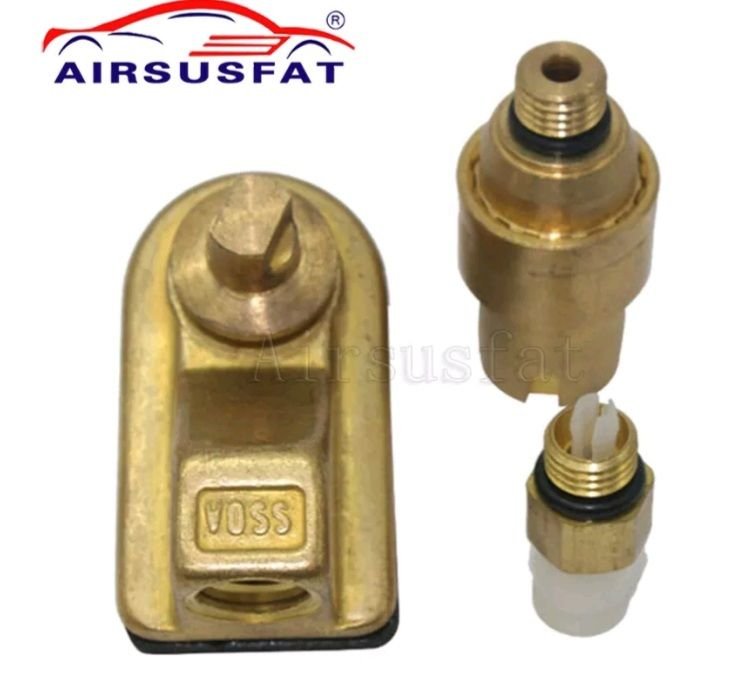

To add a little more to consider on testing the strut for leaks before throwing away a perfectly working strut, besides the leak of course, as if the bladder is not blown out, search for other failures.
If the strut is slowly leaking at the top under the hood, or the bottom of the accordion cover, then the upper and lower o-rings would be the first to check and change, this has been done over on AW by Louis and some others, there is also the possibility of the brass air inlet as shown in the attached pictures being the fault of air leakage.
I will find the video for the o-rings and post.
Please ignore the red circle.
Johnny
