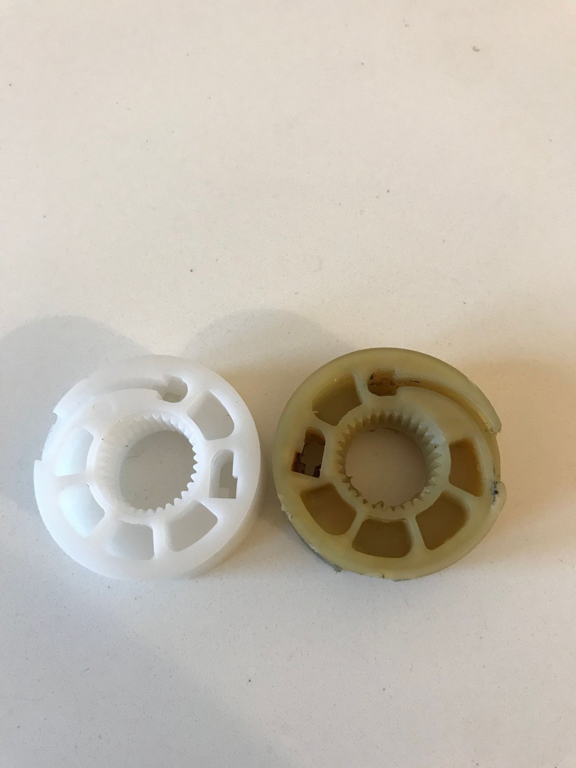

Hi, My 2004 gt has chewed up a window regulator wire and the plastic wheel/sprocket that attaches to the rear of motor. Is there a repair kit for our cars? Thanks in advance.

Thank you DarkGreen. I have one of these kits on its way hoping the wheel is the same. I never thought about having the cable remade as yet I always did for kit cars years ago. Thanks for the tip.

DONL your post link has spurred me into fixing it myself.
Dark green, I too realised that the vw kits are for the opposite side to a Bentley so have ordered the right hand side from a VW Polo that is identical to my left side at a cost of £1.99 delivered. The Phaeton repair kit was £12.50 delivered. If the long cable in the kit is long enough I will use it and crimp a ferrule or weld a ball on. I’m not sure why I didn’t go down the hotrod fix route in the first place seeing as I restore C2 Corvetttes. Will take some pics tomorrow. Many thanks.
