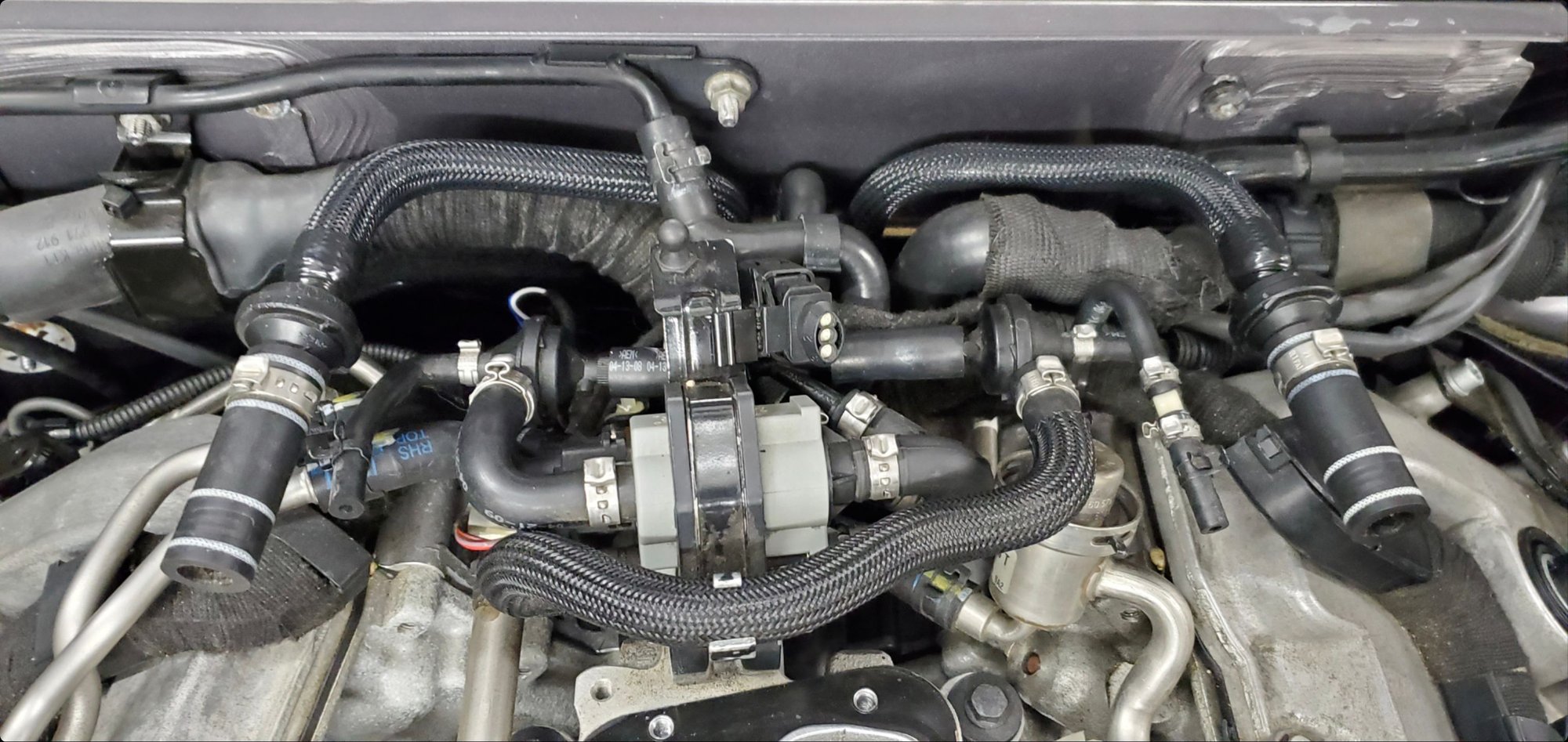

Hello,
Turns out that my small evap leak in my 2008 Flying Spur is being caused by a ruptured line connected to the rear of the intake manifold on the passenger side of the car (see attached photo of valve and braided line). Does anyone know that part number of this valve and line? Thanks for your help.

Hello All,
Today I spent several hours trying to remove the defective passenger side check valve and vacuum line that runs from the back of the intake manifold to the firewall. I removed both shields under the car and the passenger side wheel well. There was just no way that I can figure out to access the lower portion of this line while the engine is in place. If there is, it must still involve a huge amount of labor which may be beyond my skill set and is definitely beyond my patience. I can deal with spending money for legitimate maintenance items, but it would gall me to spend several thousand dollars in parts and labor to replace some plastic crap pipes that Bentley was too cheap to engineer from metal for an extra $10.00 It might be time to cut my losses and buy a new ride. The shame of it is that I truly love driving this car, but life is too short for this aggravation. It seems that many of the people on this forum have vastly more mechanical expertise than I do. I'm merely an educated amateur with a lot of basic tools. Kudos to those of you have the ability or deep pockets to rectify Bentley's engineering shortfalls.

Hello @Burt ,
Sorry to hear of your issue.
May I ask if instead of trying to replace either or the two large plastic lines, did you first try to seal up the end of the line at the check valve at the intake manifold, as the lines rarely fail anywhere in the middle, just the ends, you can see the lines and their layout in my video, of course I pulled my engine out during my GT rebuild, so easily accessible, others have pulled the steering rack to access and repair/replace lines, but those lines are usually the smaller lines, I do recall someone going in with a sealant on a stick to smear around the large lines, as they are vacuum/suction, so no pressure to blow sealant out, kind of a crude repair, but if it saved a $4800 engine out bill, some would do it.
But I would first check for cracks at the top and use some high temperature tape around the line at the check valve, then slide the braided sleeve up and tape that also, see my picture.
Johnny

Dear Mr. Hotspur,
Unfortunately for me, my vacuum line was not split on top of the engine where I could reach it, or anywhere else along the line that I could reach. The split must be at the lower end which I cannot access.

I did the smoke test as per the Jason Gianetti video in the main line by the driver's side wheel well. I did not remove the pan where the charcoal cannister is. A mechanic diagnosed the leak with a stethoscope

Can I delete and loop this system
Johnny Hotspur GT hi my question is
I have found the leak when I remove the two big pipes off my intake manifold and cover all holes my leak stops . So my question is can I just block / delete this system ? I understand my brake assist is linked into this . So if I join that with a one way vales to my intake manifold and block everything else . Will this temporarily fix my small leak down on the bulkhead .
