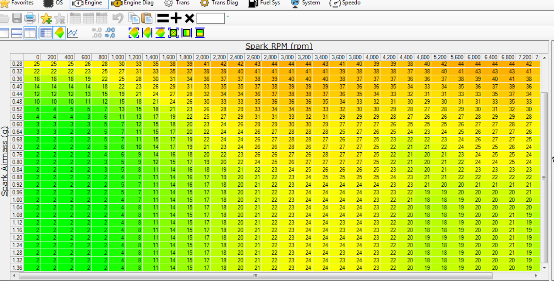

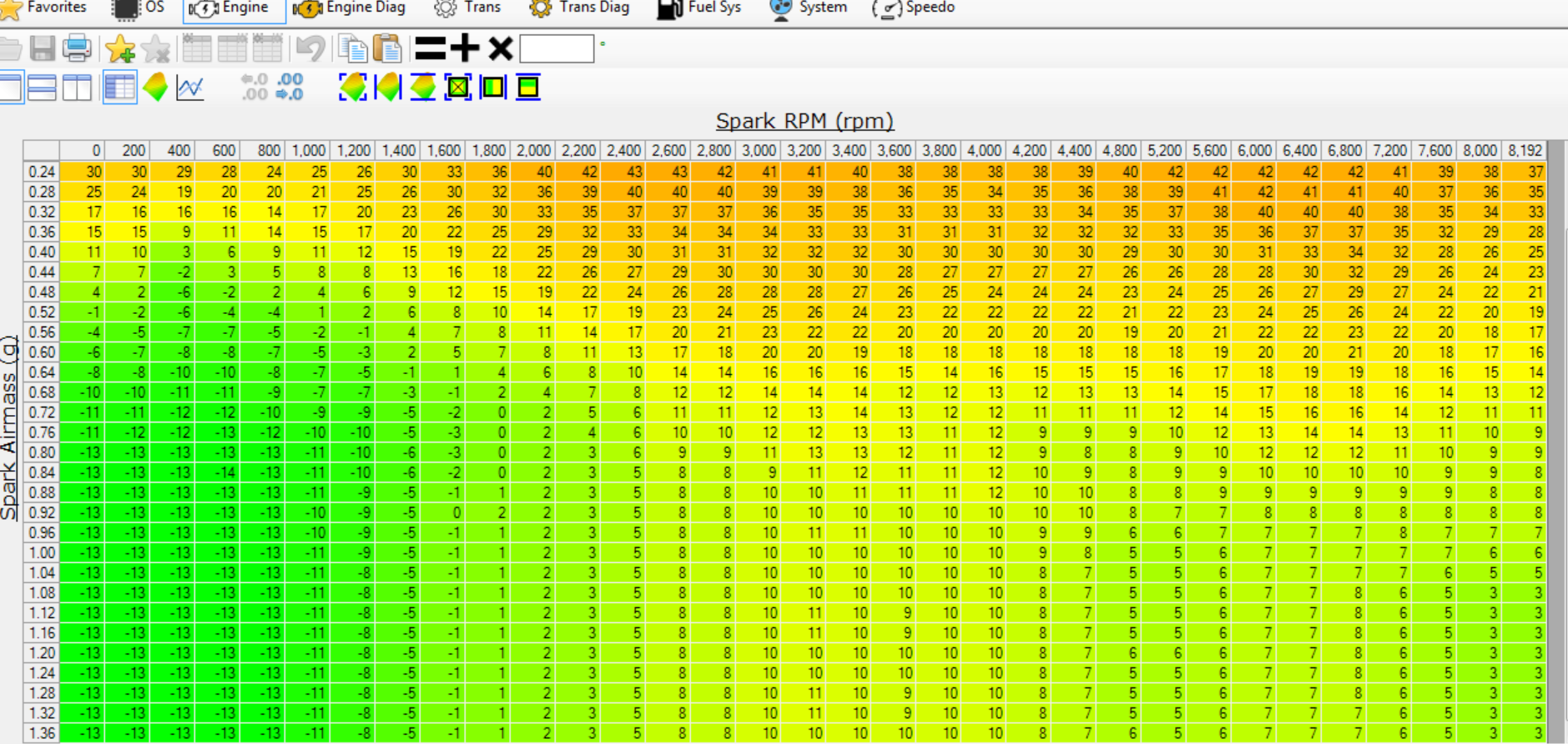

Just for graphics sake, here are two tables as a reference only. The first is a high octane timing table, the second low octane. In the case I describe above, the high octane table values would be copy pasted to the low octane table, then the original high octane table would be completely rewritten to accommodate E85, but again, this takes an aware owner.
