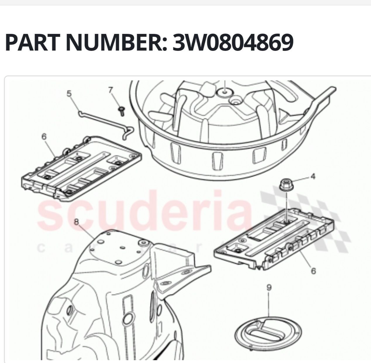

Johnny - I need your help. I'm replacing the smaller, passenger (right) side battery. The original VARTA battery is 8" wide and the battery replacement on every site I'm seeing shows an H5 (group 47) which is 9-1/2" wide. the problem is the battery tray has a 'hold down' that is designed for an 8" wide battery. There isn't an option for a larger size. Have you heard of this issue before? I picked the new battery up at the VW dealership this morning and it has the VW and Audi logos -- I was told this is the right battery for the car and it is made by Interstate. Help?

I just saw your post, give me a few minutes, as your right side battery tray has me confused, and I only repeated what you said as to the H5 group size, my 1st Gen GT has the same battery tray for both sides of my vehicle, which is part # 3W0 804 869, and each tray has two positions of of hold down, so either side could fit a H5 or H8, so if I wanted to, I could use a H8 as my starter battery.
Johnny

I think the issue is that your 2014 GT V8 has a group H4 battery as the starter battery, and the correct part number for the H4 is 000 915 105 DC, not DE, as DE shows as an H5 by it's measurements, and the battery tray that you pictured is a 3W0 894 869 A, so a smaller tray, it's odd the difference in trays, maybe to do with yours being a V8, because the larger tray shows as being used from 2004-2018..
Johnny

Thank you so very much for your detailed response. Can I ask (unless I missed it) if you have the part # for the 'larger tray'? I would prefer to use the H5 battery if possible. Again, thank you very much for helping me here. I've never had such a frustrating time with a simply battery. I have the Bosch part # that would work -- it's an S4 002, but can't find it in the U.S... and I understand that Exide makes the batteries for Bosch.
Mark

Yes I believe you missed it 😀, it is 3W0 804 869, I did make two posts back to back, so make sure you see both, I would also check the availability of room on your right side, just incase your model has less room for a larger battery for some reason.
Can you tell us the part number off of the original Varta battery, so I can check sizing.
Johnny

Sorry! I wasn't paying attention -- you *DID* send the part number for the larger tray. Looking into that right now!
Mark

Again, thank you! I ended up ordering a battery from a company in the EU. Should get here (Georgia) in the next week or so. I'm shocked that I'm the first person to run into this...
Mark
