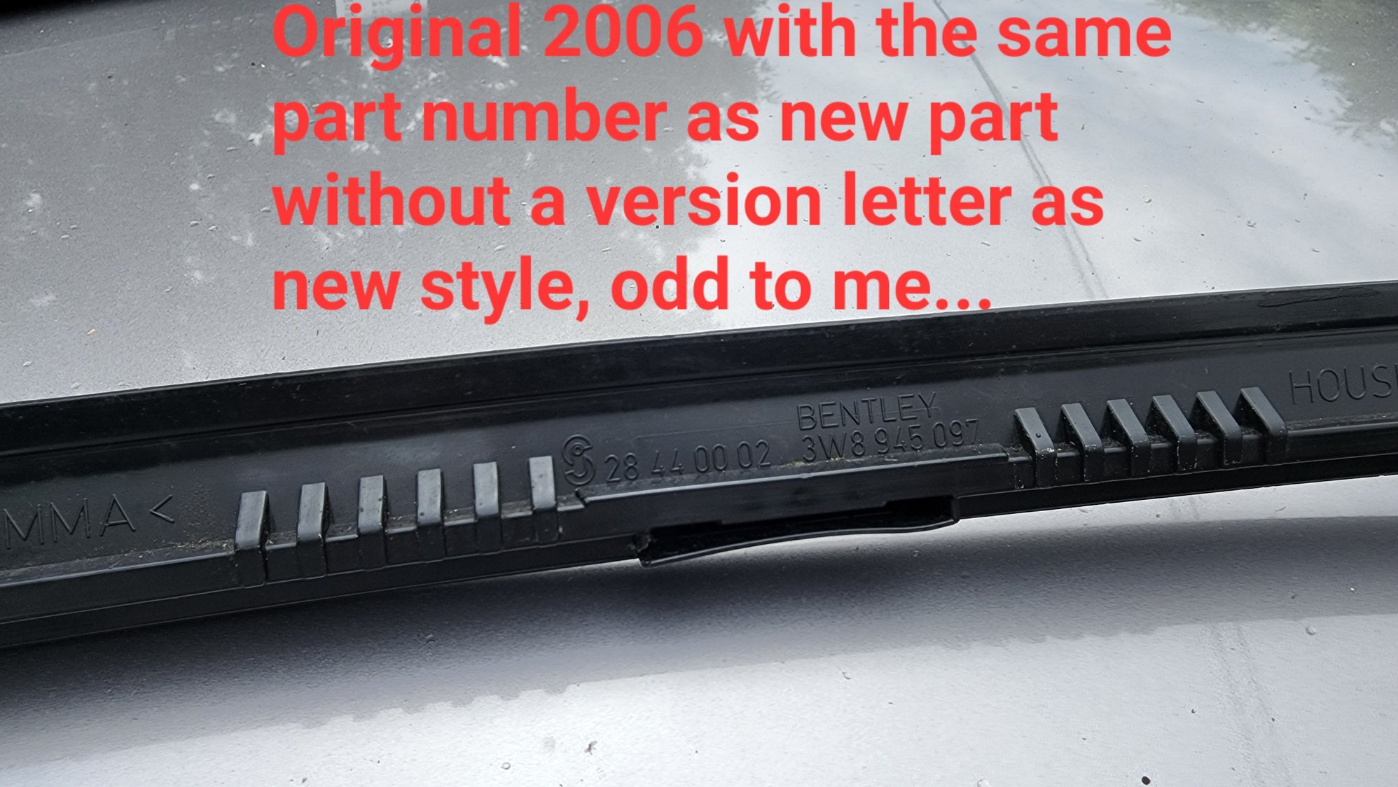

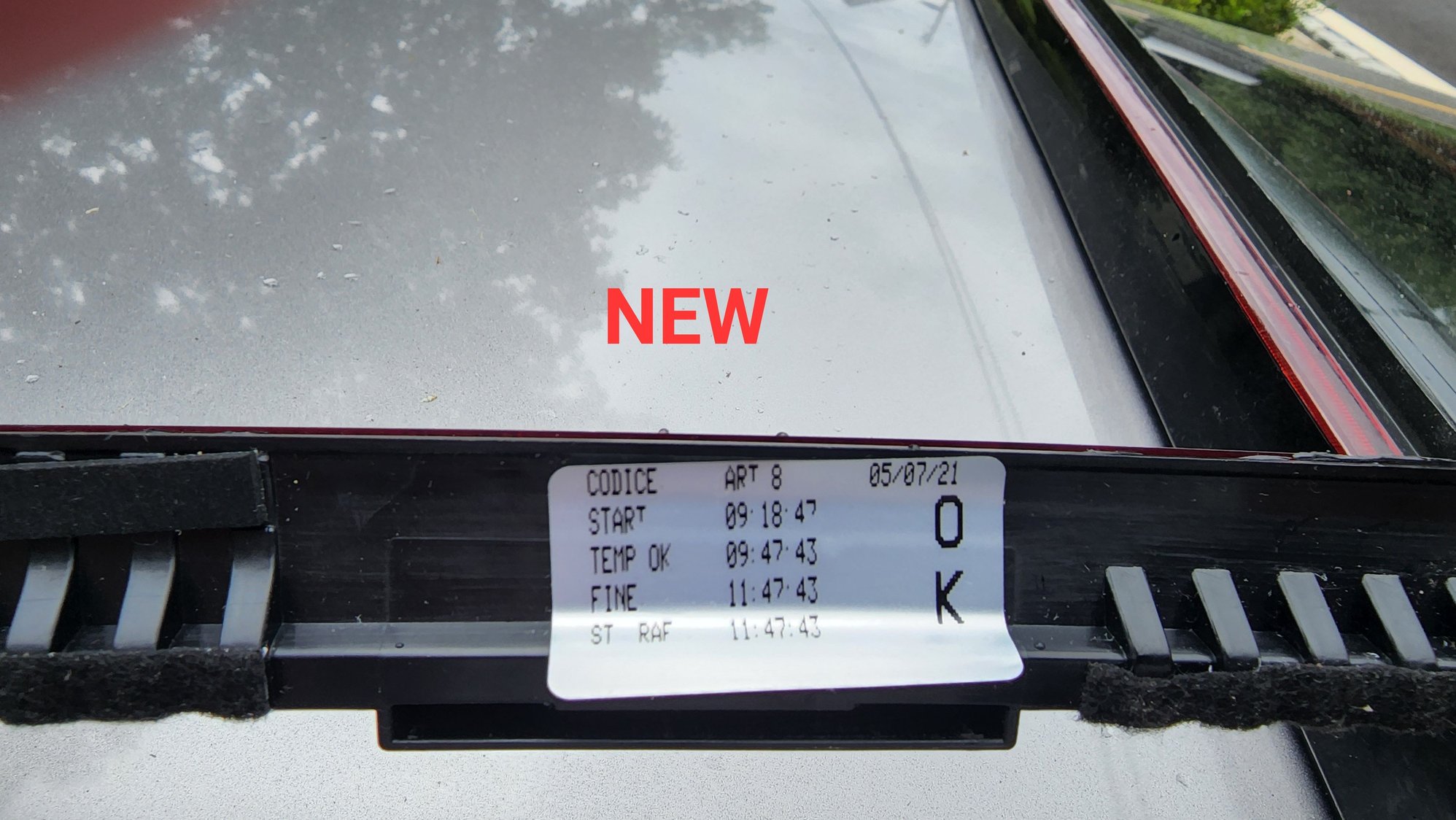

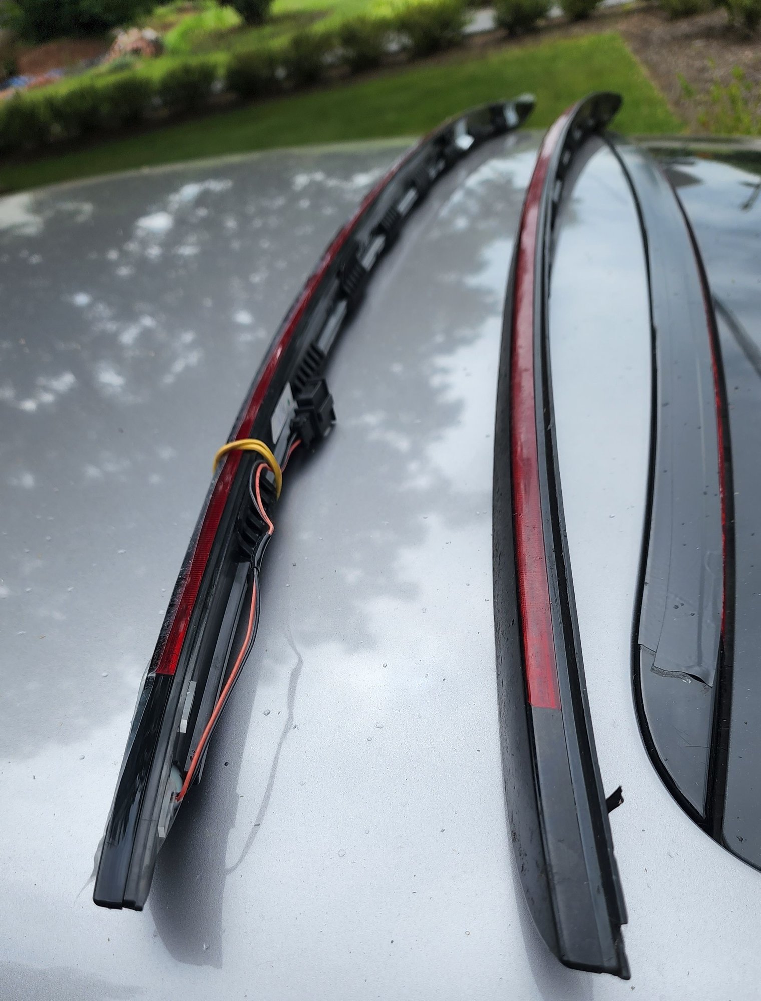

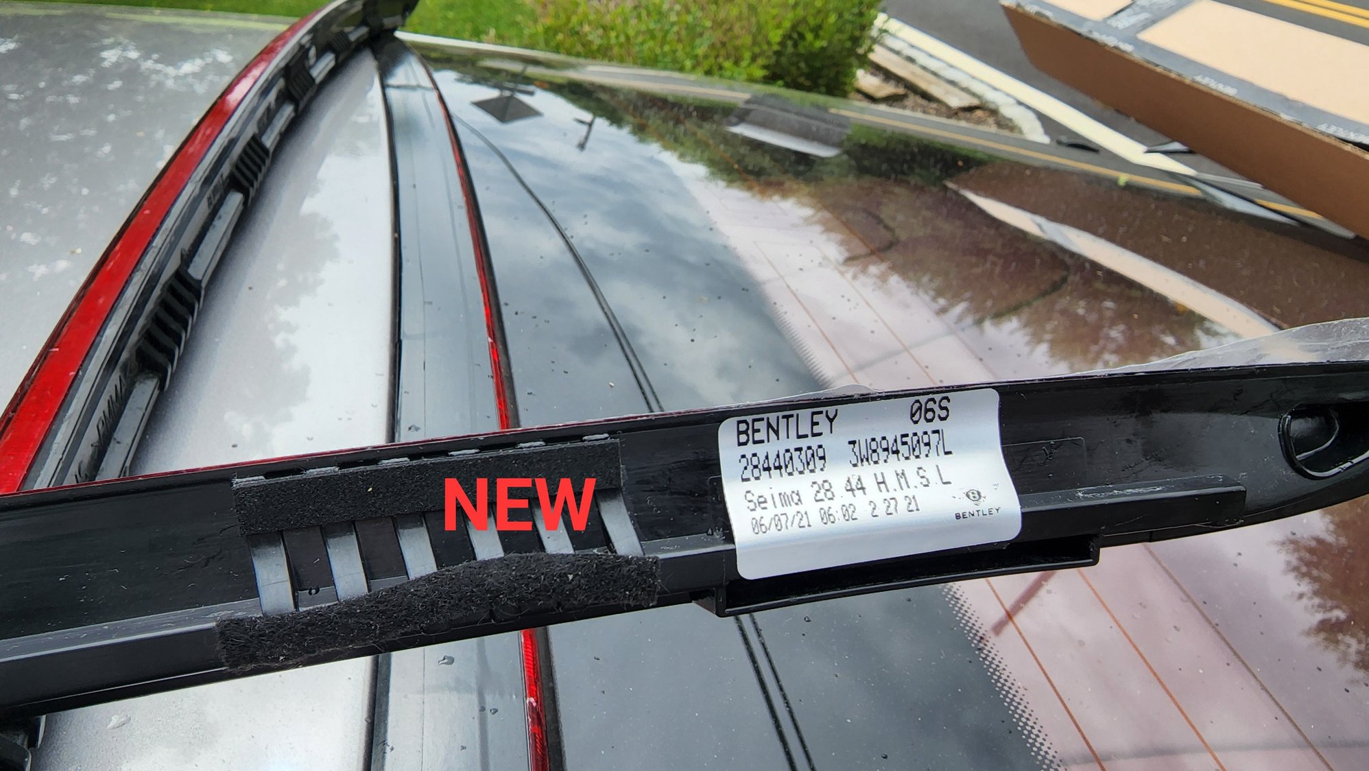

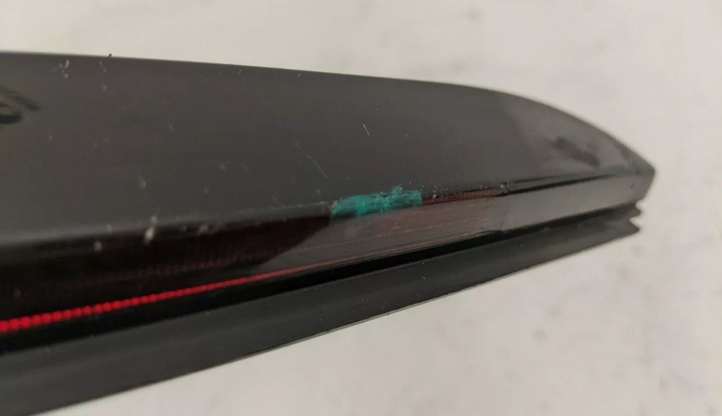

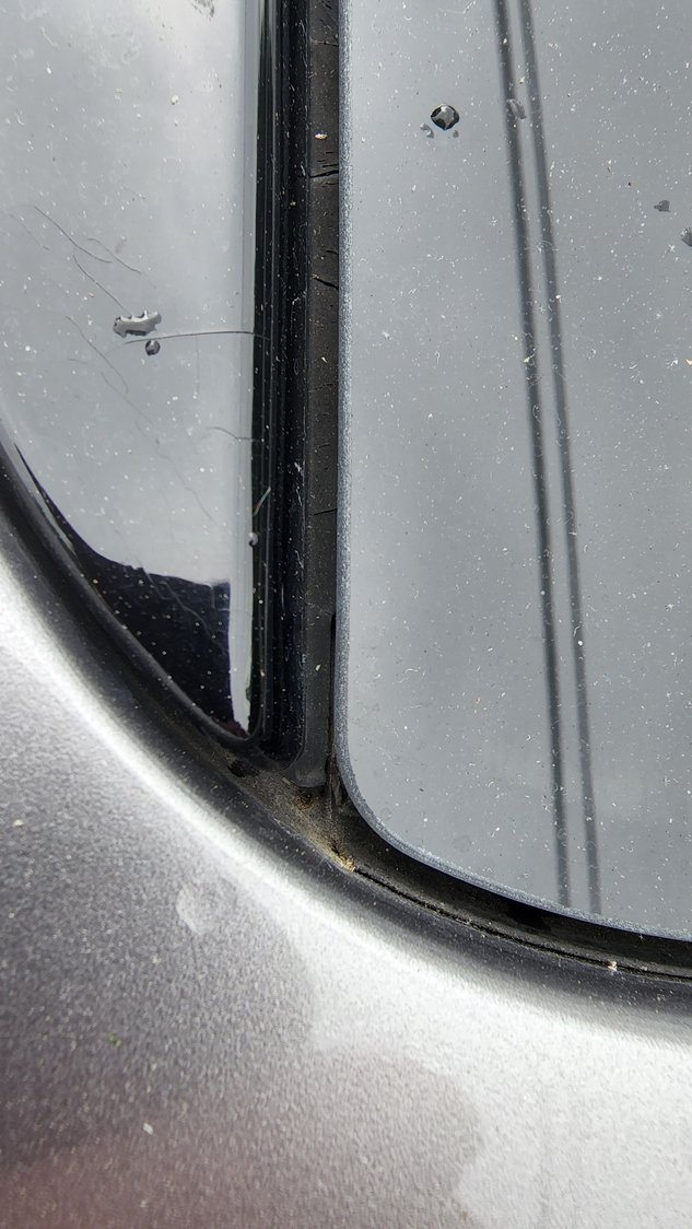

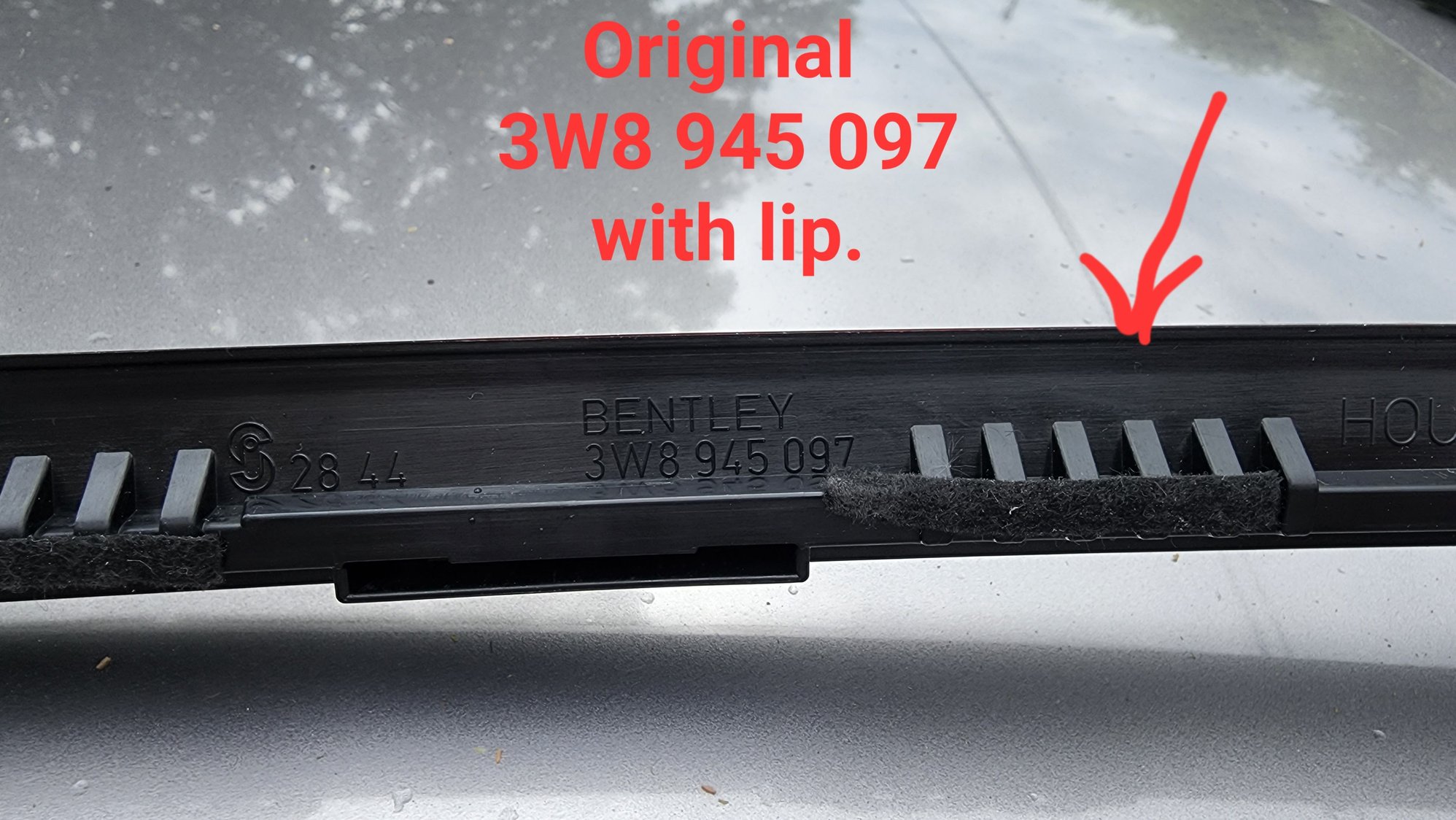

I ask this because I want to be sure 100% that the third brake light you removed, is infact the original 2006 factory installed light, as you made a comment of using two plastic tools, the one on the roof side I can see, but the tool being used on the glass side needs a little clearing up, as the factory installed light has a lip, and said lip does not appear to allow any room for a tool to get under said lip, as the lip is said to be under the glass, the new replacement light of the same part number for the 05 and 06 I have, has no lip, but my 05 and 06 lights do, so before anyone else or myself attempt removal of this light following your procedure, please confirm that your light was/is a original factory installed light from 2006 with the lip, also you mentioned pulling the wires out some and cutting them, the factory original light does not have wires like the replacement light, it has a flat ribbon cable, so I am almost certain that you a have replacement unit there, not the factory installed original.
Please confirm.
Edit: as to not cause any confusion, in one of my pictures and also stated above, I say that both the lip and non lip lights have the same part number, they do, as shown molded into the body of each light, although the new unit has a sticker depicting the "L" revision letter, as does the box it came in, I was just confused as to the same part numbers on each, yet having no lip...
See my pictures below.
Thank you.
Johnny

Mine did NOT have that lip, so either mine was a replacement or maybe a mid year? (mine is a late 06).
That lip would certainly have made removing it from the glass side more difficult.

@Copperline ,
Thank you so much for your quick response and clearing up the lip issue, you may want to edit your post with a warning, as your light was/is a replacement light without the lip.
The lip has nothing to do with mid year, as even the 08 and 09's have the lip.
So, I will have to follow the procedure done by @Zaos .
Thank you again !
