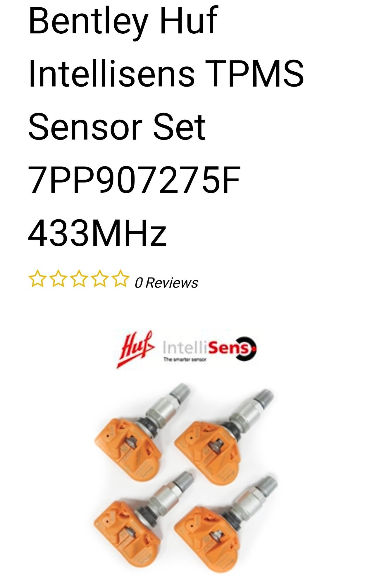

As far as the price of the sensors, they cost $170.00 (×4 =$680) at the dealership, programming should be a one hour rate, or a courtesy NC, $400.00 to program them is outrageously absurd to say the least, and now as I write this I realize that you did not mention any labor costs for installation of said battery... so please clarify.
I myself like Sam08861 have recently purchased the set of 4 TPMS sensors from TPMS.com, each for my Bentley, my Audi A8L W12, and my neighbors Mercedes S63, with the total cost for the Bentley GT being $140.00, the sensors from TPMS.com come pre-programmed, I just installed, and drove, eventually all displayed, although that S63 took a few rt 78 trips to register 😀 👍🏻.
For anyone reading this, for the 2005 GT, you must pick the correct sensors, as 05 is a split year for design.
"2005 Bentley Continental GT, GTC TPMS (June/2005 build date & newer)
2005 Bentley Continental GT, GTC TPMS (May/2005 build date & older) "
2006 GT sensors.
https://www.tpms.com/Bentley-Huf-Intellisens-TPMS-Sensor-Set-7PP907275F-p/uvc0811vagset-bentley.htm
Johnny

To install these replacements you need to have a tire shop do it? They don't just screw into the current valve stem?
Old Sep 12, 2021 | 06:11 PM
Johnny Hotspur GT's Avatar
Administrator
Joined: Jul 2014
Posts: 3,963
From: Montgomery NJ
Rep Power: 1002
Johnny Hotspur GT Is a GOD !Johnny Hotspur GT Is a GOD !Johnny Hotspur GT Is a GOD !Johnny Hotspur GT Is a GOD !Johnny Hotspur GT Is a GOD !Johnny Hotspur GT Is a GOD !Johnny Hotspur GT Is a GOD !Johnny Hotspur GT Is a GOD !Johnny Hotspur GT Is a GOD !Johnny Hotspur GT Is a GOD !Johnny Hotspur GT Is a GOD !
Hello ​​​​​​@DR3ADKN0T ,
Yes, the wheels must be removed from the vehicle and placed on the tire machine, one does not have the totally dismount the tire from the wheel, but must brake the bead on the outer side of the wheel to access the sensor for replacement.
The sensors look like this.
Johnny
