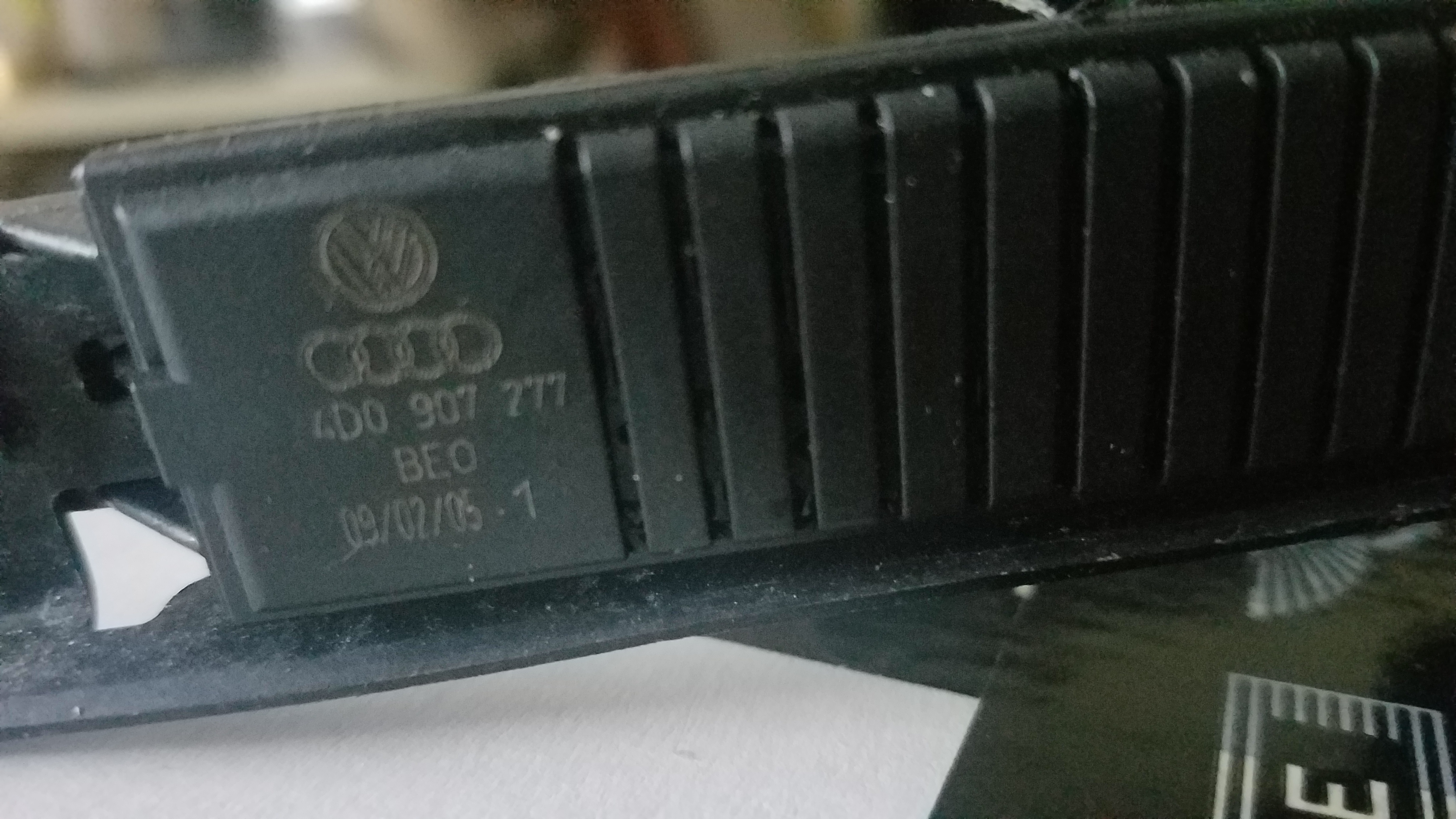

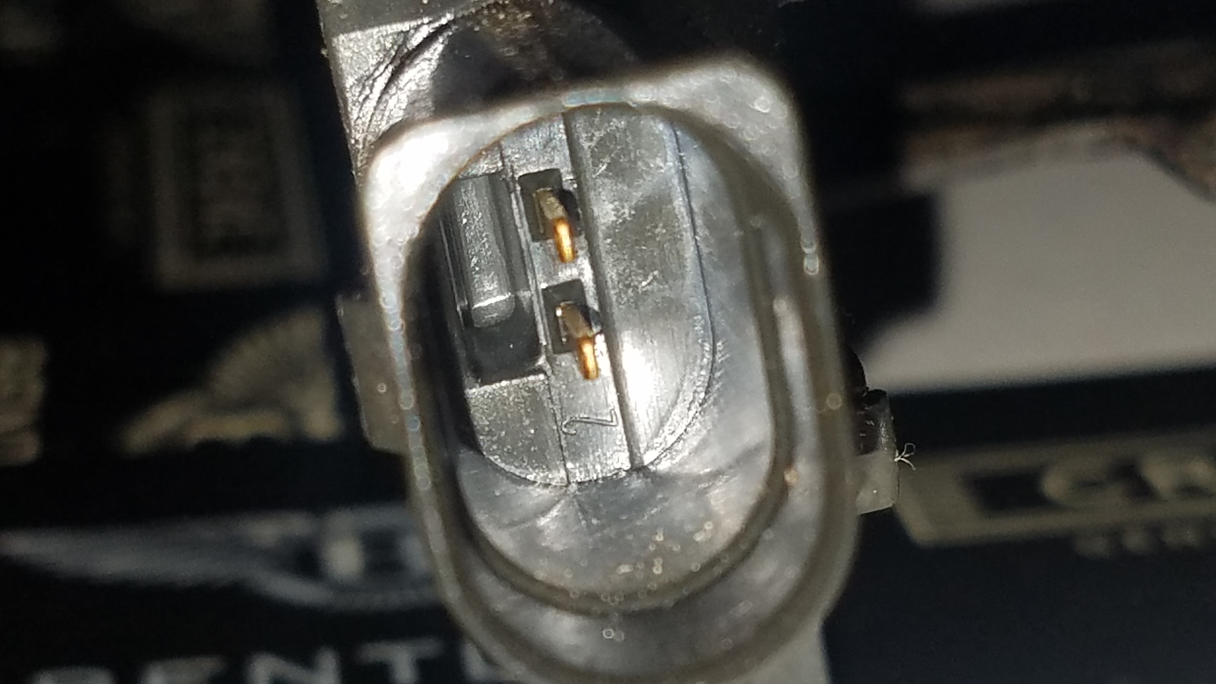

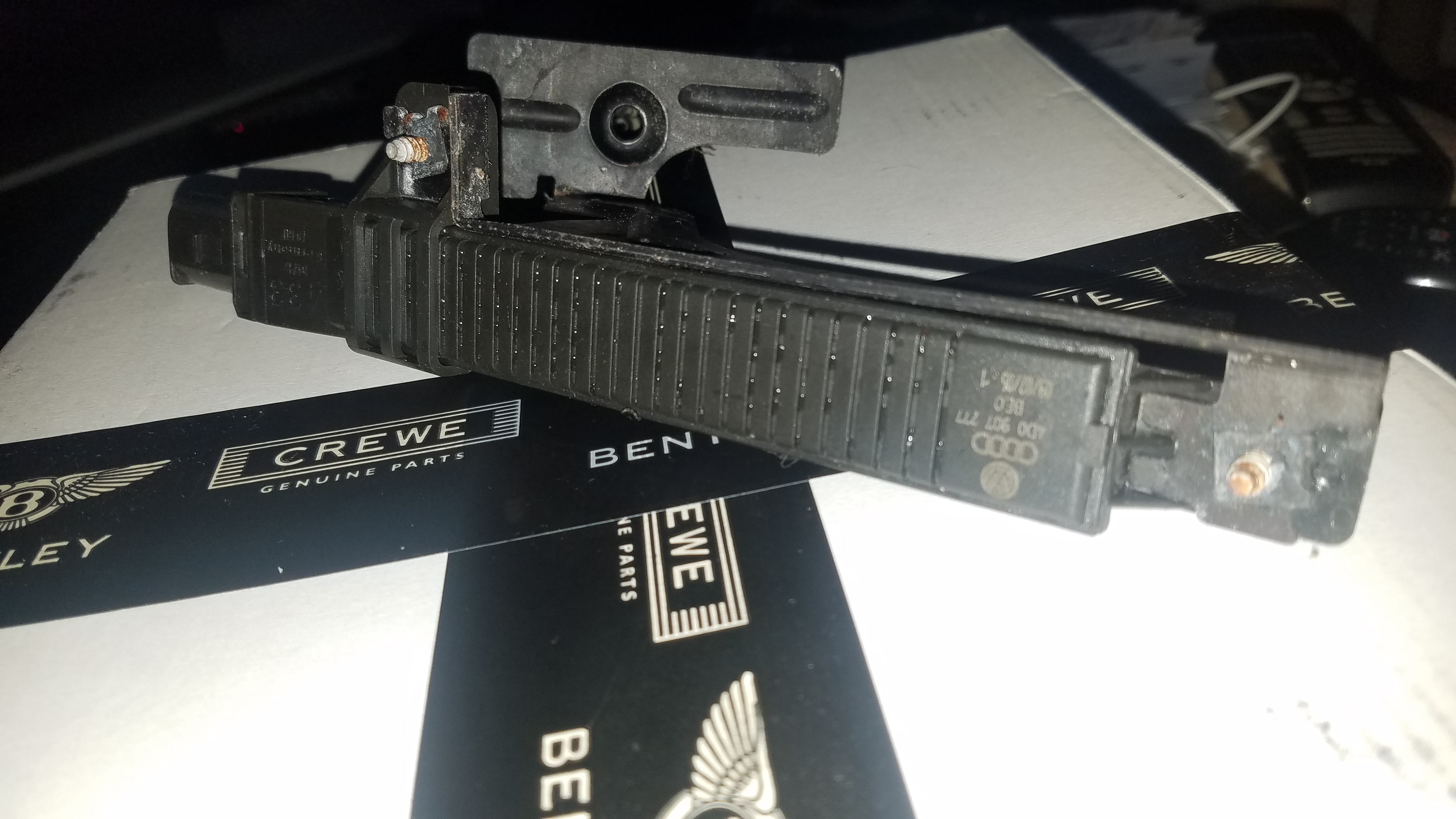

As Sam has pointed out the part # for the TPMS antennas, please be aware and double check which style antennas your 06 FS has, as while working on my GT re-build (still in progress) I found that my 2005 GT had the style and part numbers Sam listed, long 2 wire antennas as Sam's illustration shows, BUT, both the 2006 an 2007 parts vehicles had the newer style for their years, each is a square with different mounting points, and they now use a 4 wire connection, So I would pop that wheel well liner and look to see which style you have before ordering, also I do have both styles available, and will list them here in the market place if you need one.
ID:	514354   Click image for larger version
ID:	514355   Click image for larger version
